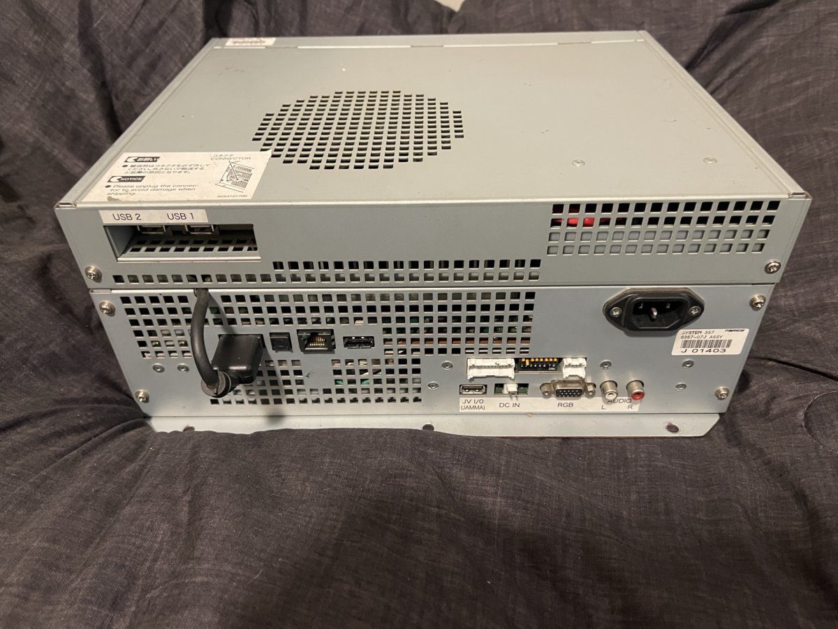

Hi all! I recently got my hands on a Namco system 357 A motherboard. It came with no dongle and no hard drive but it was listed as having the YLOD issue that retail fat ps3s have. I got it in the mail today but it has already been tampered with unfortunately. Seems like someone already tried to repair it, the Nec/Tokin Caps were replaced and new thermal paste was applied. Just in case, I decided to reflow the CPU/GPU but I still get the 3 beeps. I have a few questions, will the system still boot without a hard drive installed? Can I replace the motherboard with a retail motherboard? Does anyone have a spare board for sale or does anyone know how to fix these?

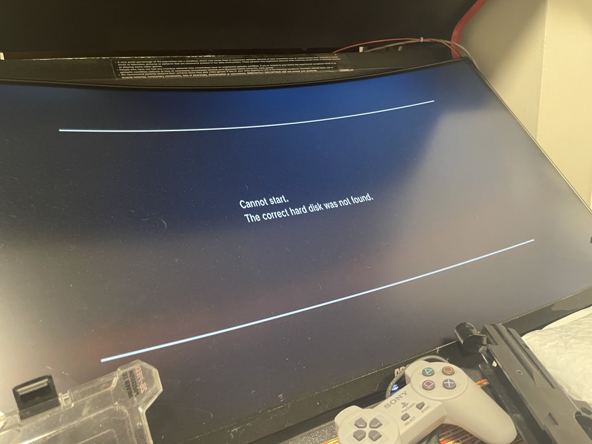

it will still boot boot it will give an error because its the wrong or no HDD
Just like a regular PlayStation 3 when there’s no HDD installed. It would be interesting to see if a retail motherboard will accept the arcade hardware drive and dongle. I highly doubt it though as it may want to format it to a PlayStation 3 drive and possibly has different code. I bought new caps to replace the old ones.
Edit: I put in a PlayStation 3 HDD and it gives an error code, nothing special.

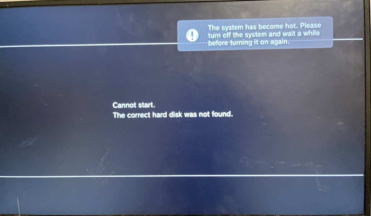

Well, I replaced another set of the Nec caps and just in case, reflowed the CPU and GPU again. Now it boots. However it gives me the warning that the system gets too hot and shuts off. I’m not sure what to do now. Help?

Does all fans working? Maybe your heatsink is not been seated hard down
All the fans are working perfectly fine. At least I get something. I might have to delid both the CPU and GPU to clean and re-apply the thermal glue on them perhaps. I might have to send it to a professional though as I have no idea how to do any of that stuff. I have never serviced a PlayStation 3 before. 🤷‍♂️
The overheating error I get

Retail PS3s display that same warning about overheating once the problem has occurred. You could fix the issue (ex: reflow, new thermal under/over GPU or CPU lid, new thermal pads, clean fans) and it’ll still say something about it. If you’ve taken all of the steps In parenthesis I wouldn’t worry about the error message too much.

Ok, so I went ahead and re-clamped the heat sink again and now it seems to be working perfectly fine. Had it running for 10 minutes and it hasn’t shutdown or shown the error message. All I need now is the Tekken 6 hard drive and dongle. Any one has one or can make me one?
