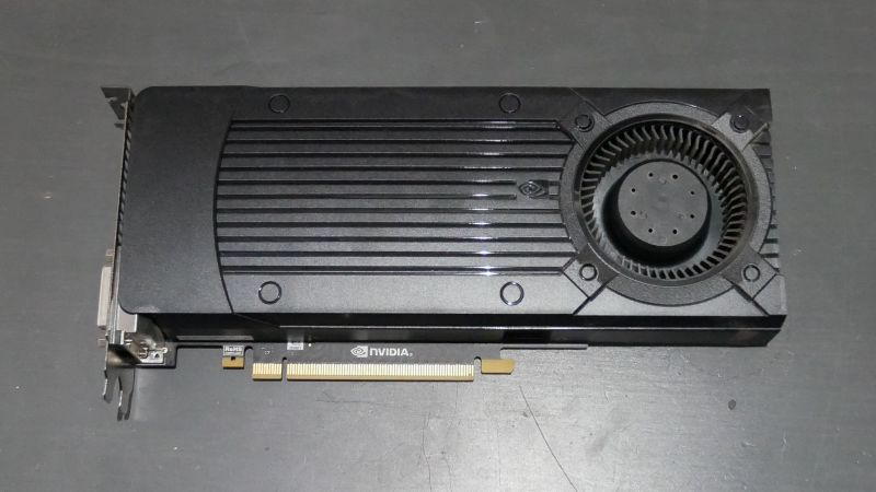

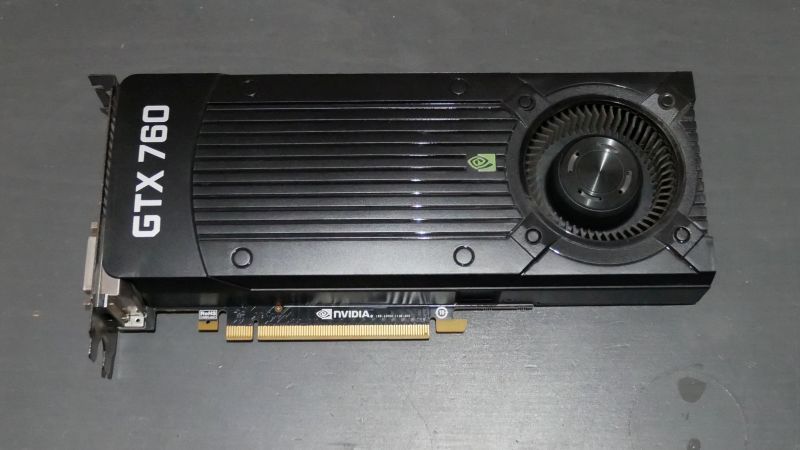

Both of my cards look like this.
Well, that’s very strange that one has a different bios from the other, I got four units and two of them have the all black version and the other have that version (green text) and I was able to switch them out without any issues (green text to green text). You did say one of them (the broken one) is an MSI version? Or are both of them the same version in the picture above? Not sure if you have a PC (like @Rom1 also stated, you can also use the ES3 itself and install windows 10) and GPU-Z to check the bios version on that card
You may have 2 original ES3 and still trigger bitlocker. This is because ES3 are shipped with at least 2 different gfx card. Most of the time you'll get the "full black" but sometime you'll get one with "green marking'. I encountered a third one but I suspect it comes from a repair services.
Whn you switch between 2 exact same model ans bioses, this should be ok for bitlocker.

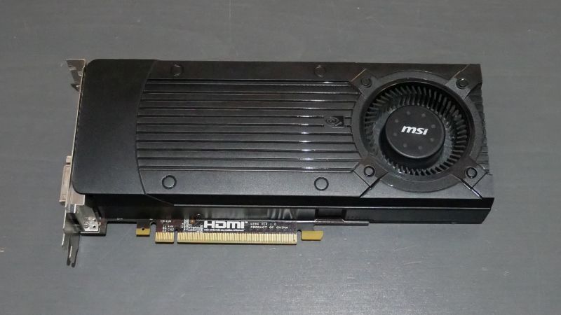

You guys were right, I was wrong. The other OEM card was indeed different. I'm an idiot. I have a green logo / white text card and a completely black one.
I tried flashing another generic MSI card (the first one was a dud) and couldn't get that one to boot either. I guess it's incompatible? A bit surprised by this, because it does look exactly the same as the OEM cards.
I attached bioses from both OEM cards, so you don't have to look for them elsewhere. I downloaded nvflash_5.163.zip from here and put that on a FreeDOS booting USB stick.
  • tekken_7_gpu_bioses.zip
Here's the pic of the MSI card I tried flashing. It shows a corrupt Windows boot sequence then black screens.
As I said, the full black and all the one with green marking (can be either a big GTX 760 or a ring on the fan) have different bios. Changing one for another will trigger bitlocker.
About the MSI card, putting an ES3 bios in it (either from black or green) will pass the bitlocker but may fail to work correctly. Only very first generation of card can accept it.
As your original card have green marking, you should try green bios. But not the one from your zip file (note: is it tolerated to share this file ?): they green one is wrong.
Simply dump the bios from your original card and then try it in your MSI.
What do you mean?
The green bios is from the OEM card that just boots to a black screen. It does nothing. I lifted the bios chip and read it with my programmer. Is the BIOS corrupt?
Your bios CRC doesn't match the one I have from working green cards.
Oh right, that's because it's the full dump from the chip (with padding), and not the cut down one that NVFLASH spits out. Let me fix it.
EDIT: zip updated. Thanks

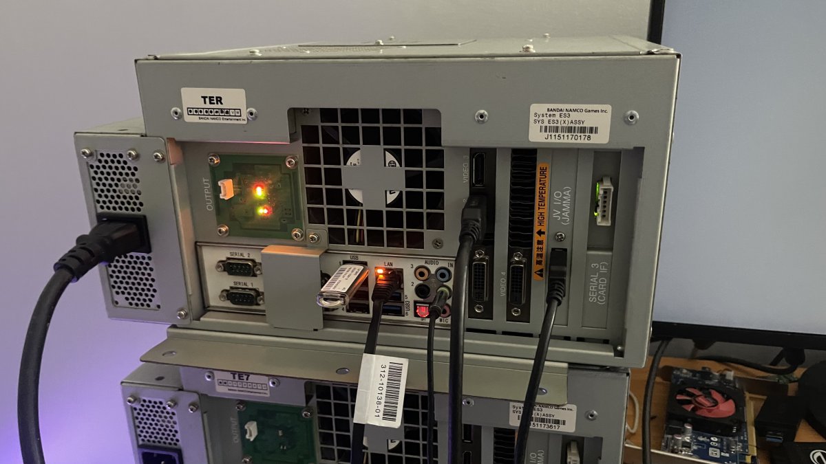

Some more ES3 findings I would like to share with you all.
First off, some weird issue with the TER ES3 unit. Looks like one of the blue RAM slots is indeed faulty which is unfortunate but here’s the interesting part, I can move that stick of ram to one of the black slots and the encrypted drive still works.
Now here’s something interesting which I thought wasn’t even possible. You can upgrade the RAM and the encrypted drive/TPM won’t trip Bitlocker! I was able to upgrade one of my units to 16GB dual channel DDR3 RAM and the drive booted.
Did I see any performance differences/improvements? Not really, loading was a bit better though but that’s pretty much it. These systems are definitely not like the Taito Tyoe X units and they can be upgraded to 32GB of RAM which is the max supported by the motherboard. I’m pretty sure the CPU can also be upgraded but I’m yet to try this and of course the GPU is upgradable only if the drive is either decrypted or you use your own custom software. :)
