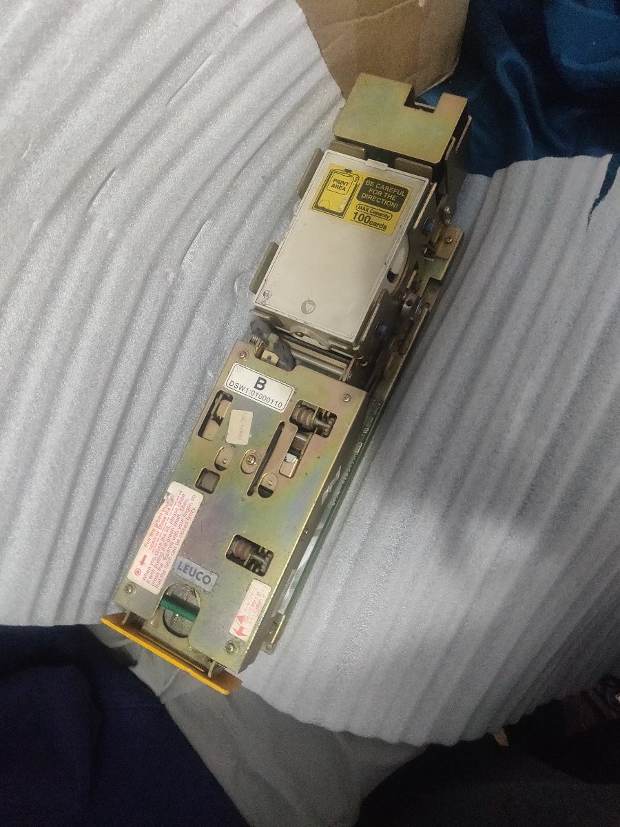

Finally got the right card reader.
you should be able to get it up and running with dupont wires - at least just to test it... and remember that you will need to supply it 5v, so what I did was run an extension cord (split off of the AC coming into the cabinet) over into the coinbox area so I could plug in a 5V power supply and run the wires up to it. the 24v and ground should already be there (but you will have to adapt) and the serial connector as well - different, so you will have to adapt.
