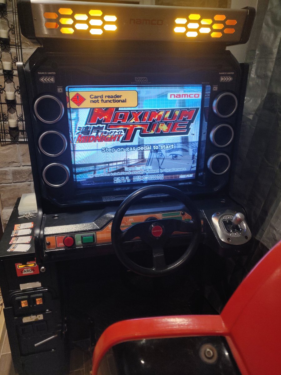

I do have some good news to share atleast. Looks like I'm back in the N2 club for now. I finally got the replacement N2 from arcade spare parts and worked on the first try.

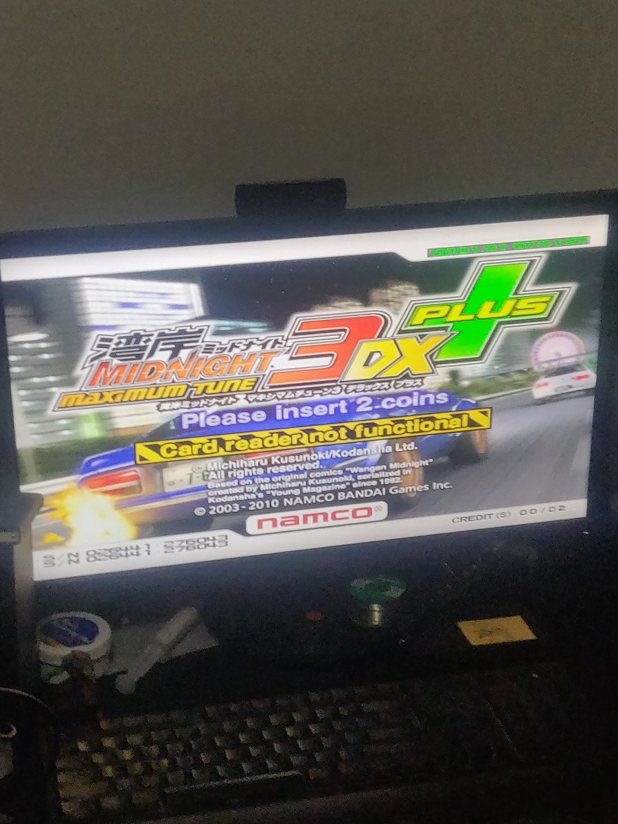

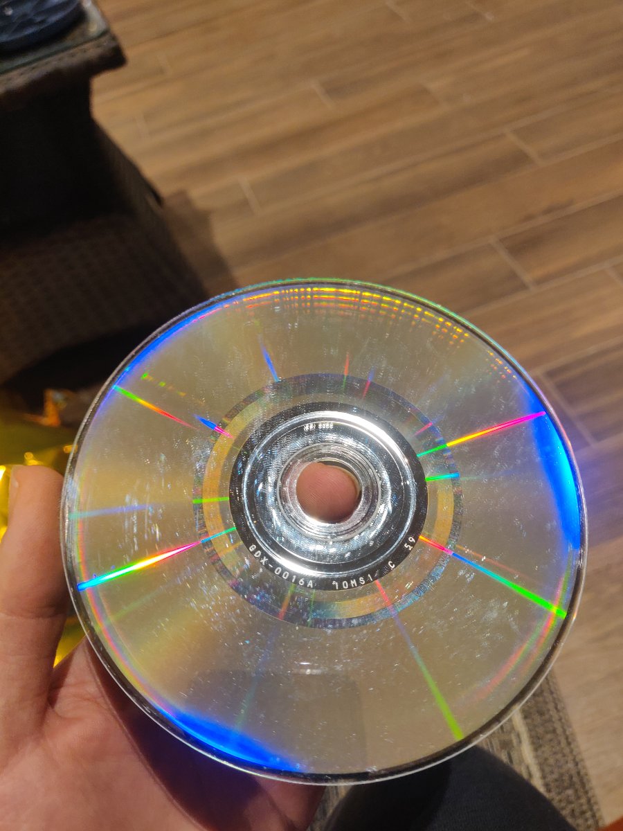

You guys are so right, GDrom ain't it. Often takes me 2 tries just for the Chihiro to recognize my GDrom drive. Glad to atleast have tried it once though. Also I definitely gotta replace the battery in this thing. The clock battery on the bottom board is the one that needs to get switched out right?
But yeah there's Maxi 1 running fine, I could try wiping down Maxi 2's disc maybe? Looks a bit dirty.
I'm taking a good look at it now and it doesn't look dirty it looks Over lol. Kinda shocked it got past the game test screen.
Yes.
You would need to change it if you load a game, set the options, turn off, and then load then SAME game and the options aren't set anymore.
If you switch games, you normally have to reset options.
You can tell they designed these systems with the intention the games won't be switched out.

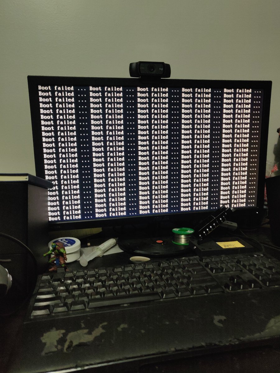

So I'm feeling really dumb right now, decided to try out my Old HDD on the new N2 and it's coming up as Boot failed... In other words I guess this HDD really did die out of nowhere, and seems like I busted that other motherboard for nothing 😅
These boot sequence means it has no HDD and dongle plus the pic pcb and the small pcb in the case is unplug , motherboard is Good

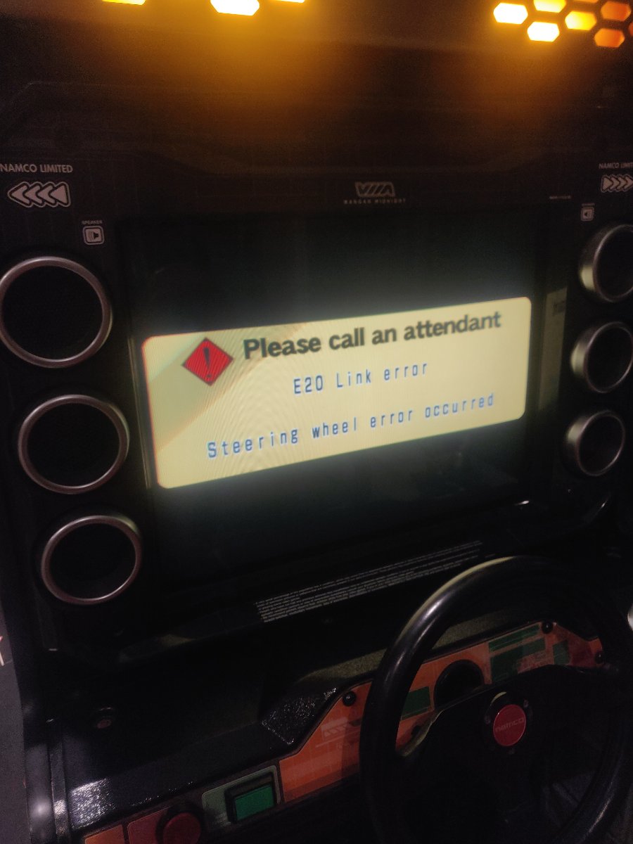

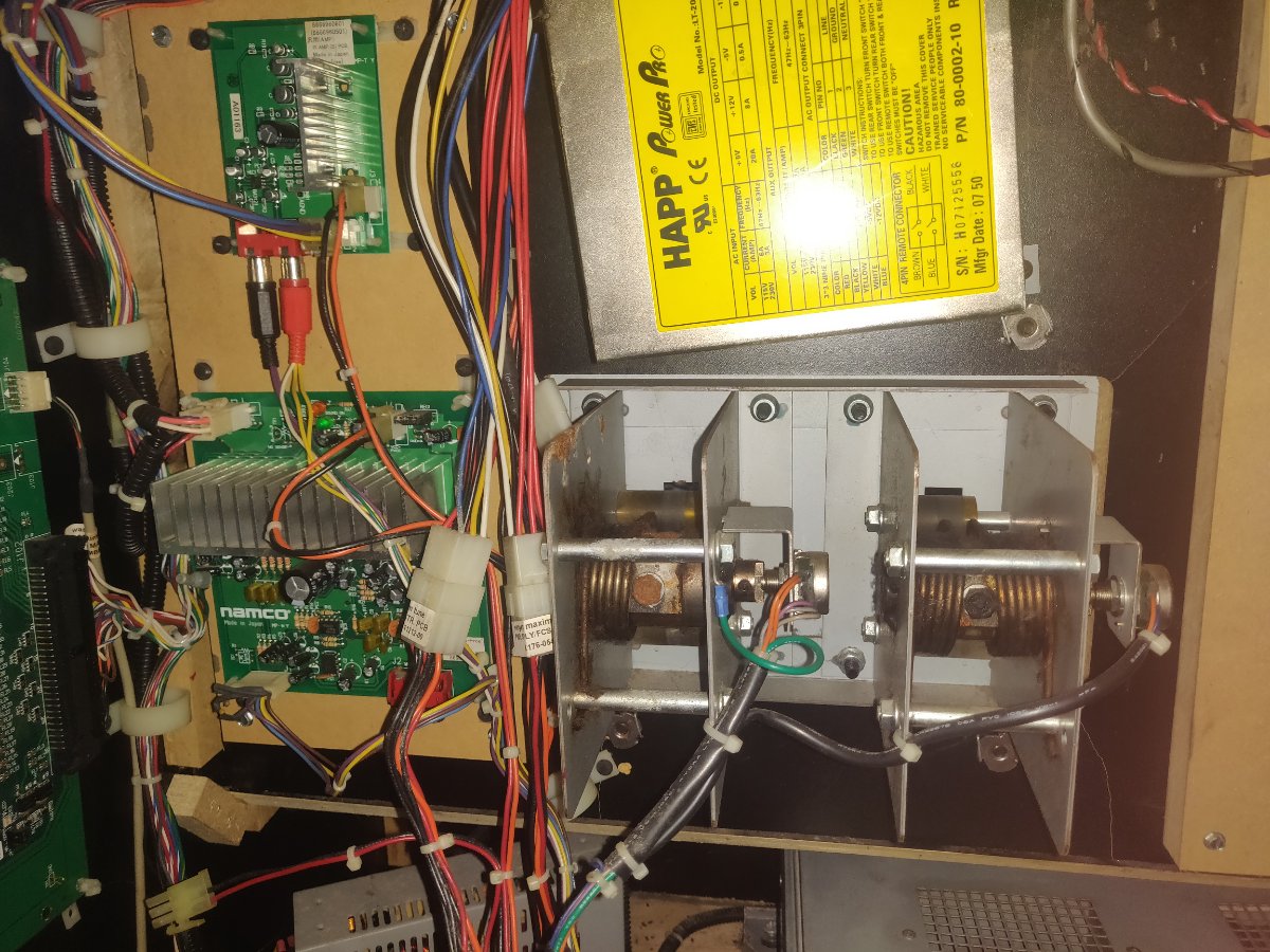

Also had a bit of a scare tonight, as I was in the entry menu error E20 popped up, even going into the test menu didn't fix it. But thankfully after a reboot that seemed to do the trick and the forcefeedback continued to work as normal. Hope this isn't a sign that my FFB board is on its way out. Either that or I think it's time to replace that PSU in my cab, do you guys know any good replacements?
