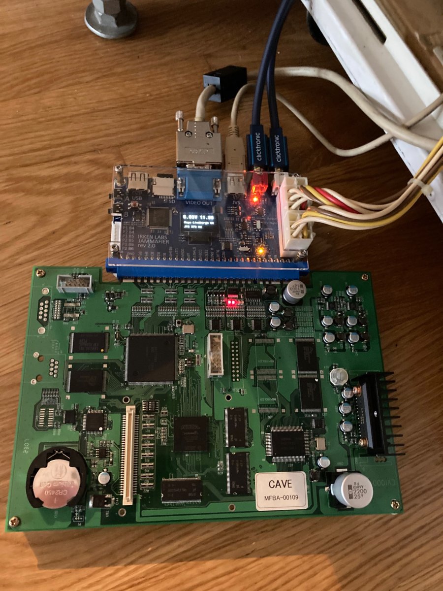

Short answer - the Jammafier does not attenuate/mix stereo signals.Perhaps a simple question which was answered before, but how to handle PCB’s that send out stereo sound on pin 10/L and use common ground for audio ground?
Or better make a breakout fingerboard between the PCB and Jammafier to tap the audio directly from there via a line level converter and not run it through the Jammafier?
If there is a stereo signal 10 and L, the Jammafier will use only one of them and the other will be left as unconnected - so should be perfectly safe.Thanks! I’ll tap it somewhere and send it via a line level converter to my NNC.
But if I would accidentally send stereo to the Jammafier, nothing would damage right? Worst case scenario I get no audio at all from the RCA’s?
