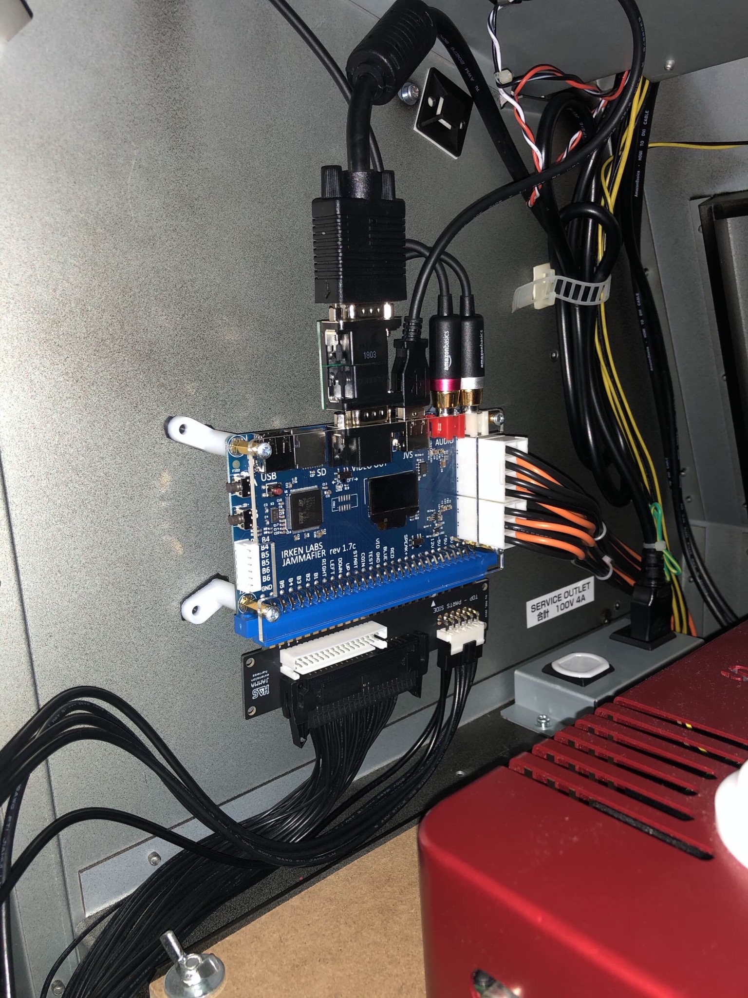

Hello,
i received the tri sync helper and i ran into an issue where its switching the sync rapidly from 264p 59.59hz to 261p 60.28p.
my set up is cps3 =>Jamma Extender => jammafier => try sync helper => vga cable => OSSC upscaler => hdmi-VGA cable => the vewlix monitor.
try sync helper is set on CS
If anyone is running this setup and can give me some tips to trace the issue that would be great. Thanks in advance to everyone.
