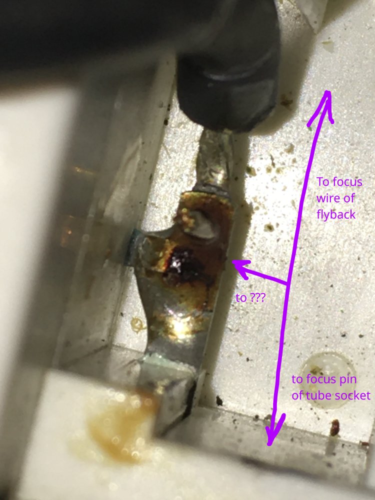

Inspecting the focus pin, I see it's soldered correctly to the focus wire, and that it has a 3rd connection to somewhere unknown

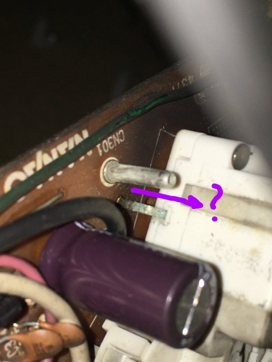

Inspecting from the left side, there is a corroded pin that comes out from the socket, but I don't know if it's the pin that's connected to the focus wire from the previous photo, multimeter gives no connection between them. I've done the same connectivity test but with the monitor of the other aero city cabinet that focuses well, and also got the same so I don't really know, what's the purpose of that pin? where is it connected from the socket? :S
For reference, the corroded pin goes there.
Would this corroded pin be related to the focus issue? Found the monitor of the other aero city also has the same pin similarly corroded, but its focus works perfectly. What would be the purpose of that pin?

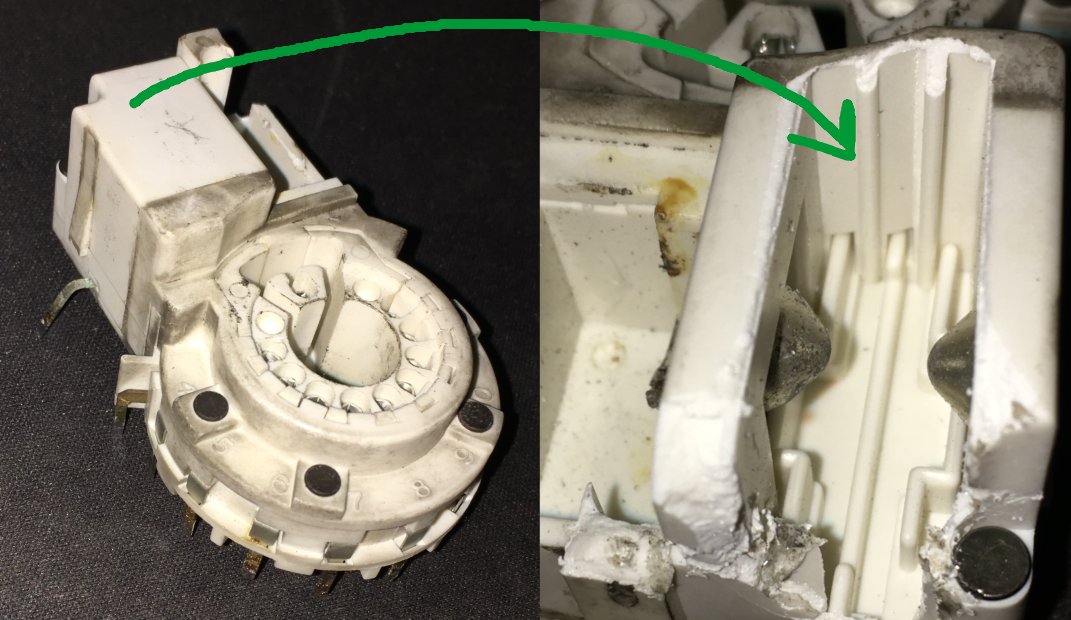

After that, I wanted the socket to reveal its secrets, had to destroy it for that, since it was all "riveted", unserviceable. (luckily new sockets aren't like that). It was pretty corroded:

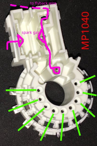

New sockets don't have a redundant pin old socket had. Also, the most further away pin is at a different location on the new sockets, but the neck board has already a hole for that from factory!:
Also, check out what's inside new sockets, new and shiny plates. Ended up choosing the MP1040 just because it was ready not like the other that needs a hole drilled inside. I'd say they're the same:

There is a last mod,, if you want use the spark gaps, those are usually connected at pin 9 on all Nanao socket but on the replacement socket this pin is the 12 so you have connect the pin 12 to neck board ground.

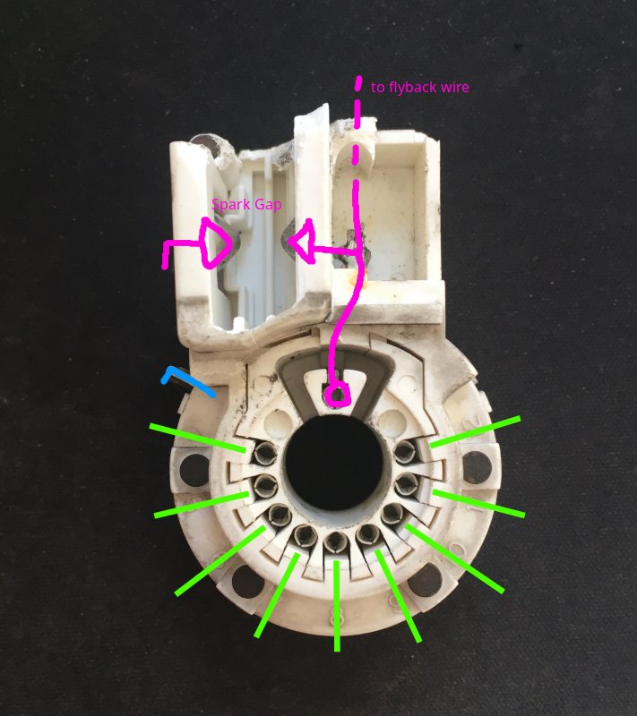

Hi Mukuro, I guess the spark gap is being used with the replacement socket too, here's a picture about the connections of the old socket
  • (green) pins match with the new socket
  • there is a unused pin (blue) that is not connected to anything in the socket (measured w/multimeter), new socket doesn't have it, didn't make a difference
  • (magenta) focus pin changed its location a bit in the new socket but monitor PCB had a hole for it so no problem, it's connected.
Is some connection missing? Can you explain the mod a bit more? Thanks!
I'm sorry ,to be clear, in order to connect the spark gap protection to the new socket then you have to link pin 12 of the new socket to ground.
