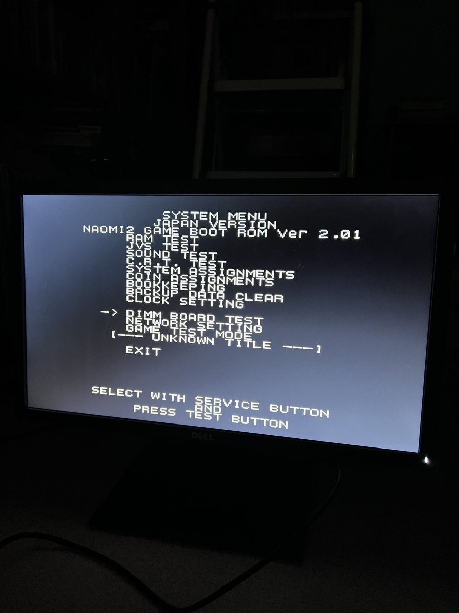

Does this mean I have the newest bios? Or is it not definitive? I saw someone say this 2.01 is Rev C\H?
oh heck yeah! no more relay needed, which is good because I never installed one anyways :)
