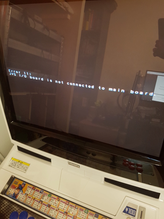

UPDATE: Unless I'm missing something, OpenJVS communication for the I/O will be dropped on Initial D Arcade games if using anything under Raspberry Pi 4.
I tried using the same 5.1V 3.2A that powered the Pi 4 on the Pi 3, with a USB-C to Micro USB adapter, but the com. error showed up after 30 min.
I tested with a Pi3B+ and a USB RS485 adaptor and ran for over an hour in attract mode on ID3 - I'm not sure what to make of the issue you're having I'm afraid but I can only guess is being multibios/region setting related. I'm running the 2020 multibios in Export region, maybe try that?

Both @mathewbeall and I have tested this using the new multibios, but I've also tested this on the EXP bios as well with com. i/o failures.

Weirdest thing - but I am glad my Rpi4 solution is stable. No idea why it was doing it, and just with InitialD - but I need the Rpi4 anyways for OpenJVS and bluetooth support, so all good!

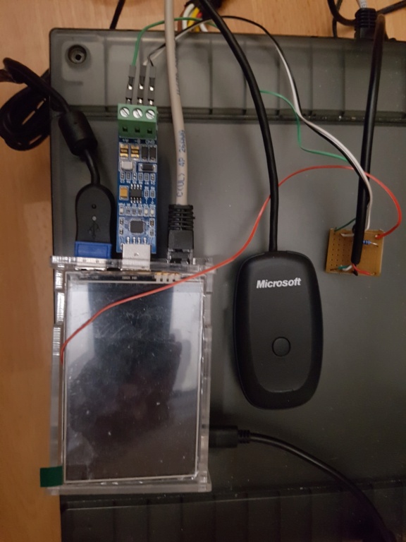

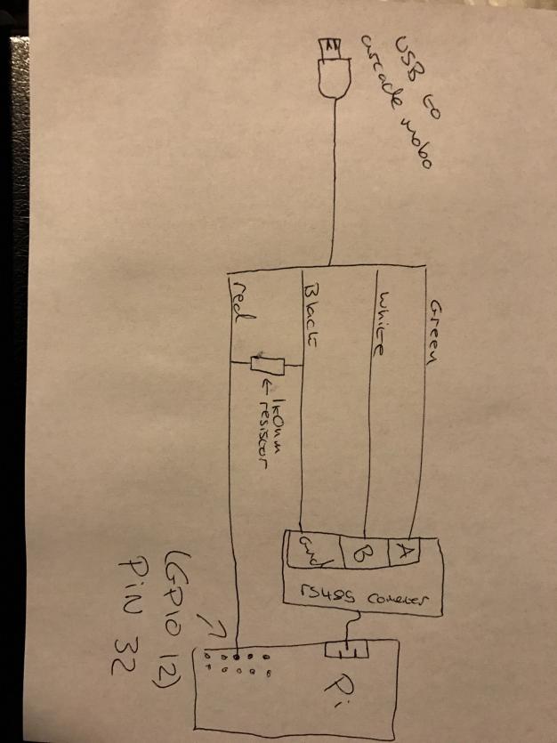

Hello I try to use one xbox wireless controller with wipi on chihiro system but not run:
My set up:
and the mittle pcb scheme:
but dont run how to please?

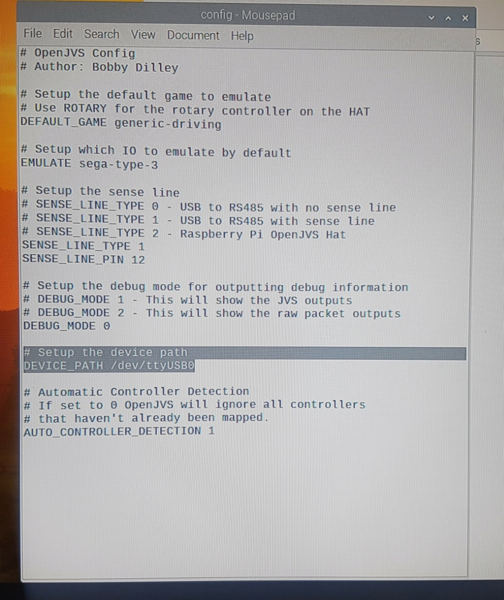

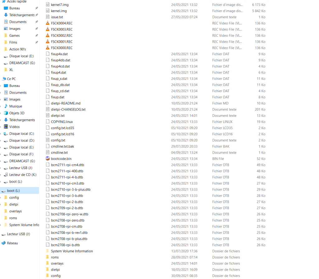

That's /boot - you need to SSH to the pi to access /etc/openjvs - use WinSCP and open a connection to the IP address of your pi, connect using root/raspberry
THX I checked and it's already set :
Maybe connect the controller on other USB port? Maybe the USB0?
Does it work without using WiPi? From the command line? If not please raise the issue on the OpenJVS thread as it could be hardware/driver related. The first adaptor I tried wasn't FTDI based and didn't work.

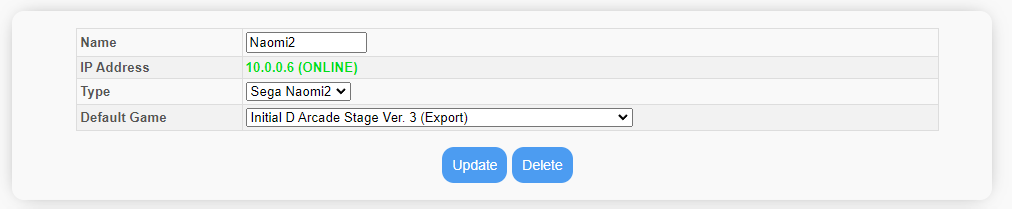

Mini update if anyone would like to use it, you can set a default game per dimm and when you use single boot mode it will attempt to send the configured game to the dimm if it's online: https://drive.google.com/file/d/1UKsWMNS5cuWZCTRvF1hk2a7ucki2c6mY/view?usp=sharing. This replaces the 'boot the last played game' functionality.
Only apply this if you are running v6 of the image
Howdy! So I got around to testing this tonight - because the single boot option never quite worked for me - I still had to select the game. I got all the files moved over -> here is my config on the netdimm screen:
But I still can't get the Pi to send the game over automatically. I have tried different boot orders/timing. If the Rpi comes on too late, you get a gateway error, etc.
Are you just turning on the Pi and the Naomi2 at the same time? I have to end up going into the menu and selecting the game to get it to load.

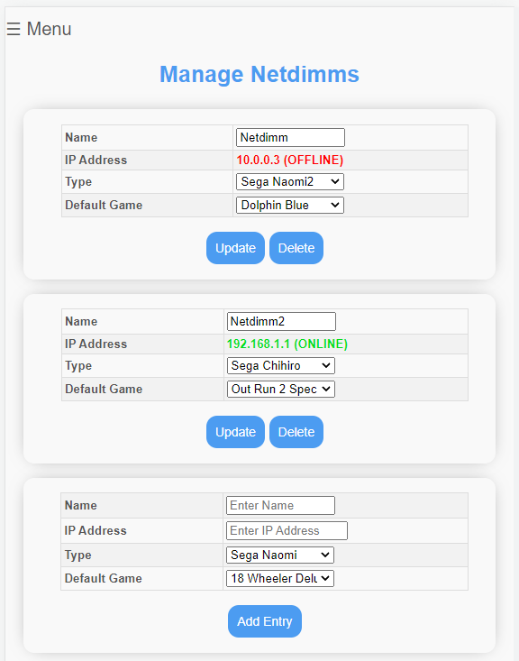

In answer to your question about multiple Pi's you can do that, on the network settings you can change the SSID and password for the hotspot if you're using hotspot mode. Another option is to use one Pi and connect your netdimms to your home network, (or to the Pi via a switch) give each one a different IP address and you can control both from one place. If you need help with setting it up send me a PM and I can advise.

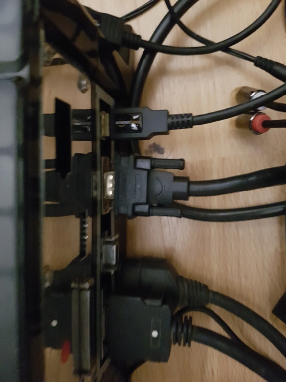

Update here,
Hope someone can see this can get help (or an alternate solution) I tried to hit the power to 5.1v, even 5.28 v at maximum, but the console still can not work properly. Maybe the pi still needs more power, but I was really afraid to damage the Naomi console or net DIMM or the arcade cabinet itself. So I stopped there. And reluctantly put the external power (for the console) into the cabinet. You can see my setup picture in the attachment. Yeah, it is a little noise using the external power, but I can accept it when the door is locked.
Now, as you can see, no mess, everything is settled and works fine.
So if anyone there, facing the same problem I had, at least you know there is a solution for that. Not perfect, but safe and works.
P.S No doubt, I still want to get rid of this external power brick and cords.
