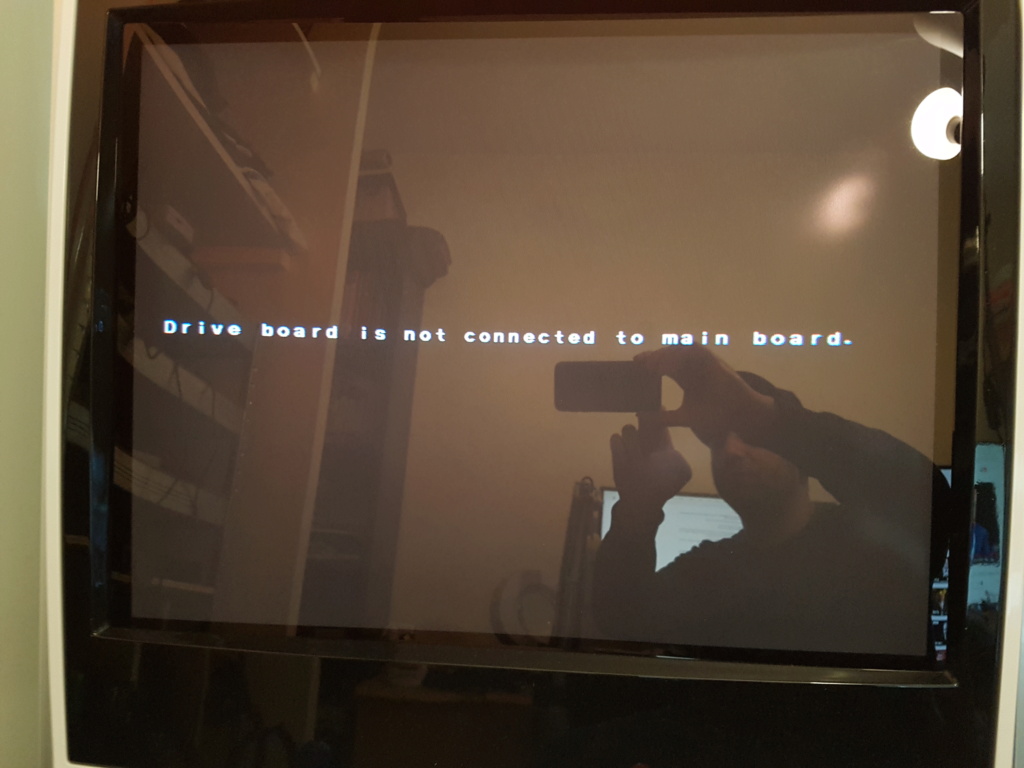

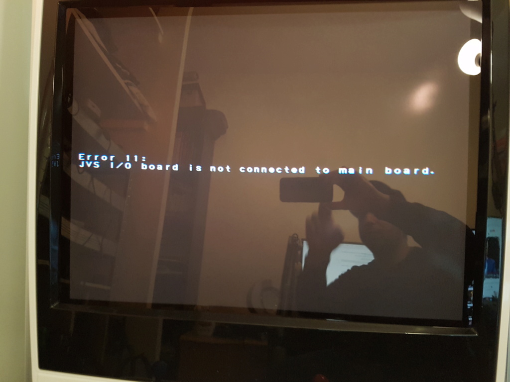

THX all I am so dumb I made a confusion in status column and action column , command column was in enabled and I believed is the status, so my controller is detected and now I have this message:
Try Wangan midnight 1 or 2. Go to the test menu and disable the Drive motor and the card reader ( unless you have it enable in the Wipi)
Does it work?
As I asked before - does it work without using WiPi? From the command line on the raspberry pi? If not please raise the issue on the OpenJVS thread as it could be hardware/driver related. The first adaptor I tried wasn't FTDI based and didn't work. To run it from the command line you need to connect to the raspberry pi using putty with username/password root/raspberry and launch openjvs by typing 'sudo openjvs wangan-midnight-maximum-tune' and see what happens.

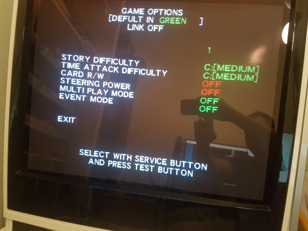

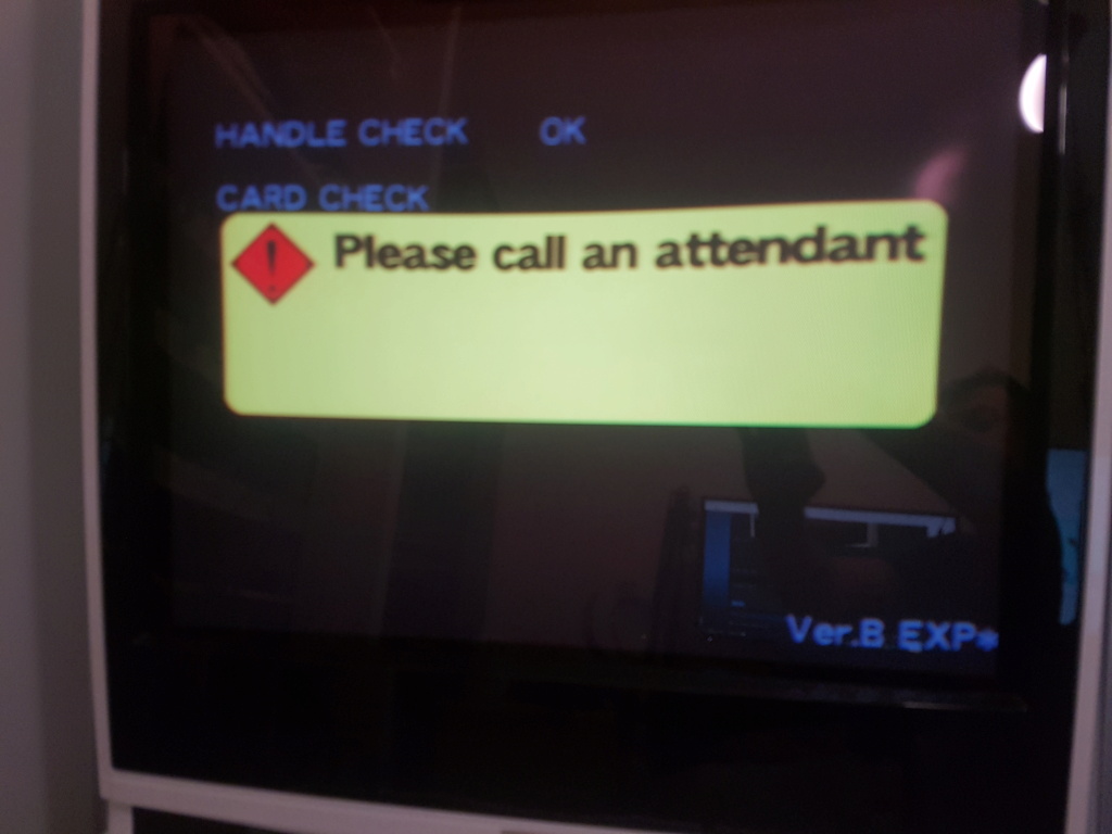

So connected everything back and tested:
Booted Mario Kart 1 (also tried Mario Kart 2 earlier) and went to game menu. Then went to card reader emulator and created a Mario Card from there. Back in game menu I've run a card test which did not show any error during 'card initialize wait'. But after game loading the error 'Card readers are not functional' is shown on screen.
When I start the card emulator on RaspPi it says 'Card emulator will launch on: /dev/ttyUSB0'. Does it matters which USB port is used?
