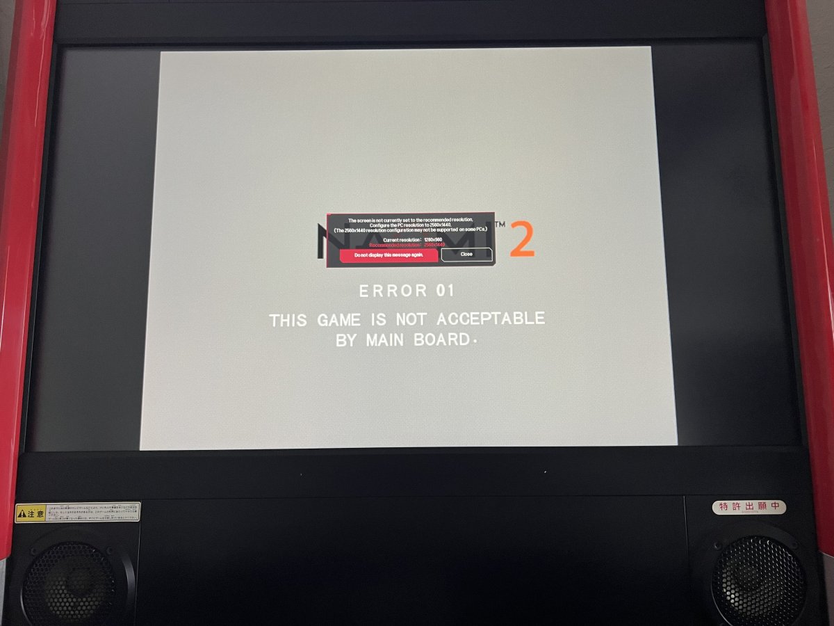

Does anyone know what this error means exactly.
It was working fine like a 3 weeks ago.

https://wiki.arcadeotaku.com/w/Sega_NAOMI_Error_Codes
Error 01​
Display: THIS GAME IS NOT ACCEPTABLE BY MAIN BOARD.
Cause: The ROM BOARD (or DIMM BOARD) is not connected correctly to the MAIN BD. The NAOMI 2 ROM board is mounted on the NAOMI main board.
Countermeasures: First, turn power off, connect the ROM BD (or DIMM BOARD) correctly. If the status is not improved yet, the board may be malfunctioning. The NAOMI 2 ROM board software cannot run with the NAOMI main board. If you want to run the NAOMI 2 ROM board software, replace the NAOMI main board with the NAOMI 2 main board.
So either you are trying to boot a Naomi 2 game on a Naomi 1 board or you just need to reseat your netdimm
Error 01​
Hey thanks for the info I appreciate it. I just tried reseating the net dimm and still the same.. im running a Naomi 2 main board and a net dimm with the pi 2 (i think can’t remember) with piforce v1.5 setup.
When i try to ping the netdimm it says its unreachable :\
Also what voltage range is good for the naomi when running the netdimm and the piforce all together.
I'd see if you can try / borrow / buy a regular game, and see if it fires up, if it does it's your net-dimm, and then I'd suggest sending it to irepairsega.com

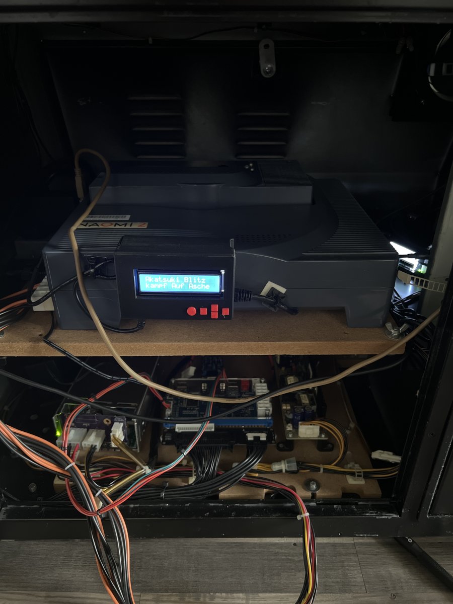

Is there a way to get "currently playing GAME" and/or "Last GAME Played" (just the game name) to be displayed in the 16x2 LCD Display?
Yep! Added to feature request list
Is this so you don't have to scroll through the list to play the same game again? out of interest, how may people still use the LCD screens? It's dead easy to add more features to display information on the screen, does anyone have more requests?

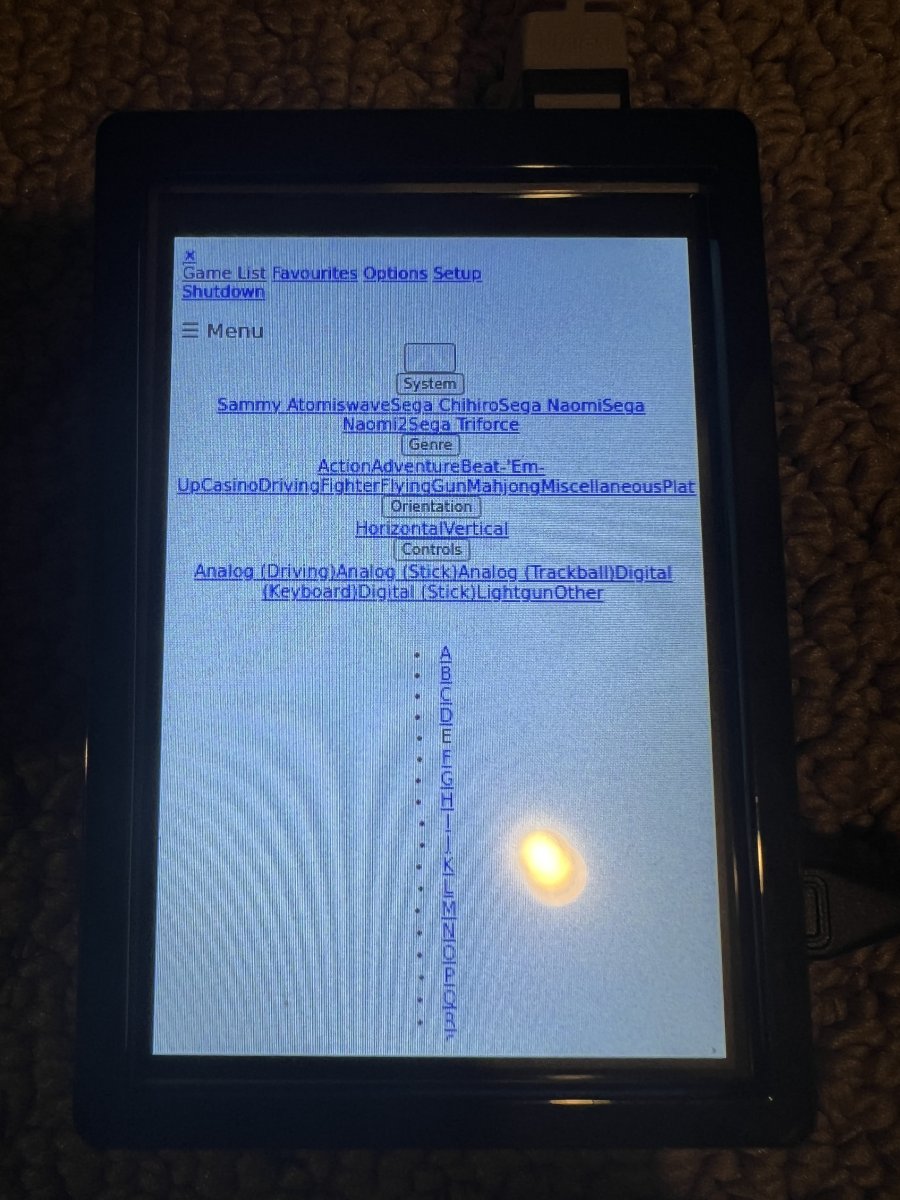

@chunksin sorry if this has already been mentioned. It looks like the webpage got corrupt somehow?
Also when you go to update netdimm firmware, if you are on v4.03, it’s says current firmware UNKNOWN
No. I just want to see some information on the Display. Like "Booting", "Uploading", "Playing xy" etc. I couldn't care less for the buttons on the screen (since i select games by web browser). The display is nice to see something is happening.
Currently i am testing a 3,5" touch display. Is there a way to rotate the screen to use it in landscape?
I was thinking about updating this to use a higher resolution oled screen with buttons and a mini joystick to update the old LCD but I can only find small bonnet sized boards rather than full size hat boards. There is a way to rotate the LCD, the instructions are in this thread, back a few pages, just a few files to update.
Had a quick look around and the GFX Hat and Hyperpixel 4.0 screens look pretty good as updates to the existing supported screens
