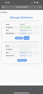

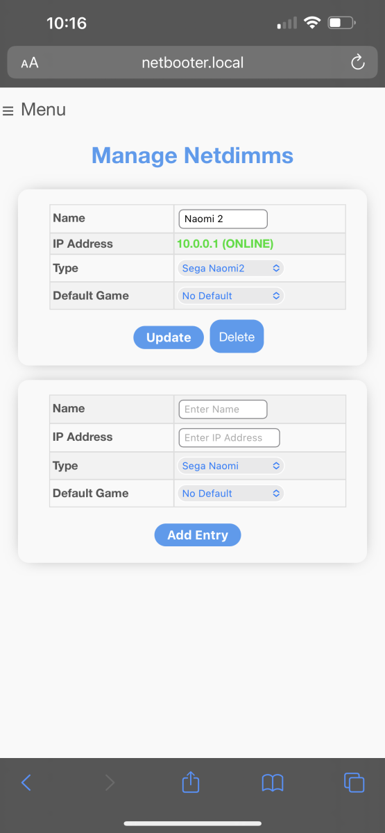

I got the image setup on a Pi3 and moved over the screen to the Pi3. I then went to the netbooter.local in a web browser. Added 10.0.0.3 to the Add Dimms section on netbooter.local. It said it couldnt see the dimm. I then tried to switch to wifi direct mode on the netbooter.local and the Pi didnt seem to reboot.
Now I can no longer see wipi wifi network on my phone
So i am rewriting the image and trying again. Anyone know where I went wrong? If my naomi wont save the IP settings after reboot I would just need to use the default IP on the naomi correct?
A bit confused by the part that mentions MKGP, MKGP, WMMT, and WMMT2 Triforce J3 or Chihiro CN5. If I just have a Naomi 2 setup and no Triforce or Chihiro boards do I just ignore this part?
I rebooted, with a clean image and still cant boot any games even off of the Pi directly without logging into the netboot.local webpage. Does the Naomi have to be set to 10.0.0.2 or 10.0.0.3 to work?
I then tried to setup WiFi Direct mode on the netbooter.local webpage. It says rebooting then the Pi seems to reboot but not the webpage.
After that I get a "this game is not suitable for your system error"

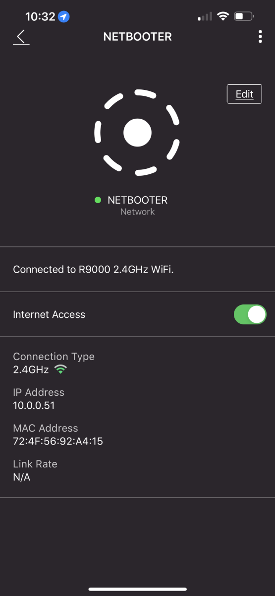

Then I try to connect to 10.0.0.51 which is listed on my router as the NetBooter address and no page comes up.
When I try to load a game from the Pi screen itself i get transfer complete then nothing happpens.
Is the Pi supposed to be 10.0.0.1 and the Naomi Net Dimm 10.0.0.2?
I also tried the network scan on netboot.local when it was working and it searches 192.168 addresses and 10.0.0 addresses and cant find anything.

I got the image setup on a Pi3 and moved over the screen. When I try to set my Naomi to 10.0.0.3 in the settings it doesnt seem to save them. I then went to the netbooter.local in a web browser. Added 10.0.0.3 to the Add Dimms section on netbooter.local. It said it couldnt see the dimm. I then tried to switch to wifi direct mode on the netbooter.local and the Pi didnt seem to reboot.
Not sure about the Naomi not saving the netdimm configuration.
To reset the wipi network settings, you can create a text file called "reset.txt" and place it in the root of the SD card for the pi. That should reset it back to the default. Saves you from having to re-write the image entirely if the network settings get messed up.
The J3 and CN8 parts you mentioned are for the card emulator to save progress in those games. As you mentioned, they're for Triforce and Chihiro, and you have a Naomi 2, so you can ignore that part.
Once I change the WiFi mode on the netboot.local webpage and enter my SSID and PW, and it reboots, how do I now access the netboot.local aka the Pi? Just by the IP address of the Pi?
Ok I got it working I was mixing up
IPs and not clicking set after inputting the ip into the Naomi. Just need to figure out this Wi-Fi Direct Mode now. Think im just not entering the right ip into my browser.

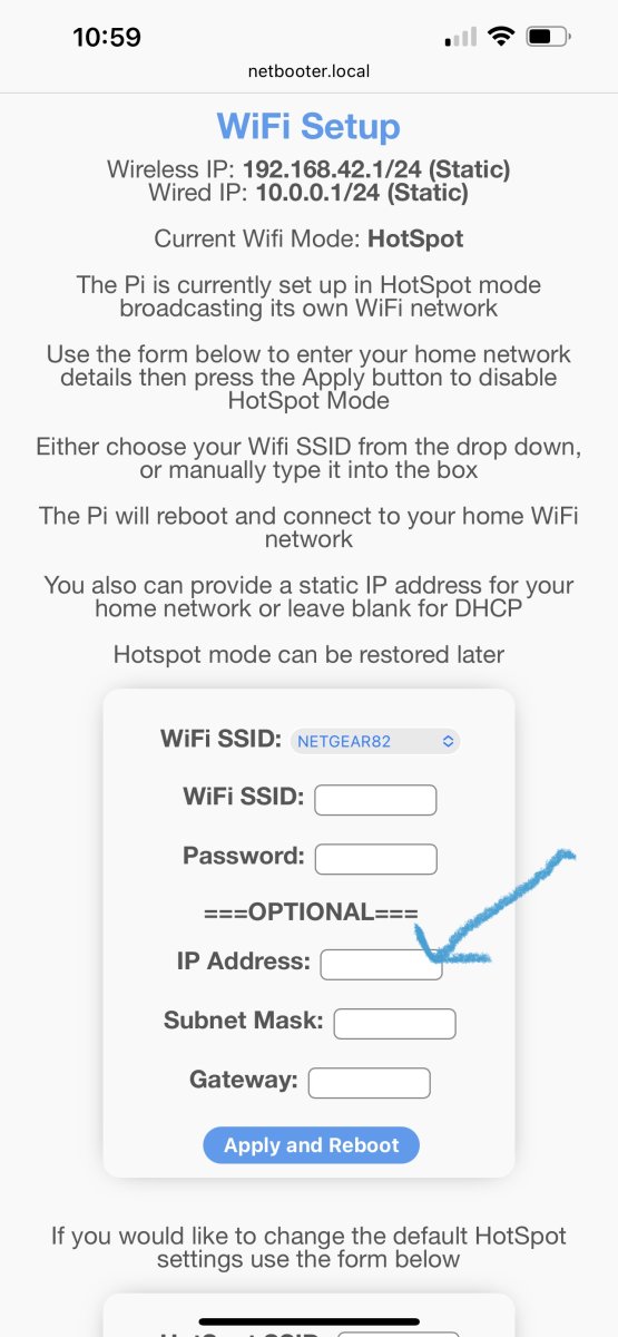

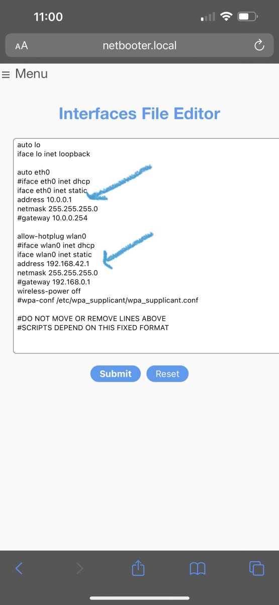

How do I set the WiPi address? In either of these places? I need this explained to me like I’m a child as specifically as possible. Love you all sorry to be a bother.
I would probably change the wired network to something silly… 192.168.168.168 whatever… then connect to your Wi-Fi without setting a static address or anything else. Make it so that the Wi-Fi can connect without conflicting with the Ethernet IP address range.
Then change the wired network to what that should be.
Then change the NetDimm params to the wired ones.
May want to throw in a reset.txt first to ensure no current settings interfere.

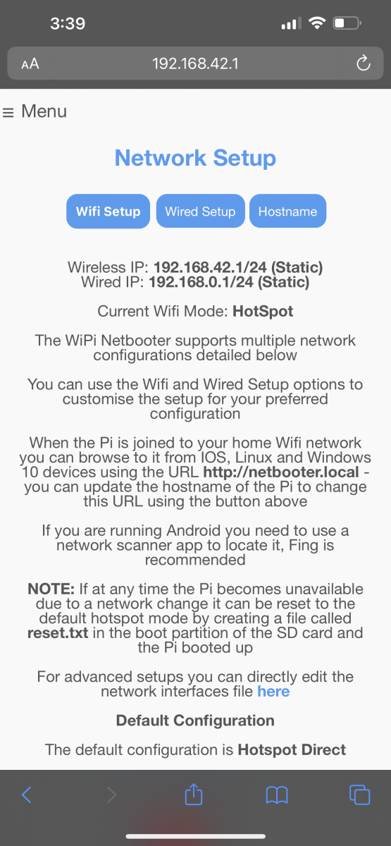

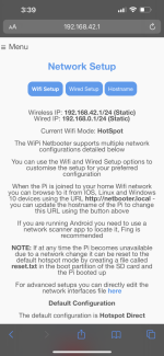

I was able to get my WiPi to 192.168.0.1 with a gateway of 192.168.0.1 (I didn’t know what else to put) via diet-pi settings and net dimm to 192.168.0.2.
Net dimm adds successfully
But my wifi address on the WiPi is listed as 192.168.42.1/24 static.
Couldn’t figure out how to set the WiPi wifi to DHCP.
In this case I could connect to 192.168.42.1 and see the WiPi page from my home wifi which is great but it still was in hotspot mode and not technically joined to my router. Making tiny progress though lol.
