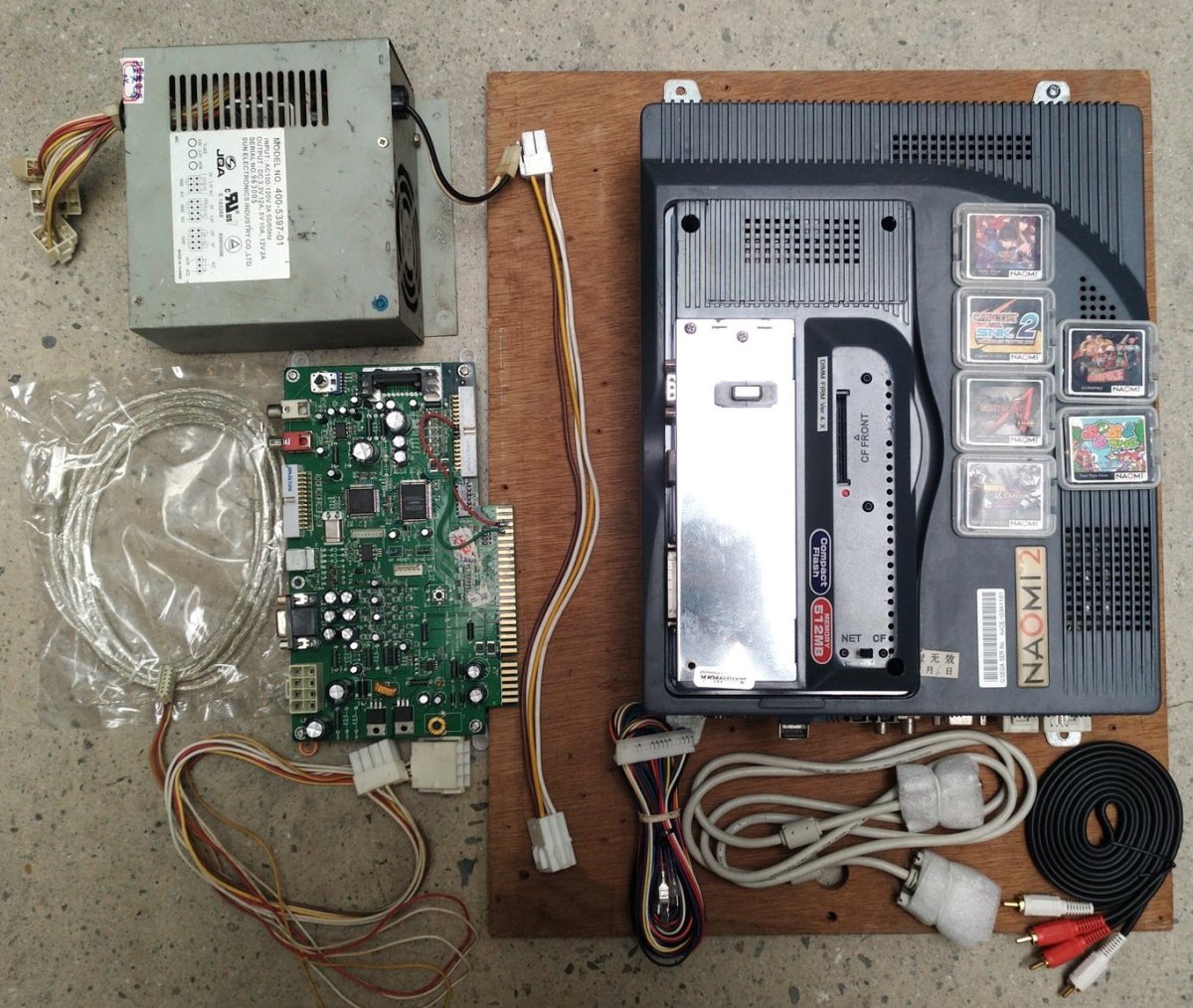

Need help with my Naomi 2 CF setup.
robbiederhase
Jan 19, 2022
89
26
chino
Hi everyone.
I'd please like a little help getting my Naomi 2 set up with a CF reader dimm board i got from axunworks.
So I run a little game/music/collectibles shop in socal and I have a small arcade section for guests to come play.
I bought a blast city just to run a Naomi 2 board specifically. After acquiring (i believe) everything I need, I'm realizing both the Blast City and the Naomi are basically a foreign language to me as someone who has only ever dealt with a New Astro City, a Tecmo Kyotaro, and an MVS... Below I have some images I've taken of my current kit and Blast City's wiring spaghetti.
Can somebody basically draw me a diagram of where everything needs to be plugged into? I'm much more of a visual learner in aspects such as this.
I know it might seem a bit of a juvenile question and I'm sorry ahead of time but I just don't want to risk frying anything.
The bundle I bought included a GD-Rom drive, and a stock Net Dimm but know I won't need them for this setup.
However it did come with one of those bootleg Capcom i/o boards.. I have no clue how to set that up with a kick harness.
I bought a CPSII kick harness but didn't notice the port was a completely different shape until it arrived. On top of that it doesn't seem like anyone makes after market harnesses for it..
At a complete loss there and at this point just looking for a cheap (real) Capcom i/o if I do in fact need one. (running many games with full 6 button layout)
It's just been a matter of finding one for less than $300....... Many sellers I've shot offers at on ebay would then immediately hike the price up on the listing, it's fucking ridiculous....
Importing one from yahoo auctions at the moment is also basically pointless with how much shipping between middle men is.
I also don't entirely know if i need one of those power cables for the capcom i/o. I see many go for sale in tandem with one but my bundle didn't include it.
I'm more than happy to answer any other questions for gaps in information I may have forgotten to include.
Bonus points if anybody is in the Chino CA area and wants to come visit the shop to help me set it up honestly!
Again, sorry for the dumb questions.
Just at my wits end here and want to avoid destroying anything involved in my money sink lol.
thank you!

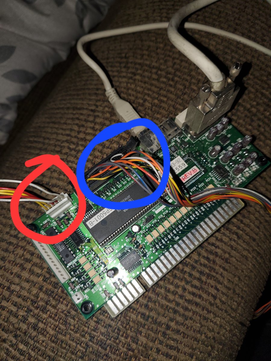

Is it possible to actually just order a plug that fits the 14 pin kick port on the Sega IO and t h e n disassemble this now spare CPSII kick harness and wire it directly to my buttons? Just to forgo having to make any extra harnesses that wire to the ports inside the CP? A pandora box that came with the cab has a CPS kick harness that goes directly from the elf adapter board straight to the kick buttons. pulled through a gap in the control panel I've seen others do this with the Capcom IO and what I was planning to do as well... Would this be the same case? I know it's not the prettiest route but I have plenty of zip ties and adhesive clips to keep it tidy.
Could someone explain to me which of these are kicks? I'm guessing the blue circle.
If so. What does the red jst do? (Red circle
Red circle is a power header, if the IO is not powered by JAMMA
Blue circle is Analog
Buttons 1-5 are JAMMA edge (4 and 5 extend past button 3 like on neo geo etc)
Buttons 6+ are on the header to the left of your red circle.
Thank you.

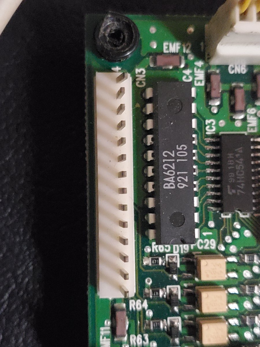

Do you know the part number for the 14 pin jst connector? I'm assuming pin 4 and 8 are kick 6 for p1/p2 and I just need to grab a ground off pin 14?
Thank you.
Correct, and Pin 14 will work fine for GND.
https://wiki.arcadeotaku.com/w/JVS#Sega_838-13683-93
Kick/Extra buttons​
CN3 is a 14-pin JST_NH connector, when jumper JP1 in position B:
  • 5 buttons pr player, all on jamma edge
  • 8 general purpose driver outputs on CN3
Jumper JP1 in position A:
  • No general purpose outputs
  • 9 Buttons pr player, with buttons 6-9 via CN3:
1 - 5VDC Out
2 - 5VDC Out
3 - 5VDC Out
4 - P1 button 6
5 - P1 button 7
6 - P1 button 8
7 - p1 button 9
8 - p2 button 6
9 - p2 button 7
10 - p2 button 8
11 - p2 button 9
12 - GND
13 - GND
14 - GND
Bear in mind if you hadn't gathered from the posts above you need to wire your buttons 4 and 5 and their grounds to the 15 pin connectors under the control panel so they reach the jamma edge, you mentioned they are only wired directly via a separate kick loom. Buttons 4 and 5 will go straight to the connectors, splice the grounds to the existing daisy chained grounds.
The pinout is here: https://wiki.arcadeotaku.com/w/Sega_Blast_City_Wiring_Guide
The pins you need are
TE Connectivity, AMP Universal Power Female Crimp Terminal Contacts

Alright everyone I have an update.
Lemony was kind enough to make me a custom adapter that also uses the CPS2 kick harness i had lying around.
Now having the Rev. 2 Sega IO board it snaps in perfectly.
However... I decided to boot everything up and I just get a black screen.
The N2 boots up (I can hear the fan turning) and the speakers have audible clicks every so often.
But other than that nothing... What am I doing wrong??
The VGA is also plugged into the monitor chassis.
The dips are all pushed down for the 31k display.
I made a little video just in case I have anything set up incorrectly and someone else may be able to notice my mistake.
Thanks much, everyone. Hoping I can get this solved...
View: https://youtu.be/JNzUCB1f4rs
