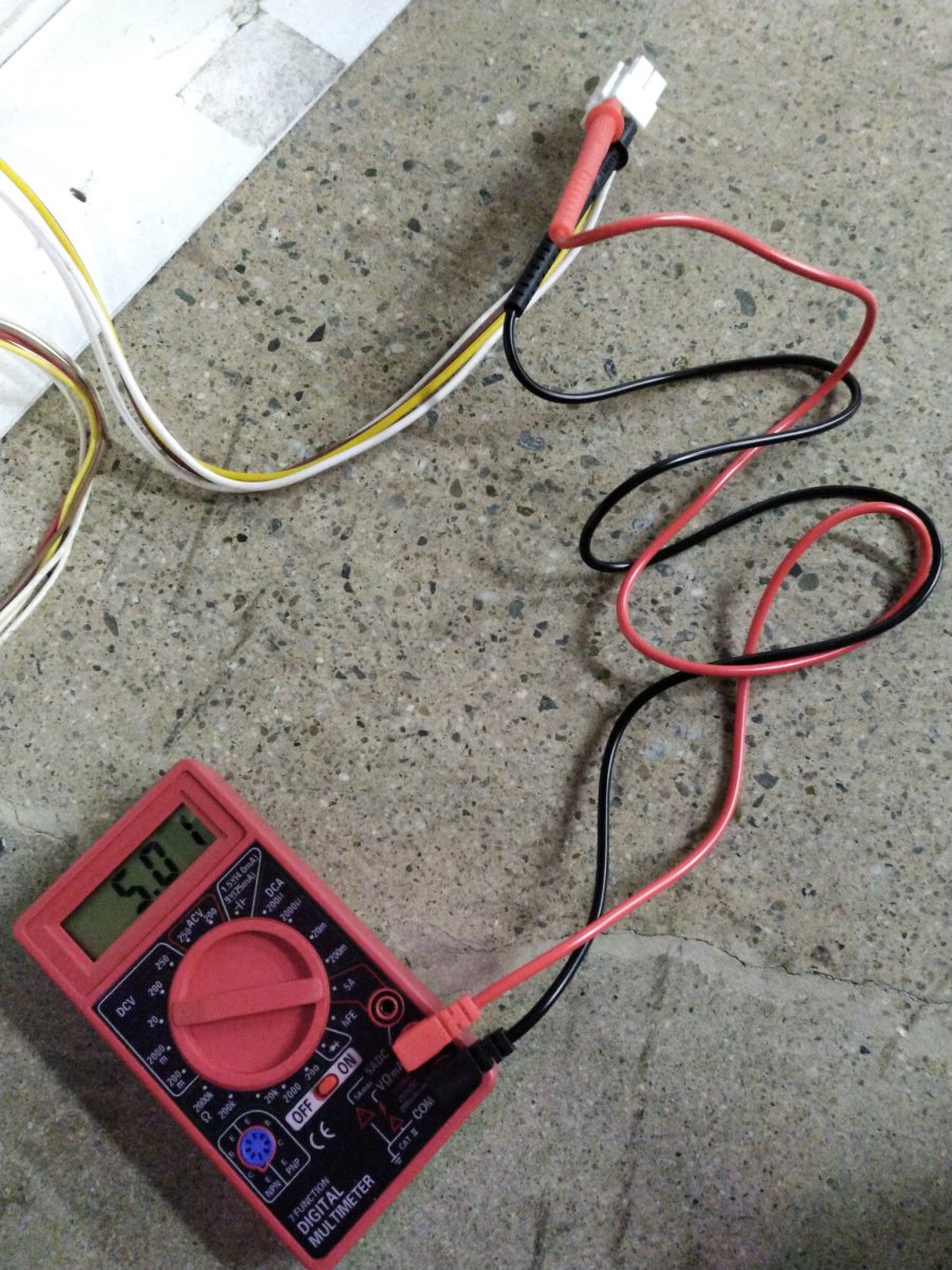

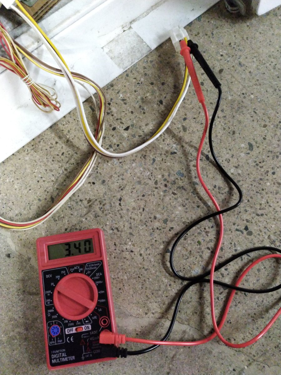

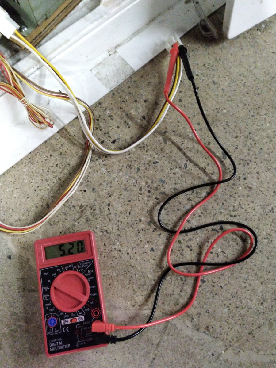

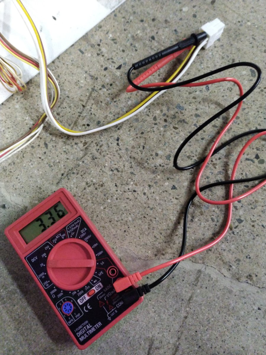

okay it looks as if i'm getting a much better reading here...
pin 1 is giving me 3.40v and pin 2 5.20v

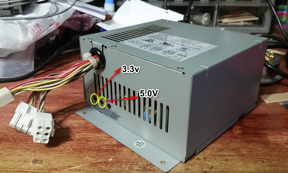

how do i go about adjusting this guy? nothing externally indicates there's a pot to adjust.
i don't mind removing the shielding otherwise.

There should be pots
i don't know how i missed that... but thank you for pointing it out for my blind ass.
okay update!
i can get pin 2 down to 5.1v but no lower... but i'm sure that's doable.
and as for pin 1 it doesn't go lower than 3.36v...
is this doable? or am i at risk? is there a way to adjust the pots even lower or am i screwed?

All you can do is try :)
*insert disclaimer here* :D :D
Btw.. 5.1v vs 5.01v is quite different :)

oh jeez is it? i had a feeling..
so 5.1 is technically 5.10v then correct?
and the same for 3.3v? 3.30 essentially?
again, sorry for all the very basic questions..
i'm essentially self taught and normally just work with hardware mods. crafty with a soldering iron and really nothing else.
5.01v is 5.0v, 3.36v is 3.4v if we go the normal rounding up and rounding down :)
That's normal, since you have no load on the PSU. Both voltages will drop when you connect the Naomi to the PSU. So when you have everything connected and running, adjust both voltages again. I usually aim for 3.33V and 5.05V.

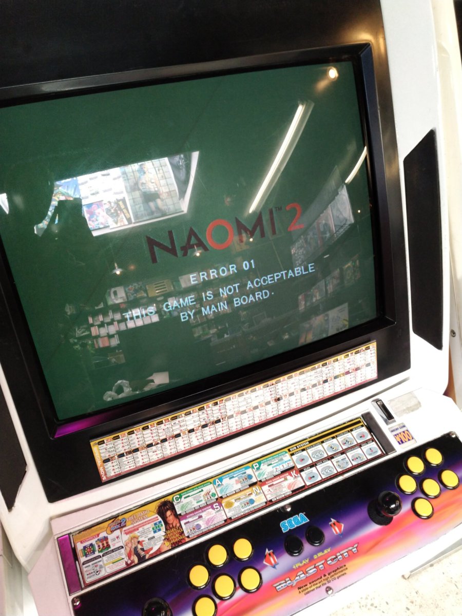

Great news!! the N2 is working! both sound and visuals! (haven't tested input yet but..)
Bad news. ??? What's the issue here? I have the Key plugged into the net dimm with a game inserted...
Is this a bios thing? I feel like I saw my N2 had the B bios chip but I thought that was only an issue with the N1...
Should I go ahead and order one of those multi bios chips?

MVC2 will run on any region, so it's not a bios region issue.
Can you do a dimm test in the service menu?

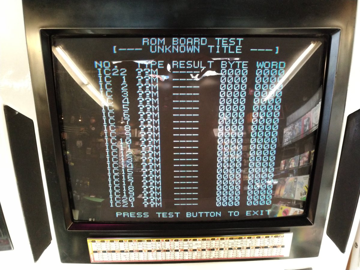

so i can access the service menu...
however when i scroll down to where i know it should say dimm board test. it says rom board test.. upon accessing it it displays unknown game and only produces zeroes...
i've pulled the dimm out and plugged it back in snuggly just to make sure if the connection was loose or if the cf card was loose but i still get the same result.

I could be wrong, but I didn't think CF boot showed the memory check correctly?
Is there another game you can try?
Normally error 01 is due to the cart not being seated properly or an incorrect bios.

the dimm is supposed to be connected, from what I see the dimm is not being recognized by the Naomi2 remove the dimm, clean the white sockets of the dimm, the Naomi 2 and reconnect them

I've tried melty blood actress again, gunspike, mvc2, and ggxxac and all display the same error...
So maybe it is the bios? I checked and it is the EPR-B chip.
I have a few times and still nothing... It also doesn't tell me a game isn't connected. It says game not recognized.
So I don't think it believes there is no game at all.
I'm leaning towards a BIOS issue - but i'm only hypothesising.
