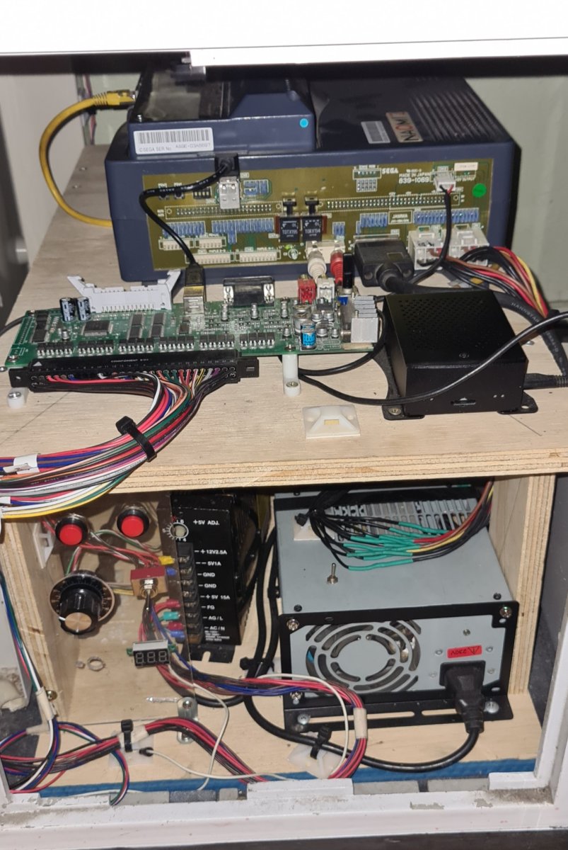

Alright everyone I have an update.
Lemony was kind enough to make me a custom adapter that also uses the CPS2 kick harness i had lying around.
Now having the Rev. 2 Sega IO board it snaps in perfectly.
However... I decided to boot everything up and I just get a black screen.
The N2 boots up (I can hear the fan turning) and the speakers have audible clicks every so often.
But other than that nothing... What am I doing wrong??
The VGA is also plugged into the monitor chassis.
The dips are all pushed down for the 31k display.
I made a little video just in case I have anything set up incorrectly and someone else may be able to notice my mistake.
Thanks much, everyone. Hoping I can get this solved...

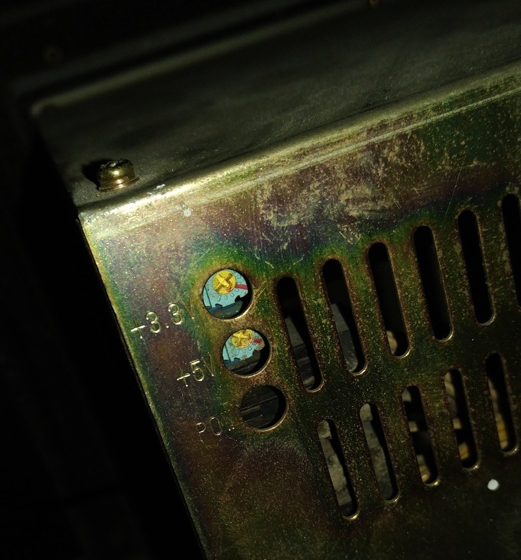

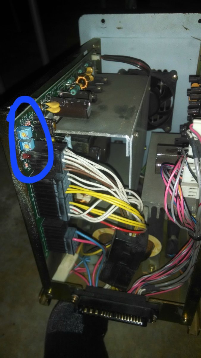

The power supply of the Sega BlastCity is switched internally it has some regulation potentiometer for the 5V and 3.3V check it I attach an image where it is but check the voltage of that power supply well I think that one is worn out take into account that it is a machine with 20 years or more may need maintenance
Okay so I've honestly been terrified to adjust my voltage at all... I can't seem to find a good way to test the voltage on this thing and I don't want to risk anything...
I can't find any local repair shops that will answer my calls either.
But. I took a look at the PSU and it looks like it has in fact been tweaked prior..
Should I try moving the 3.3v back to line up the red lines? Is clockwise turning the voltage up or is it counter clockwise?
I'm sorry again, everyone... I just want to make absolutely sure here.
I've never had to adjust voltage of any kind before, despite at least knowing how to work with Jamma voltage.

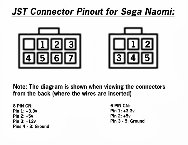

All good mate, we were all there at one stage.
The Sega blast city loom 001 will have an 8 and 6 way connector.. All the bottom wires (white) will be ground - so put your black probe in one of those holes..
Then put your red probe in Pin 2 on the 6 way connector (based on the below diagram) should be 5v (yellow) to get a reading
Repeat the same process for pin 1 to get then 3.3v (brown) reading.
Depending on the connector you have on your sun psu, you might be able to plug it into CN13 on the blast city io to allow you to power the sun psu when you turn the blast on.
Also, if the sun does work, you still should check the voltage, it's the first thing you should learn how to comfortably do in this hobby as inconsistent voltage is the root of all evil in this hobby :)

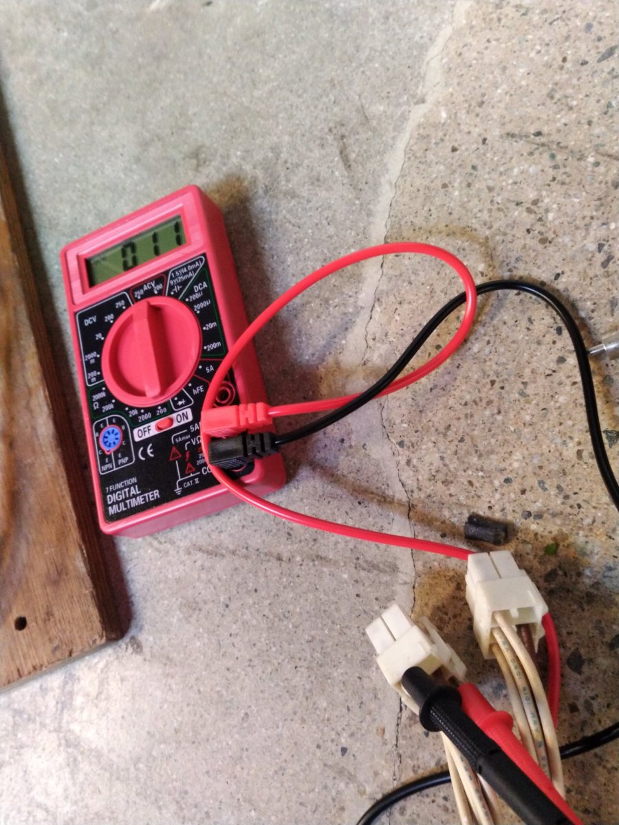

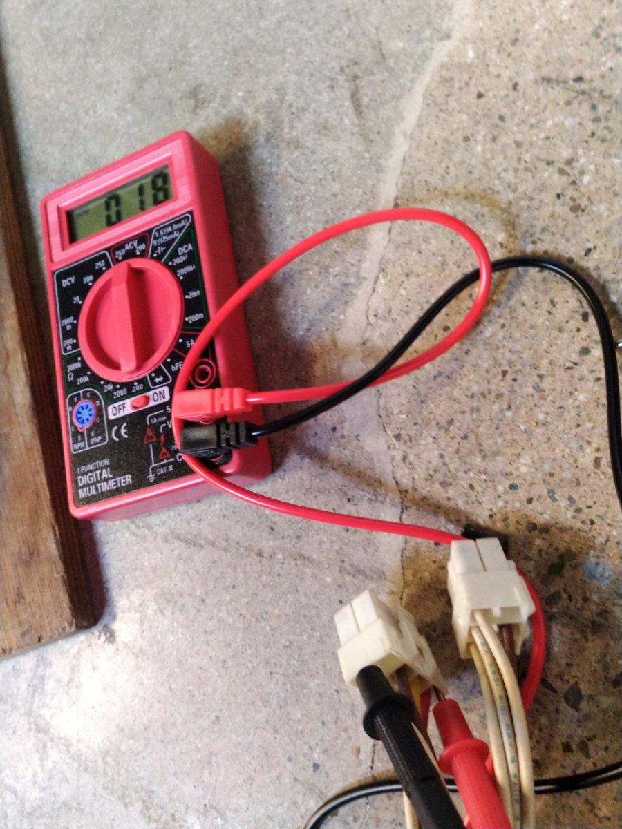

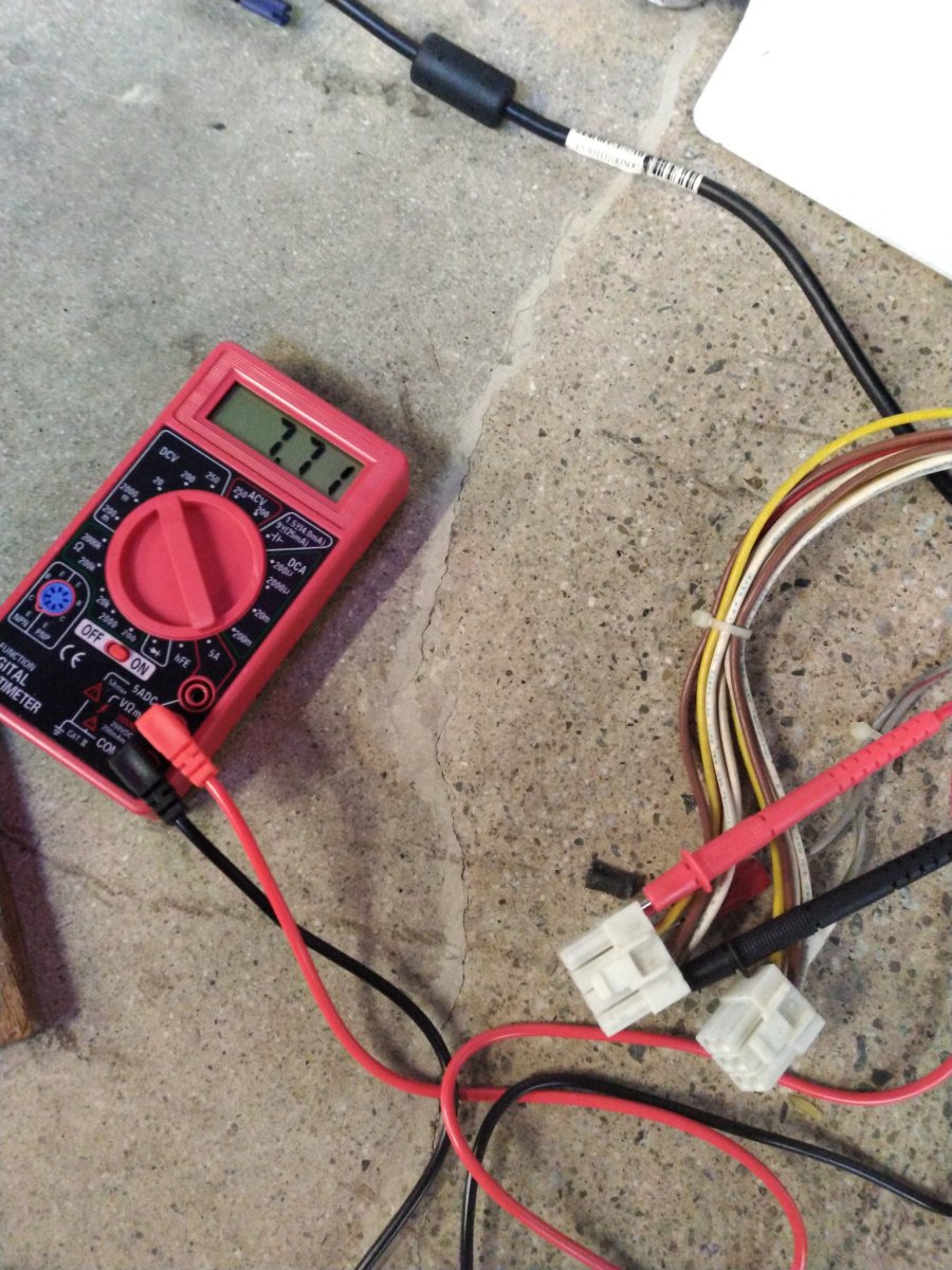

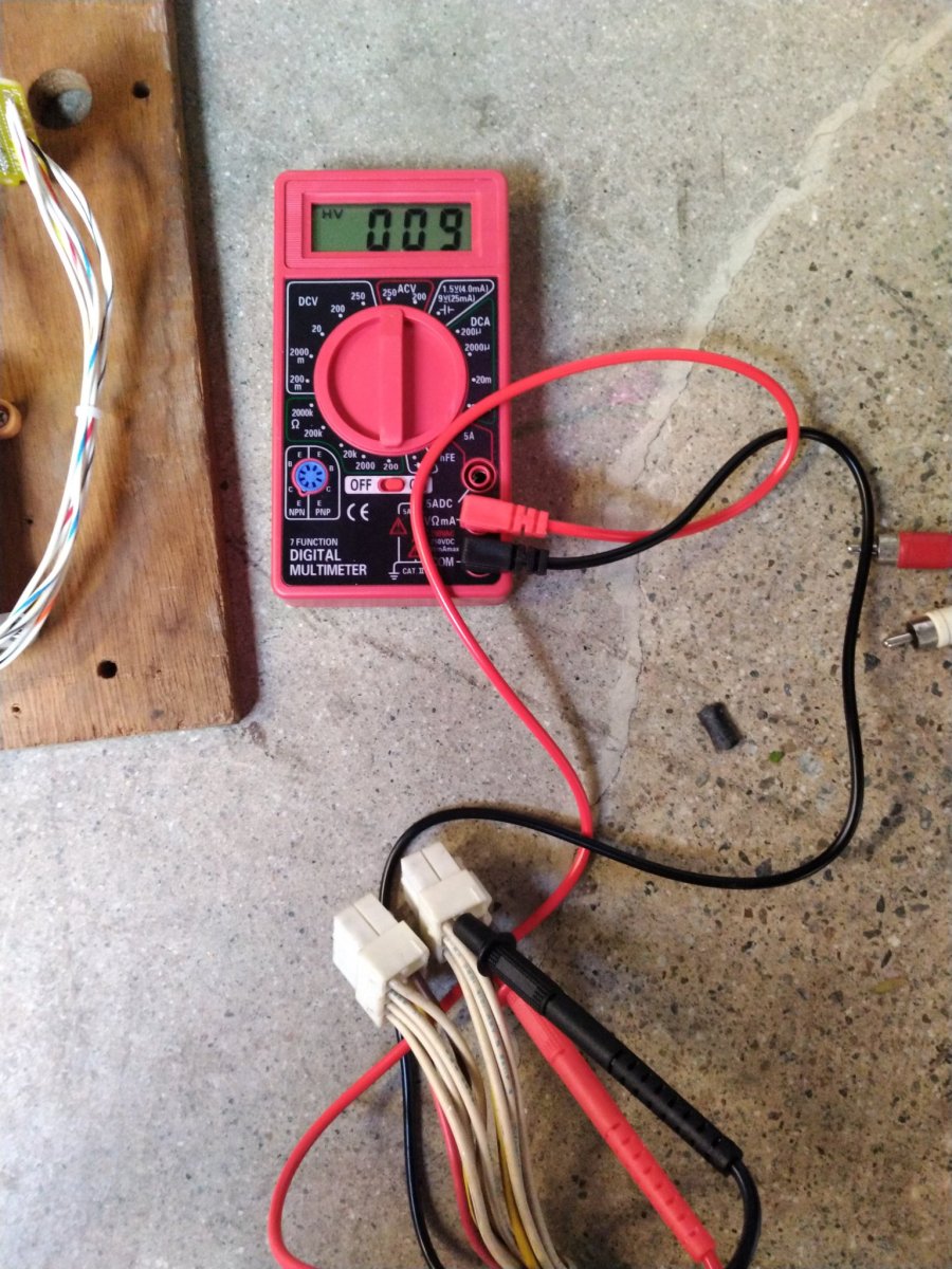

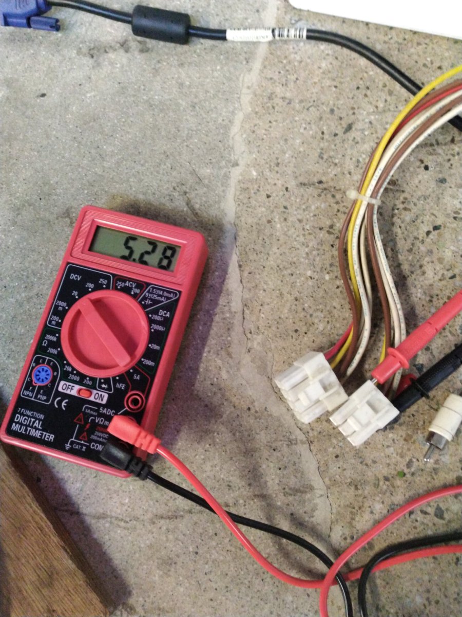

thank you so much for the diagram. this helped me a ton in understanding.
so i was able to get out and get a new multimeter. the readings are way off from what they should be... at least i think with what setting i have the thing on..?
they were all over cranked which i'm hoping hasn't damaged the naomi......
should i just install the sun psu?
if i should go about adjusting the voltage which way is voltage up and which way is down?
thanks much again...
pictures attached.
left to right
6pin 1, 6pin 2, 8pin 1, 8pin 2, and 8pin 3
pictures attached.
left to right

you have to measure with the knob set to 20 DCV to measure the correct voltage there you are measuring in AC (Alternating Current) in the photos

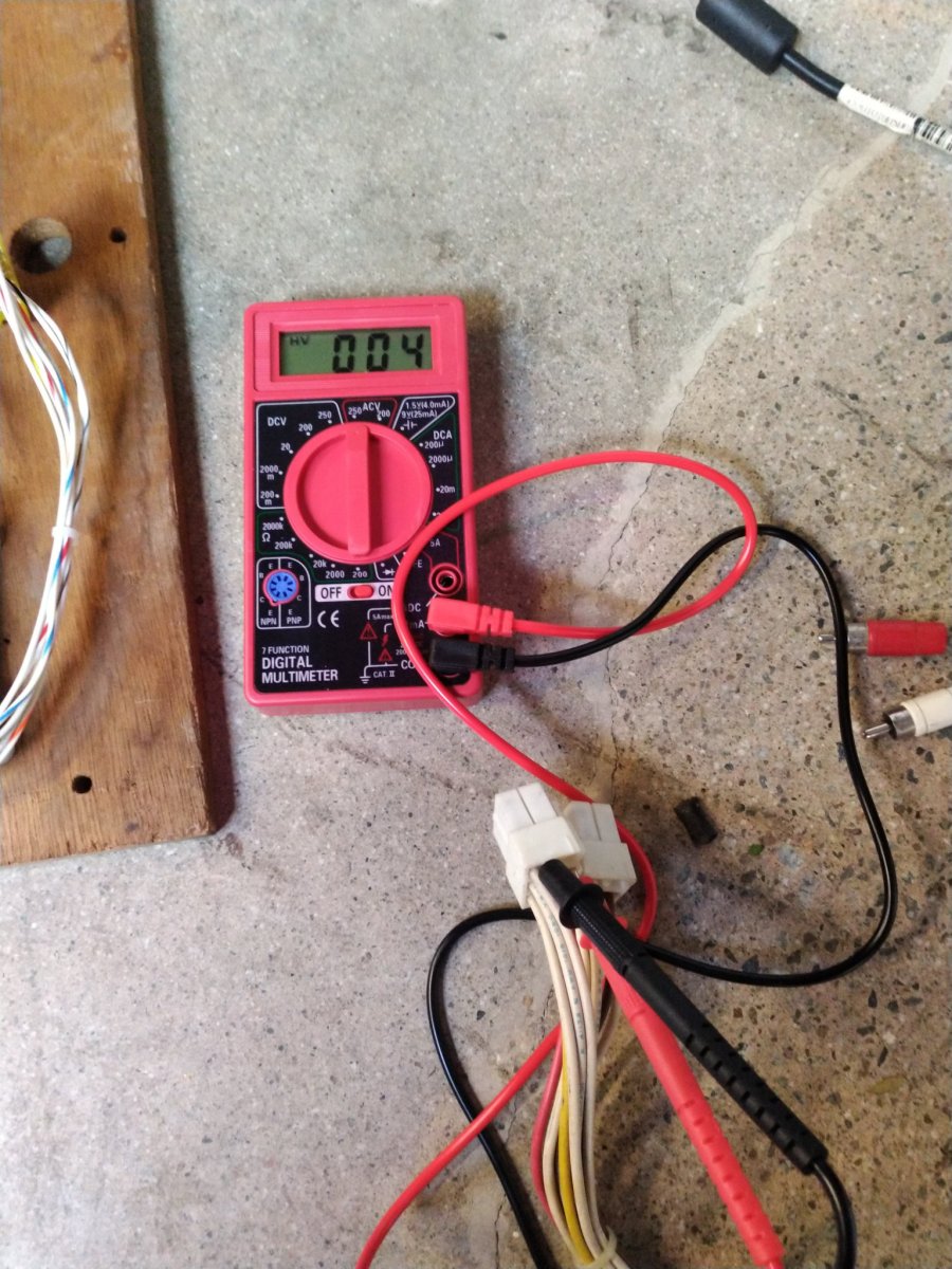

okay thank you i had a feeling i was off... the tutorials i was looking at weren't very clear.
gave it another go. sorry about that...
realized just now i only needed to check the first two pins on the 6pin and just the third on the 8pin.
so here's left to right again
6pin 1, 6pin, 2, and 8pin 3.

That'd be why you're not booting the naomi, your 3.3v is only reading at 2.26v :o
5v is over and your 12v appears to be VERY low.
3.3v and 5v have pots on the blast PSU, but there's no 12v pot. With the readings you're getting, while the machine is on, dial your 3.3v up slowly (turn to the right) to make sure you get to 3.3v and repeat the same process for 5v but instead of dialing up, you need to dial down (turn to the left)
I would dial those values first and try your stock psu, and if you still don't get anything, install the Sun PSU.
okay good news + bad news.
good news is the 5v is dialed back proper and blips between 5v-5.1v
bad news is the 3.3v pot will not go past 2.27v...

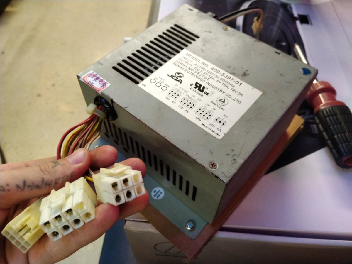

copy. so this is my sun psu.
i only see this smaller six pin connector on the back. is there i place to plug it in other than the blast io for testing?
these 2 connectors on the front are for the jvs to naomi i realize but what is the third one? first guess was driving games or other cabs that need specific power for other controlling options.
do other sun psu's have different connections to plug in elsewhere for easier testing or power options? (why mine only has the one. or is that normal it just has the one.)
