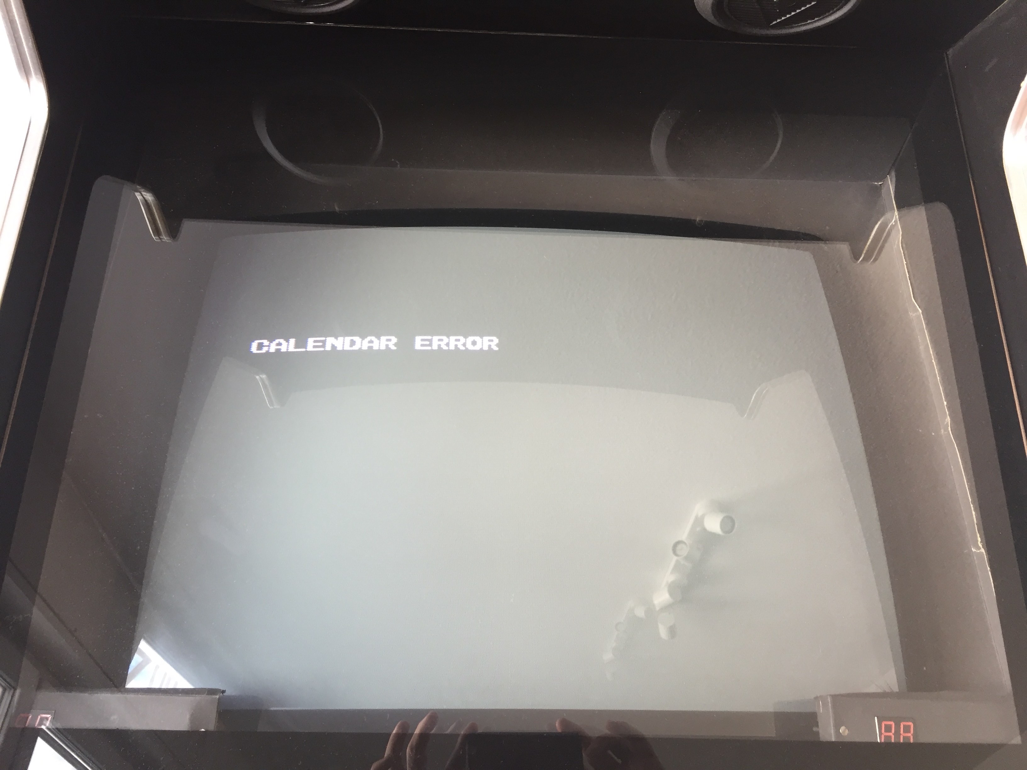

The board itself has an calendar error, you will see why :-D I'll document my work, so maybe it helps someone else. I'm by far no expert! I started with electronics at the end of last year. Just tell me if I'm doing something wrong!!

The good thing is, everything works as before. So I still get and calendar error. That will be my next task.

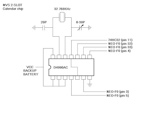

Here a short update. I fixed the calendar error and use the Diagnose Bioas to test everything (except the sound...)
I use the following resources to find the issue:
https://wiki.neogeodev.org/index.php?title=CALENDAR_ERROR
https://wiki.neogeodev.org/index.php?title=UPD4990
This way I tested every trace and noticed that pin 6 which is connected to Neo-F0 pin 3 had no contact. This sounds easy, but it was not. I hat to find and understand the informations listed above...
Then I also soldered the wire to pin 6 of D4990AC on the bottom side and I used a left over resistor leg and soldered a wire to it. I put it in one of the holes of the trace running to pin 3 of the Neo-F0 and soldered it into it.
I don't now if this is the way you fix a broken trace... I did it and it worked! Pin 3 was just a little bit to small and on top of the board, so no :-D
I started the Diagnose Bios with the buttons ABCD pressed and started the calendar test, perfect. Every other test parsed too.
