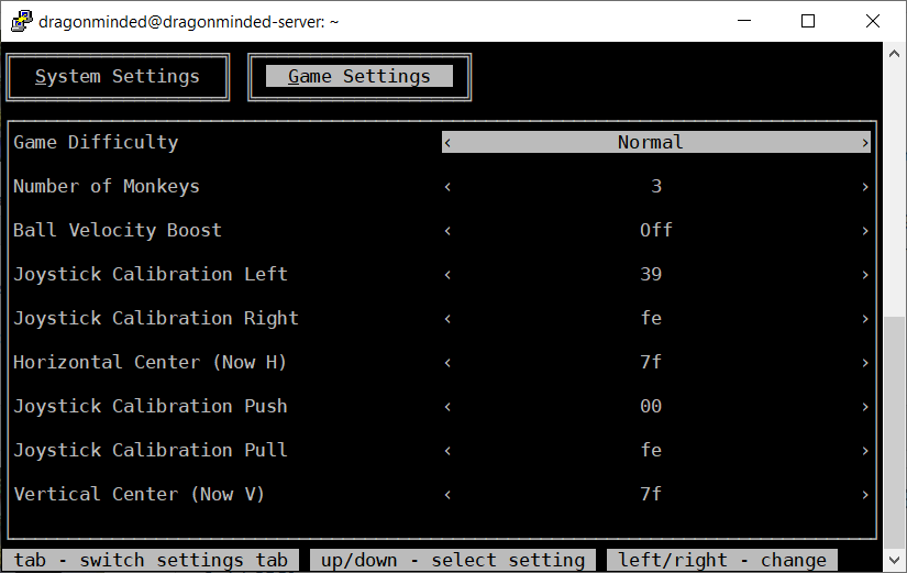

2) I've introduced a 2D accelerated sprite library for people that want to make games for the Naomi! It takes a lot of the pain out of using the PowerVR to render sprites by performing all of the texture calculations for you. It supports basic sprites as well as tilemaps (easy animation, easy 2D backgrounds and maps), and it supports arbitrary scaling and rotation of sprites. And, of course, since its using the PowerVR, you get hardware alpha blending and screen edge clipping for free. This is basically the underlying code that supports the netdimm menu, but with a handy and easier to use API. An example of how to use it is here: https://github.com/DragonMinded/libnaomi/blob/main/examples/spritetest/main.c and the documentation for how to use it is here: https://github.com/DragonMinded/libnaomi/blob/main/libnaomi/naomi/sprite/sprite.h and here is a video on my twitter feed showing capabilities: https://twitter.com/dragonminded/status/1472294607010553859

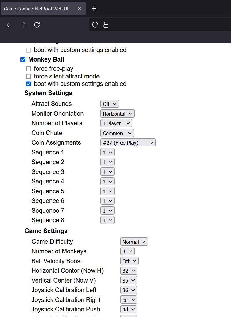

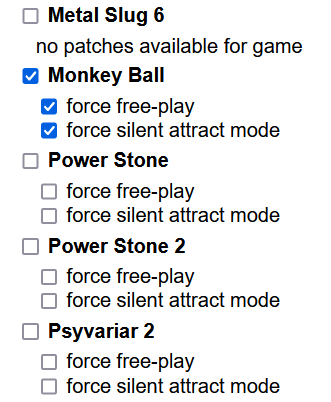

It's taken a while to get to but I'm starting to extend the support for the settings definition files into WiPi that allow you to set game assignments directly from DragonMinded's awesome on screen menu. I've also been playing with the SRAM backup and restore and have integrated it into the menu as an additional option. The way it is designed to work is that when the menu is loaded from WiPi and the option is enabled it will back up the existing contents of SRAM and as the menu doesn't use SRAM that will should be from the last game played. This gets sent back to the pi and stored in a file - as the pi knows which game was last sent either over wifi or from the menu it gets named as such and then when the game is sent next time the correct SRAM file is restored via the menu to the Naomi.
This works well with the on screen menu but it would be a bit clunky to integrate with games sent over wifi, the issue is the SRAM backup and restore uses a helper function that is netbooted so you would have to manually backup and restore or you would have multiple reboots while the helper rom is netbooted, SRAM backed up, reboot, game sent.
The current list of definition files including the ones provided by DragonMinded is below, I've also discovered some games that seem to be using SRAM as settings backup, similar to Ikaruga.

If anyone is interested in helping out expanding these files please get in touch, DragonMinded already has extensive instructions on how to follow the process, it's quite straightforward once you've done a few! I've made some notes here that might help: https://docs.google.com/document/d/1__oN7OJnScly9HXPmdzdBNziJIAvkfdqqEyHkVo7zqU/edit?usp=sharing
