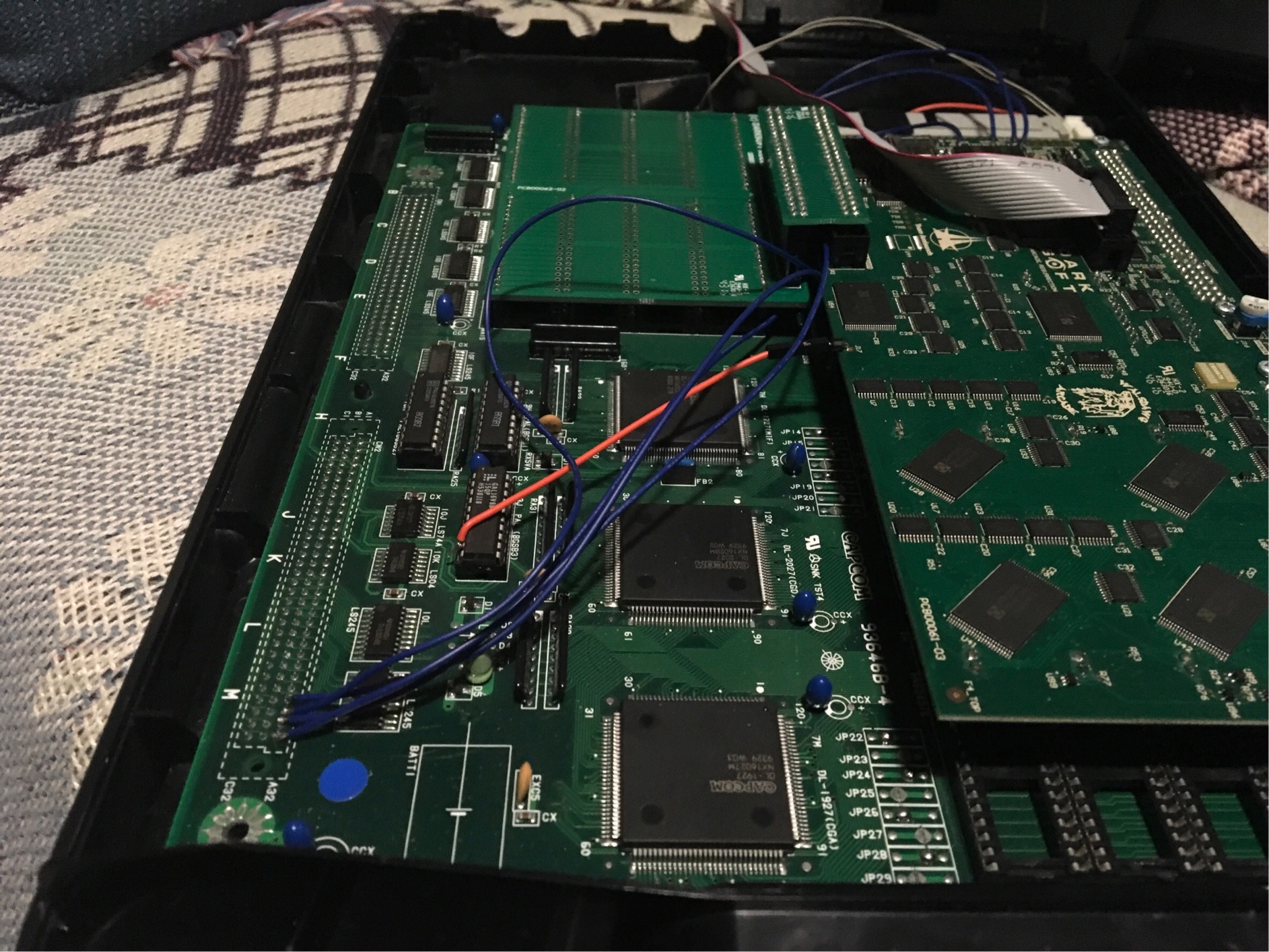

Here you go mitsu. Ignore the orange reboot wire. It is unsoldered but I left one end connected to the side in case I had to roll back the firmware. Going to remove it tonight once I reload my sd card so I have Progear Red again.

Finally got around to updating the bootloader and the firmware today, which allowed me to install the harness for key-writing firmware. :D Overall, everything went fairly well, although I did have a couple of scares when I realized I had mixed up the SETUP wires, and when, during firmware updates, the board failed to restart - despite having a reset wire fitted - but the firmware updates seemed to take to the board just fine.
Kit seems to be working nicely, and I can run encrypted ROMs... as soon as I get a replacement floppy cable, since I accidentally destroyed the original. X/ I'm stuck playing decrypted AvP for a while. :thumbup:
Thanks to @ekorz for hooking me up with the harness, and thanks @ShootTheCore for lending me the programmer. Couldn't have done it without you two!
And, of course, thanks to DS & Mitsu for producing the kit, and thanks to everyone else in the community for their contributions!

I have someone else that it doesn't work on their -4. The pictures all match what you guys are posting here. I wonder what causes it to not work?
Check out this post from @undamned regarding his findings: CPS2 Desuicide Troubles On Early Rev Boards
I did keep that in mind. We did it with wires just long enough for them to reach from the multi to the CN2 connector. I tried with and without the resistor. If the resistor is installed do we still solder the wire to pin A32? That's what I did and it did not work.
On the version 4 board mine was originally a Super Street Fighter II: The New Challengers and it had a riser board that you normally don't see on the cps2 b boards. My kit was also one of the later batches since I got it around April last year from Paradise Arcade. Doubt any of it matters but wanted to mention it if helps to isolate any requirements for the version 4 b boards. I did have to send it to you last summer (bad pal chip) and besides for reflowing my jumpers and swapping out the pal I don't think there was anything special on my b board.
I was able to update the firmware and didn't have to add the resister. I have pic a few posts back. Hope that helps.

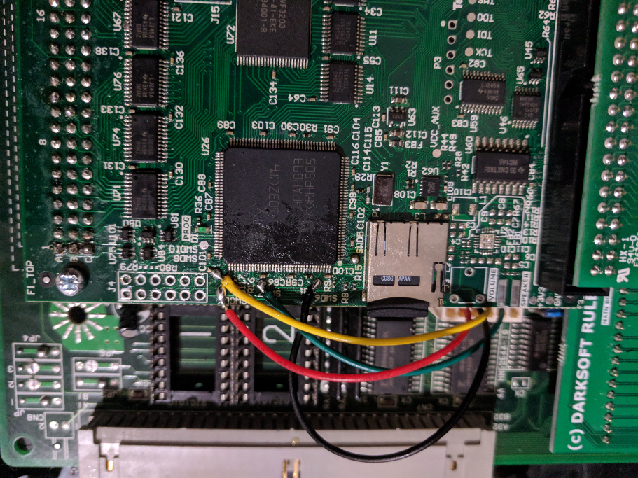

Finally assembled the Darksoft CPS2 kit with 4 wires soldered to take advantage of Key Writing after updating the firmware.
Added my games so the root directory is just Games folder then it's the majority of MAME rom folders and a few hacked rom folders. The output gives me a pink/purple screen and there's no text on my LCD.
Any suggestions on how to fix this, I'm hoping it's as simple as sorting out the files, if it is super bad.... is there a service that can fix the issue?
