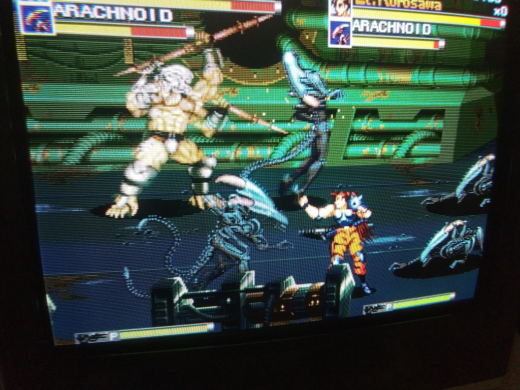

Did you finally get it working?Yeah see my post on page 9Has anyone with a -3 or -4 revision B-board actually got the key writing to work yet? If so I'd like to see. I've tried twice with no success. I'd like to see pictures of it working if anyone has them. I've had zero problems with -5, -6, and -7 pcbs.![]()
It's a 93646B-3 board.
Yeah I just had to reflash the bootloader on the CPS2 multi again. No problems after that.Did you finally get it working?Yeah see my post on page 9Has anyone with a -3 or -4 revision B-board actually got the key writing to work yet? If so I'd like to see. I've tried twice with no success. I'd like to see pictures of it working if anyone has them. I've had zero problems with -5, -6, and -7 pcbs.It's a 93646B-3 board.
