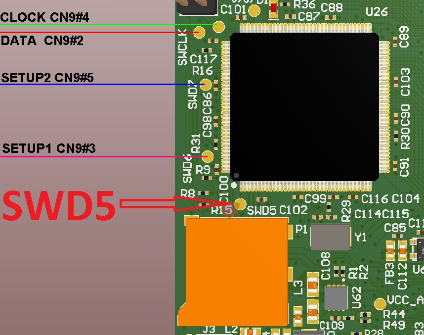

Oh, I didn't realize there was a different install method for older kit revisions. I think that I have the original version. It has had the audio fix done by Mitsu, and the latest firmware (pre-key writing, that is). Can you tell which install method I should follow based on this picture of my kit?

please tell me exactly what did you change and send a pic of your setup. Did you remove reset from swd5?
We'll solve it. No worries.
If anyone has a pair of spare connectors to get this working, let me know. Happy to throw a little extra your way for the effort.
