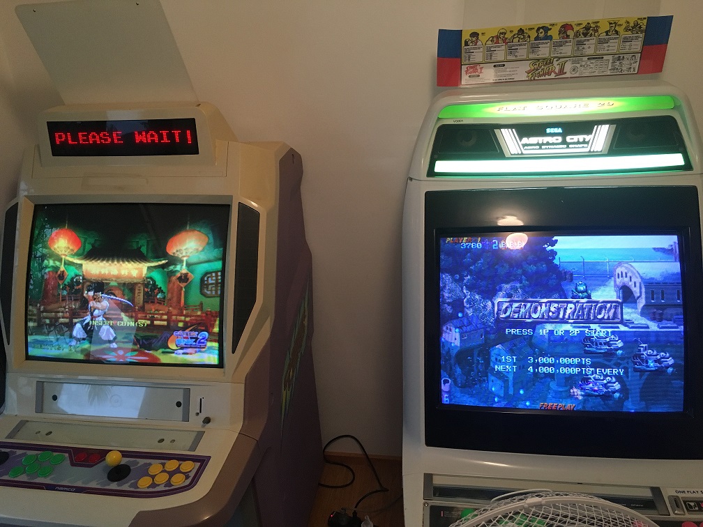

I just installed the wires onto my multi kit and connected up the CN9 connector, pulled out the microSD card to load the new firmware onto and..... the first card reader I used decided to kill the microSD card - it now doesn't read as anything and tells me to format it, then tells me it can't format it. I put it in a different reader on a different computer and dead. :(
So for now - here is a photo of my new wiring installed and I am going to get a new microSD :)
Edit: Just to make life more interesting my computer now won't read the microSD card properly (Macbook Air - Googling suggests this is a known issue) so I'm going to have to get an external reader at some point >:/
Further edit: Never mind, found another card reader, got the multi flashed and the rollup pack loaded - Progear now running on the multi and I installed my NAOMI netboot setup back into the Cyber Lead with the new power wire I made today, it's terrible outside (storms all weekend) so I've got an excuse to play some games :)
