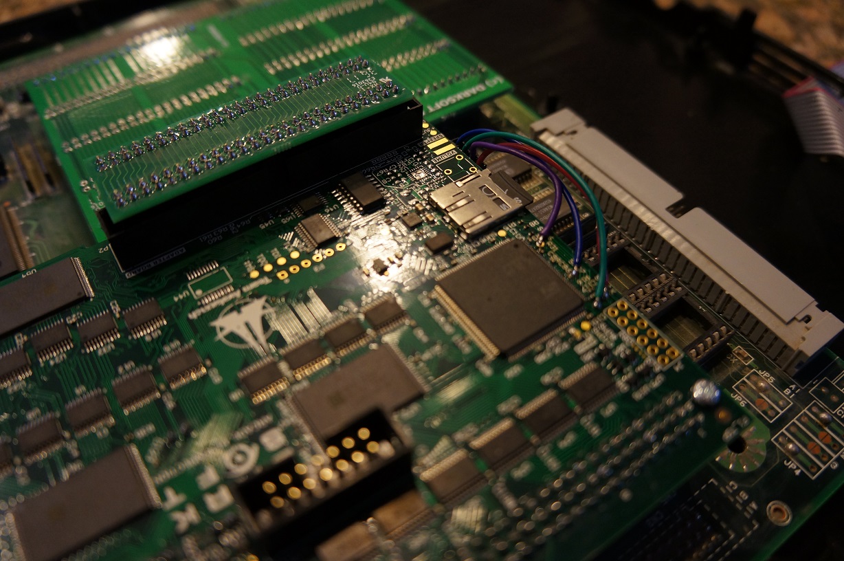

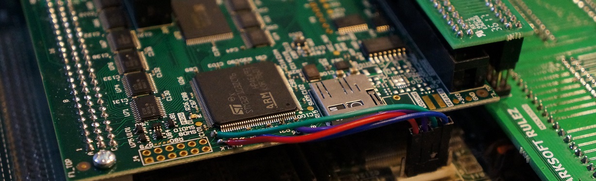

So, at last I am getting time to do this to my CPS2 kit. One question though: I have found online some JST 4-pin 1.25mm female connectors for cheap. Are those the right ones for connecting the multikit to the B board?
Thanks!
The connector on the B-board actually has 6pins, but because pin 1 and pin 6 are unused (at least on my revision) I was able to use a 5pin connector with one pin popped out and one pin left outside the hood (only making contact with pins 2/3/4/5).
I suspect you could do the same with your 4pin connector.
It has six pins because the connector is rigged in a way to allow Capcom clerk to conveniently power the B board with just the security writer box. The unused pins (on CPS2 multi key writing cable) are exactly GND and +5V supply, which the Multi doesn't need to attach to because it's already connected to those through the board main bus connectors...
I've ordered some JST 4 pin sets (Pin Pitch: 2.5mm) and I think they are a bit too small, it can go through the CN9 pins halfway through then it gets super tight to the point that forcing it down may break the PCB.
Anyone got a UK link that sells the correct size JST pins with wires?
Perhaps, one idea is you buy the proper six pin connector and mount only the four middle pins with wires...
you want the JST NH series connectors for this
That's one of the problems I'm having. There are no results when I am searching for NH series.
The one I had was the XH series but turns out to be too tight. I'm just posting here to get some help before I purchase a product with holes that are either too small or too big. ;)
