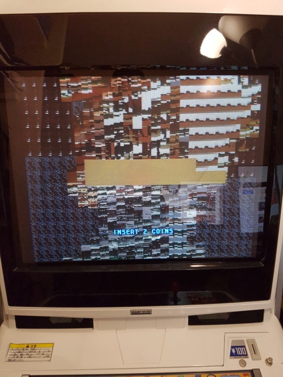

Not, I have same issue with other mb. All other game run except sf 3.3your motherboard is probably toasted, I have seen this once before by improperly connecting the data cable to the CD room
I know your not using the CD room but by having a loose or improperly connection and giving the board power you kill one of the chips
have you tried running a game with regular SIMM's?
Issue with SIMM6 slot I guess,
Yes it's working.Does 3.3 work with regular SIMMs and a SuperBios ?
