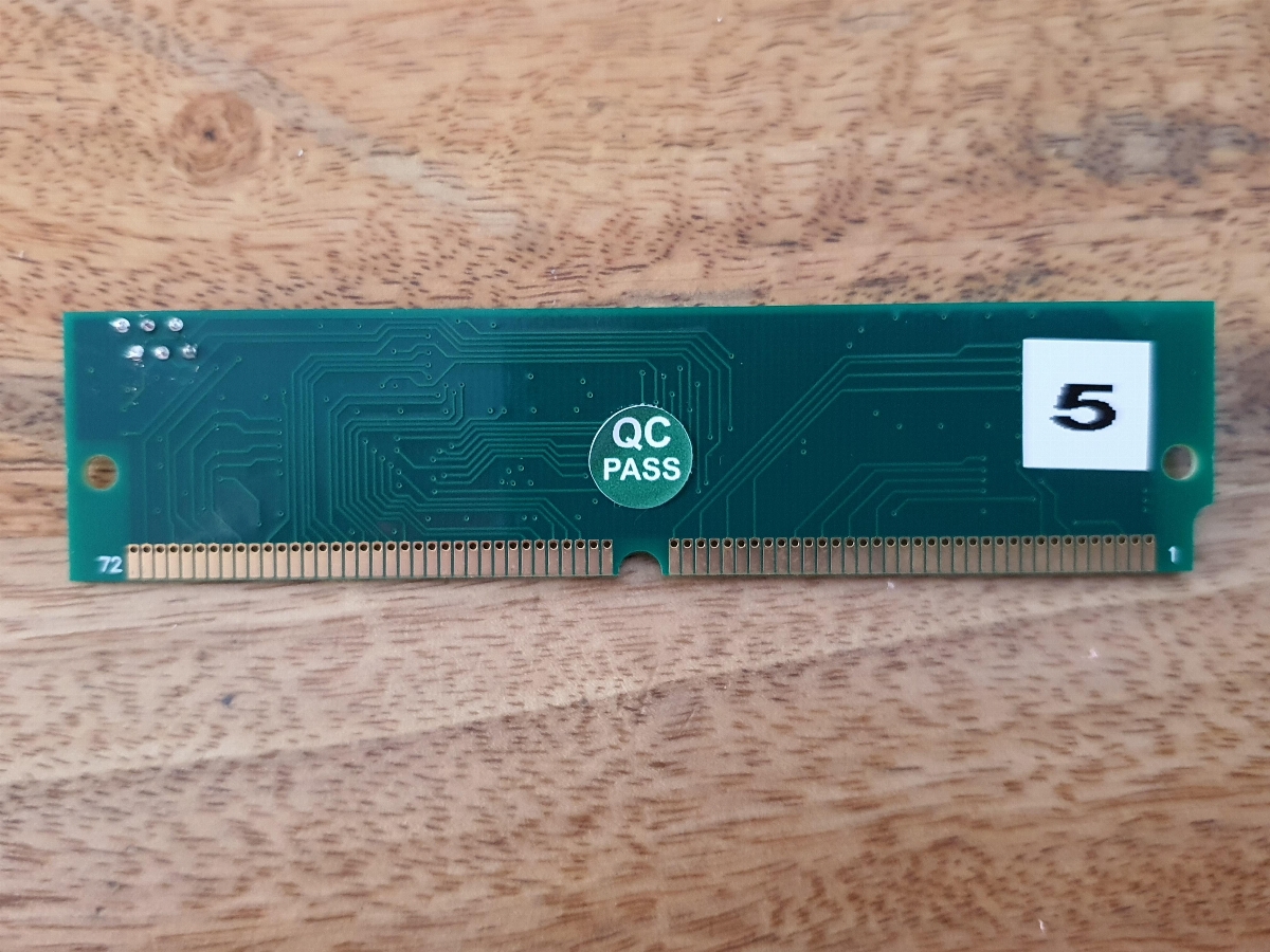

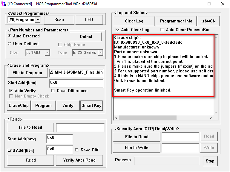

Hi all, I've tried searching the respective CPS3 Ultra Simms threads but couldn't find any comments about if anyone has experienced this issue before?
I've purchased the programmer to write Ultra Simms for @DRAGONKZ. Followed the instructions as highlighted and unfortunately came across the error as per the screen shot above when I was writing what I labelled as SIMM5.
Up until this point I had successfully written the 2x 64mb SIMMs (U9 and U10), SIMM3, 4 and eventually SIMM6.
I thought it may have been the file, but I confirmed that I could write the file to "SIMM6"
I've confirmed continuity between the ribbon on the programmer and simm
Outside of that, there's nothing else obvious on the SIMM that I can see for it not to error out the way it's erroring out.
I think there might just be a possibility this simm isn't working as expected.
Some other details:
OS: Win 10 x64
Application used: NOR062_Beta_A.exe
Programmer Version: 0xd2b5063d
Things done:
- I've unplugged and plugged the converter on the programmer multiple times (I don't believe it's the programmer as I've successfully written the other 5 SIMMS)
- rebooted the pc multiple times
- Reseated the simm multiple times
- Cleaned the contact with IPA
Any other suggestions are welcomed TIA.

Just tried it, unfortunately the same issue. I tried varying different heights and it's all the same.
Also tried just "erasing" or "programming" and both yielded the same error.
Code:
<Erase chip>:
Manufacturer: unknown
Part number: unknown
1.Please make sure chip is placed will in socket.
  Pin 1 is placed at the correct point.
2.Please make sure the jumpers (if exist) on the adaptor board are correct.
3.For unsupported part number, please use self-defined parameters.
4.If this is a NAND chip, please use software and adaptor board of NAND Flash.
Quit. Erase is not finished.
<Programming data>:
Programming to address 0x0.
No auto-verify when programming failed.
