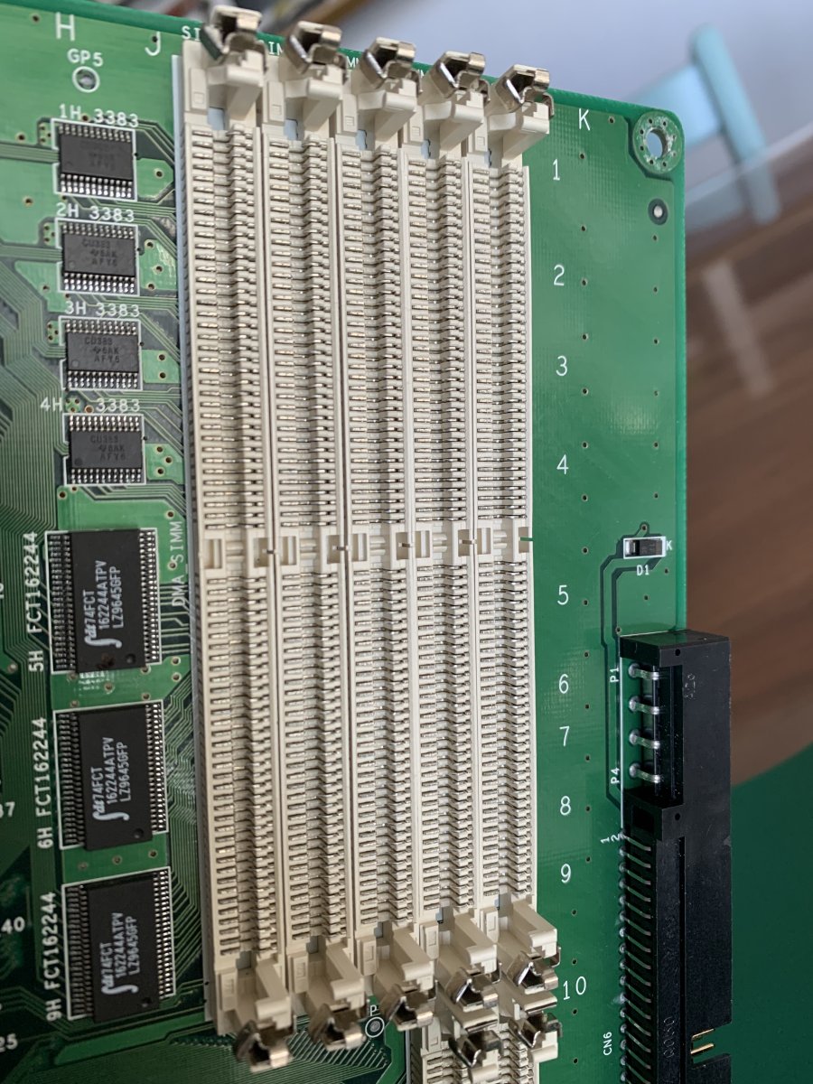

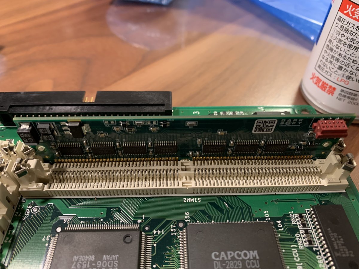

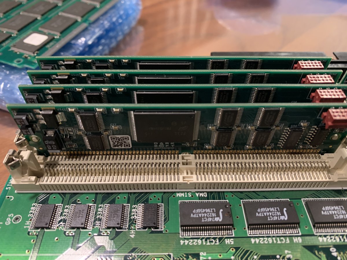

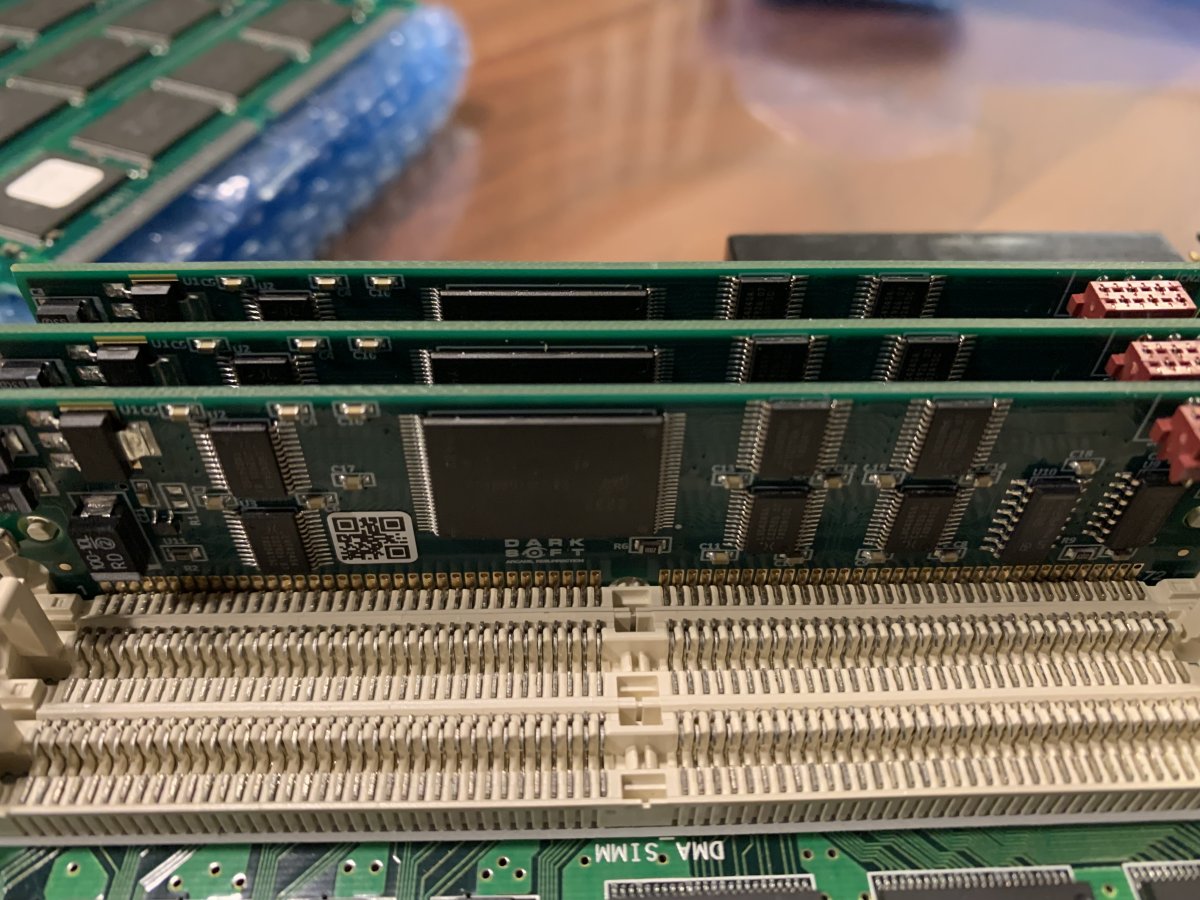

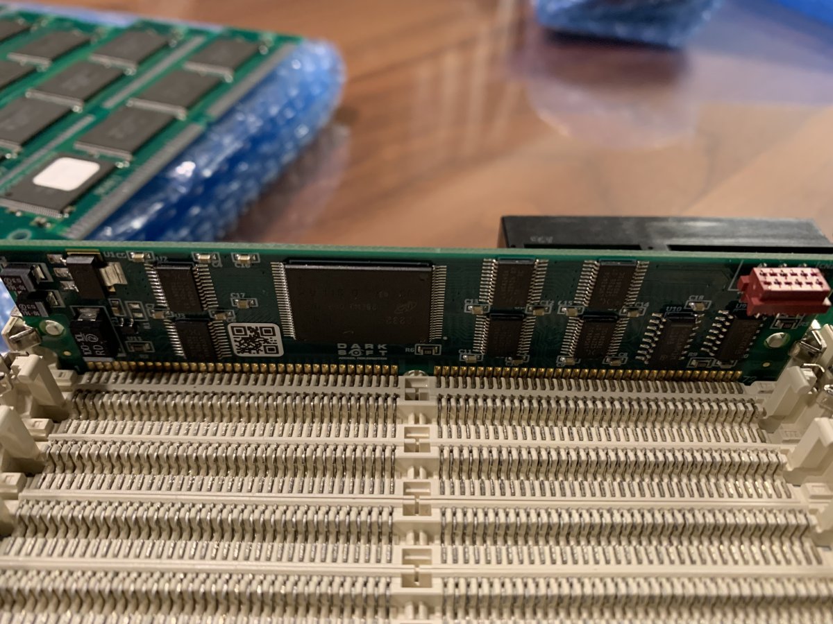

Yes if I check some simms in their slots. The pins are not completely in line. Tomorrow I will try to take a picture of it

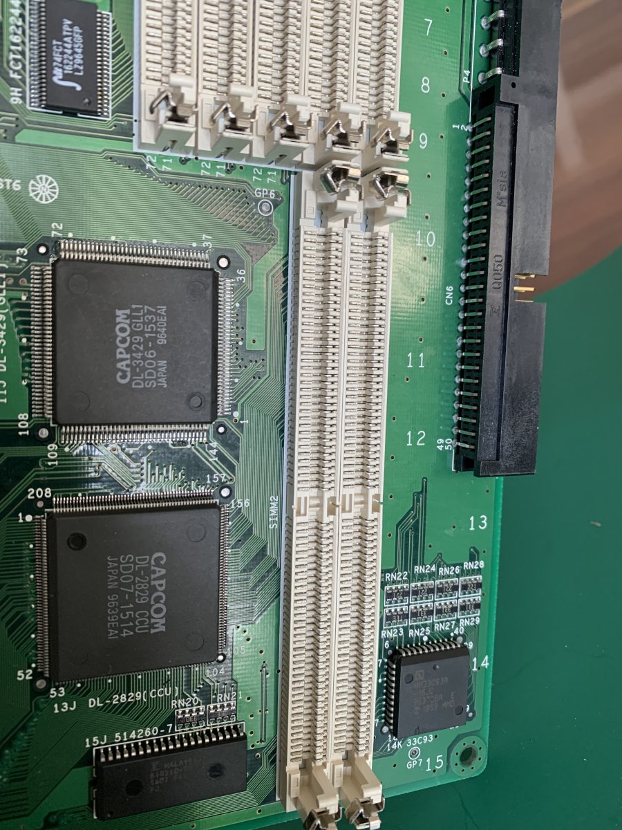

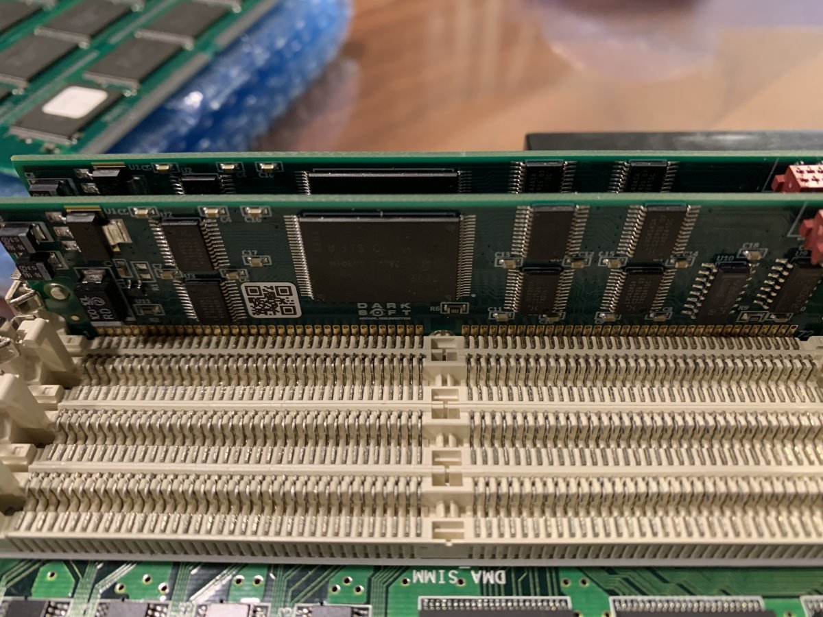

I thought the pins were not perfectly in line could be a problem ?

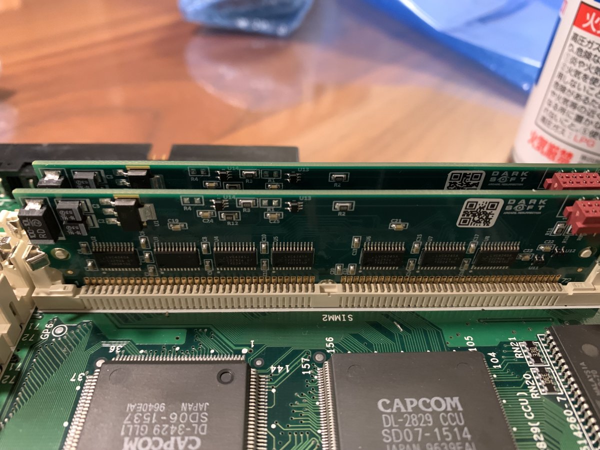

I tried to clean up with contact cleaner the simms slots and it is much better. It is not perfect so I am continuing this way

Do you have some tips to clean up efficiently the simms slots ?

Flux or alcohol isopropyl shoukd work. Try shifting the simm to one side and see if the pins align better.
