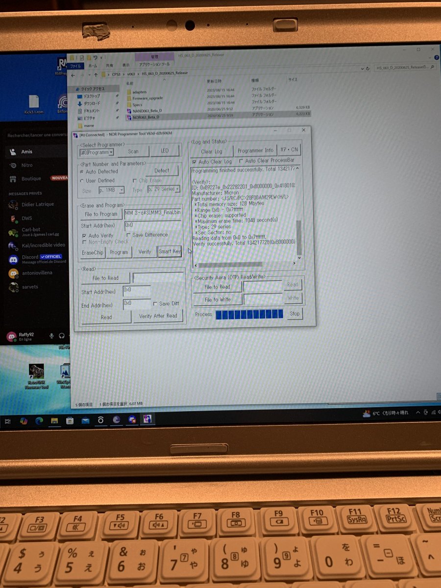

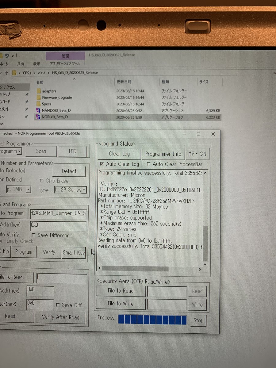

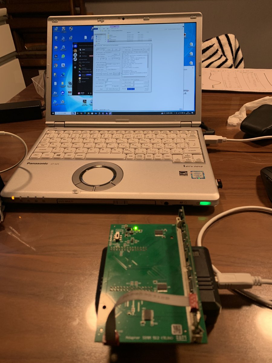

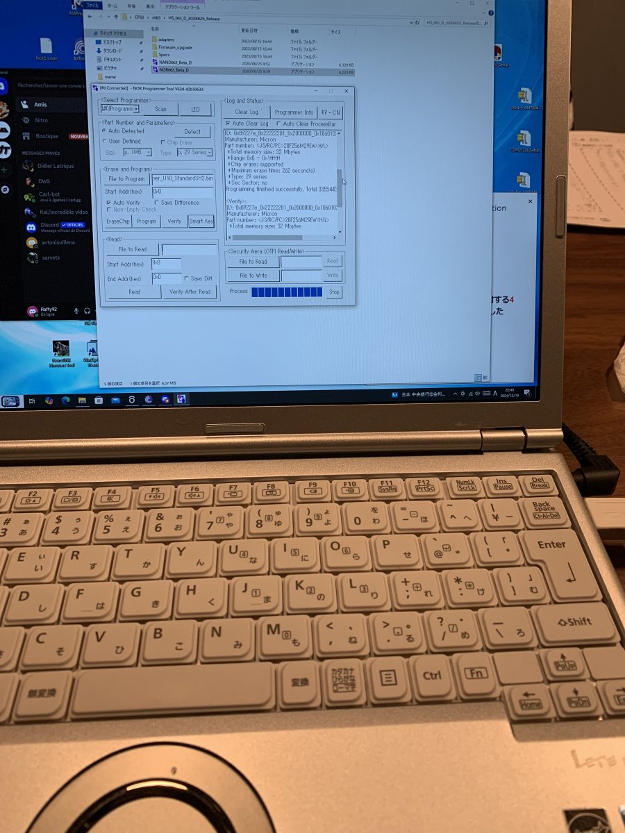

I did every things you mentioned. It was clearly and well explained to the manual. The only thing is maybe the soft version v63. I used the v62.
Thanks
hi, I tried the v63 and nothing better
Is there some odd things ?
