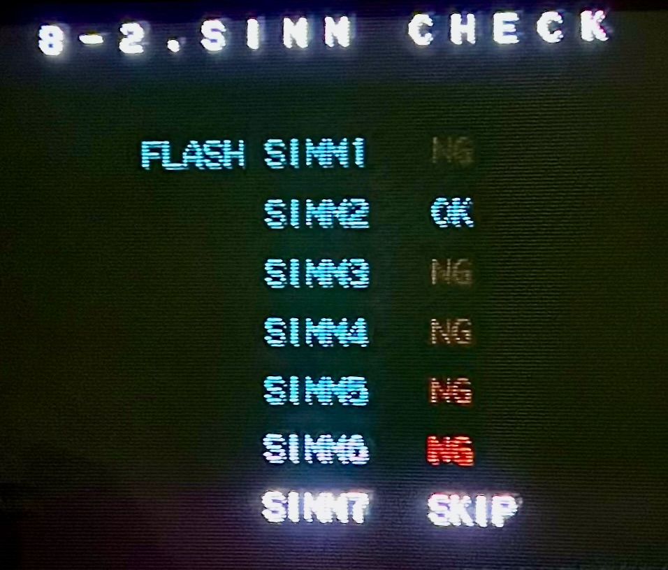

I finished programming the Ultra Simms, tested all the games and they seem to be running well.However all but one of the Simms failed the SIMM check . Is this normal?
