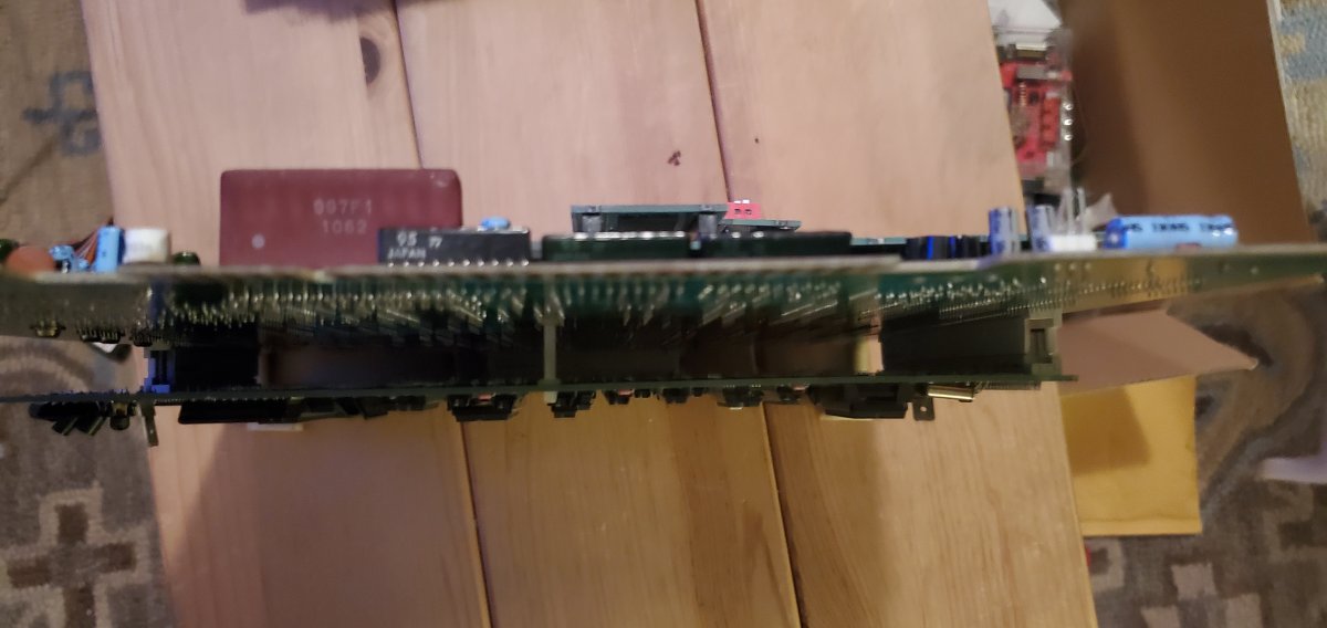

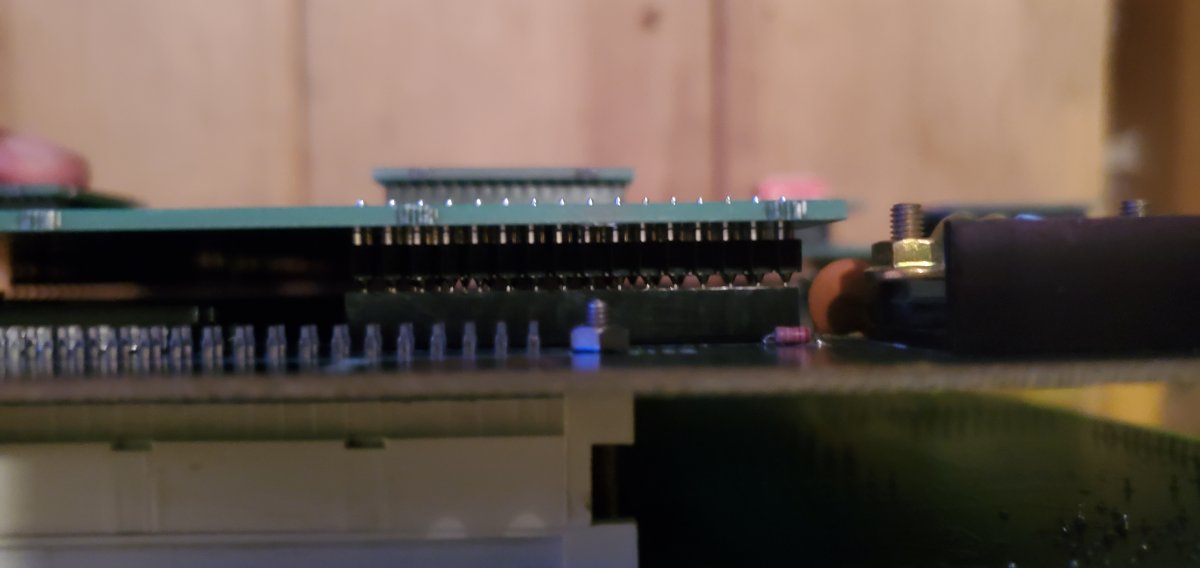

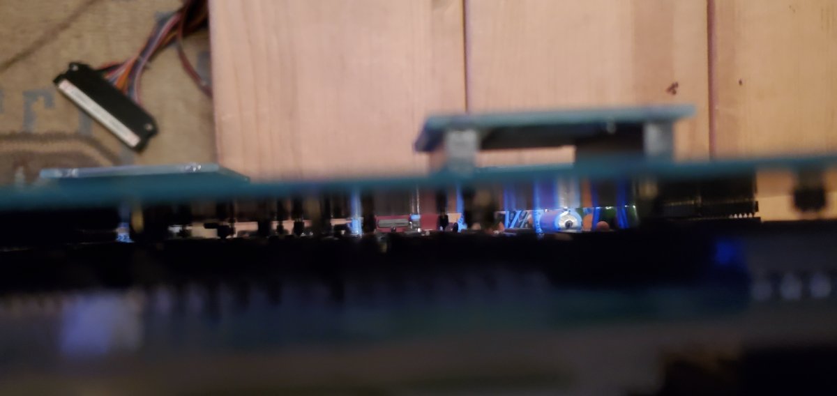

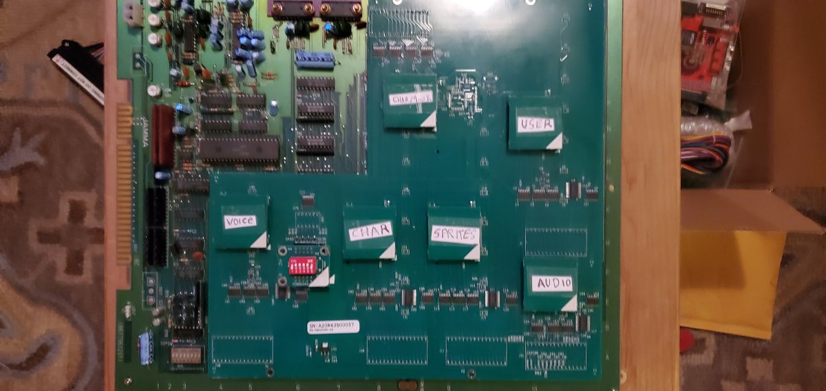

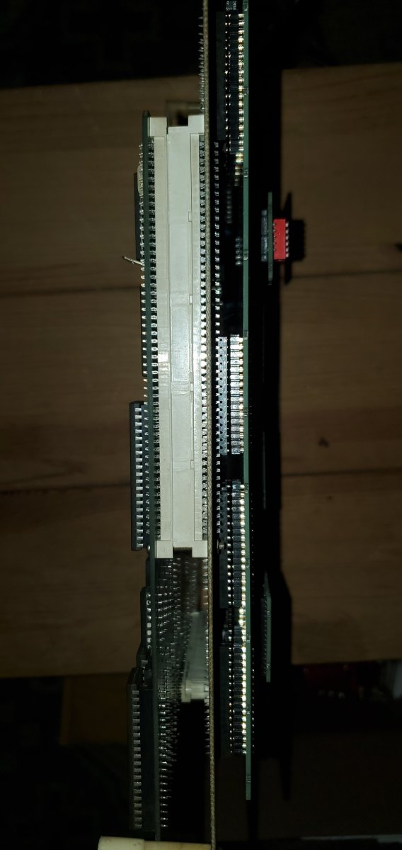

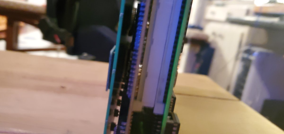

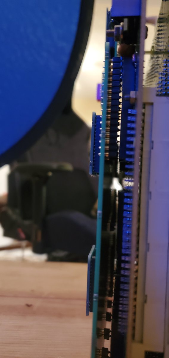

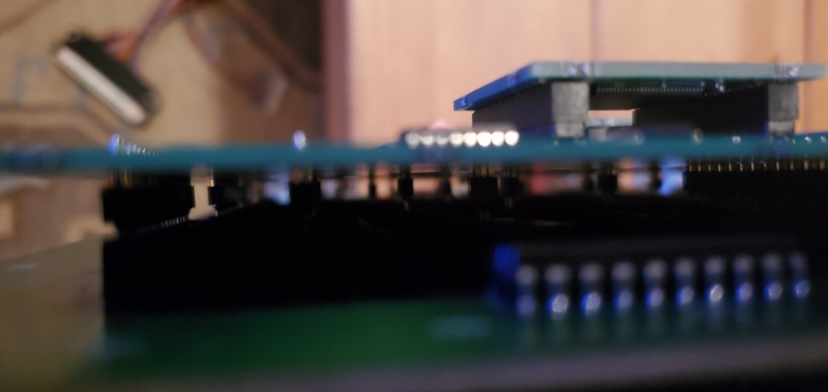

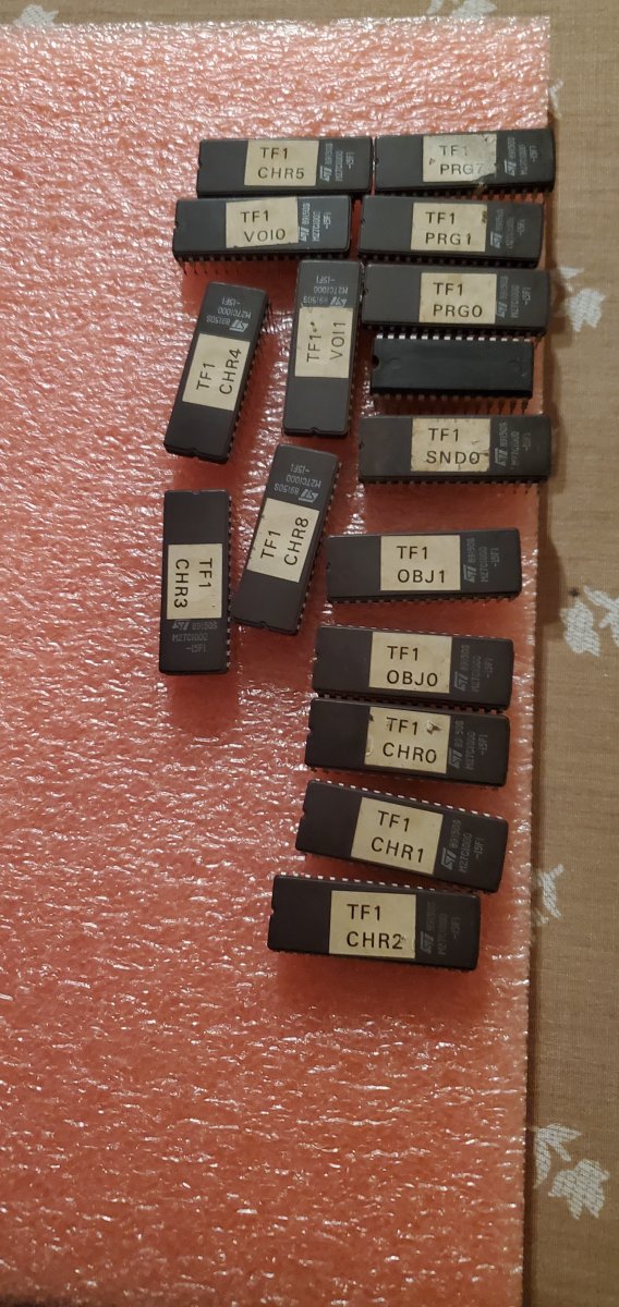

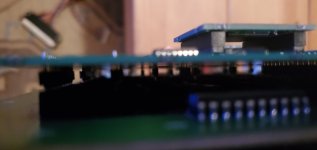

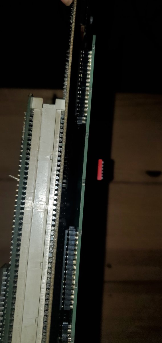

I just finished installing the Multi, however, when I power it on...I am only getting a black screen...am I doing something wrong? I thought it had something to do with the SEEQ chip, and I placed the Excel chip, however, nothing and still having a black screen.
Can you post a couple of pictures of your setup, how the multi sits, etc. Did you remove all the memory chips and the Keycus?
I followed a tutorial on youtube and removed the ones necessary, minus pal and something else the person mentioned. Also I should mention that the game I used was tank force, and I also made the sure jumper was according.

I assume the the memory modules are programmed properly, right?
It looks to me in one of the pictures that the multi doesn't go all the way in. I would try pushing them gently until the pins fully go into the socket.
I made sure that the modules were programmed properly, but I also did a test by putting the original game back inside. I will try reseating the board.
when I put the original eeproms, keycus, the board works fine....so would this be an issue that maybe I programmed the modules incorrectly...even though I believe I did them correctly. Should I reprogram them? If it is the module situation...how would I go about erasing and re-writing the modules? or can I just immediately reprogram them? Thank you
