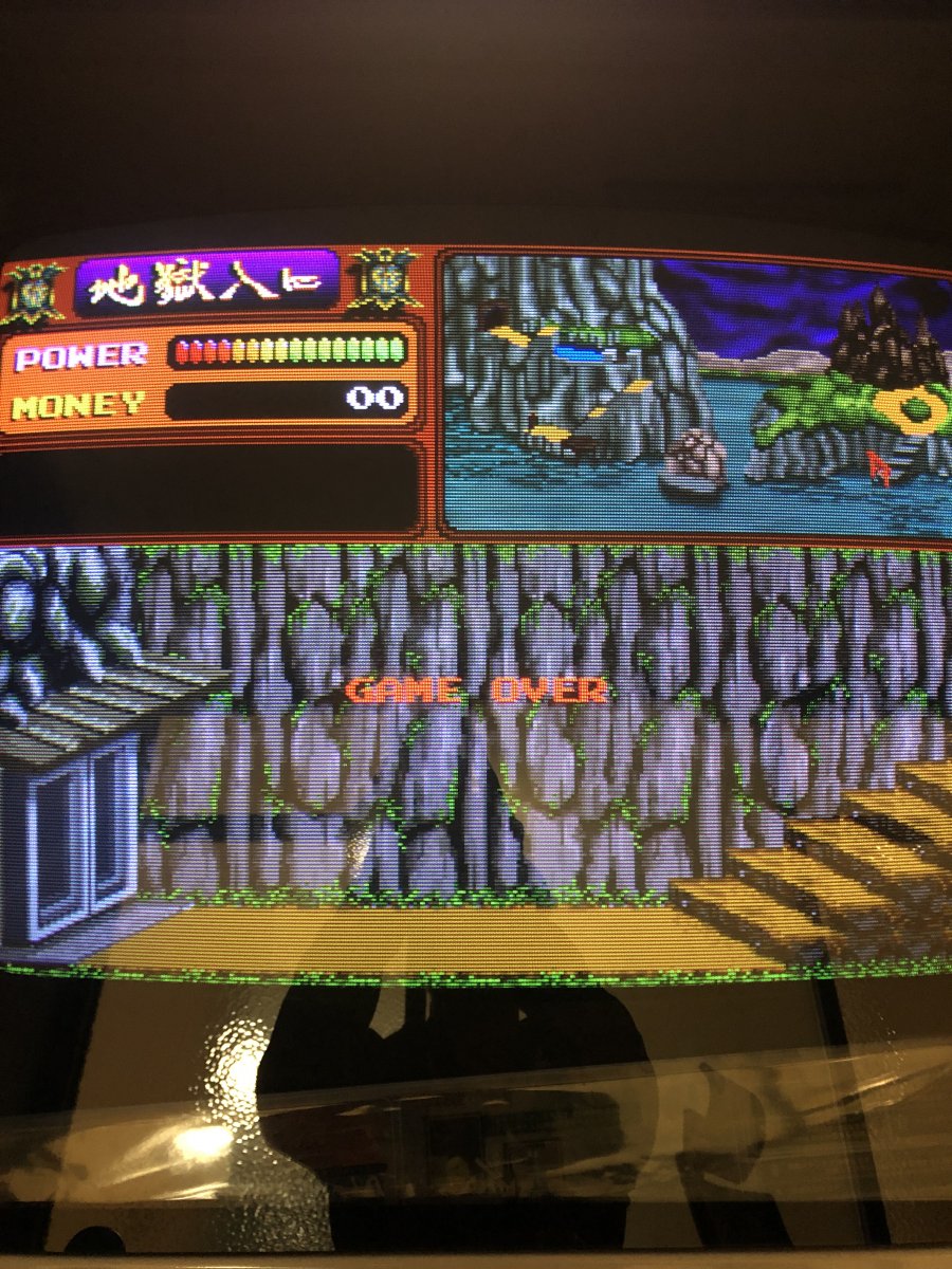

Sorry for late posting.
This is Shawdowland (YD3) with character and sounds.
This screen shot is for both Yokai Douchuuki(YD1 and YD2).
As you can see, there is no graphic for character and enemies. But I can hear sound effect and bgm.

Looking at the photo, it looks like the sprite isn't showing, using the ROM SET before January 7th.

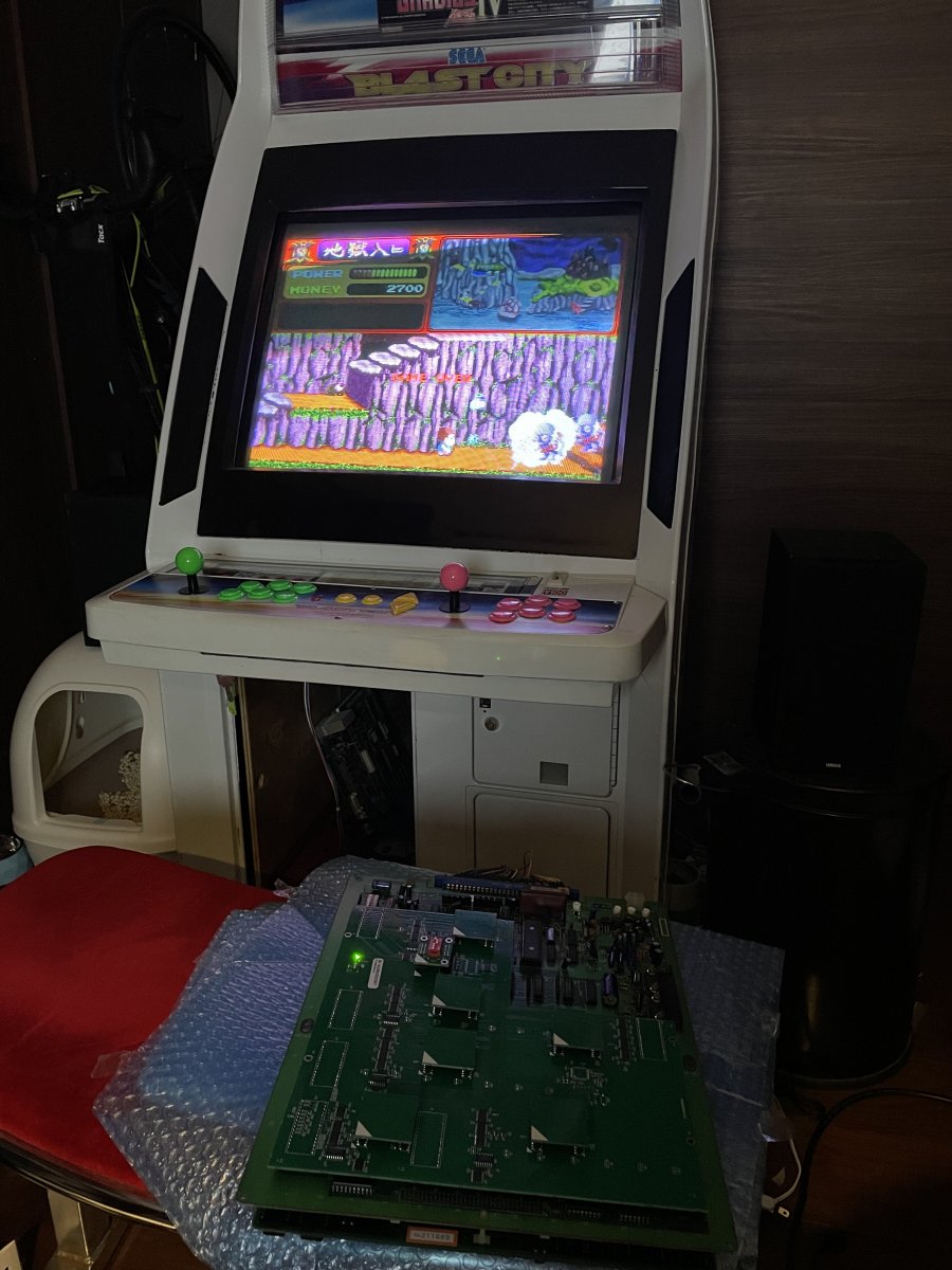

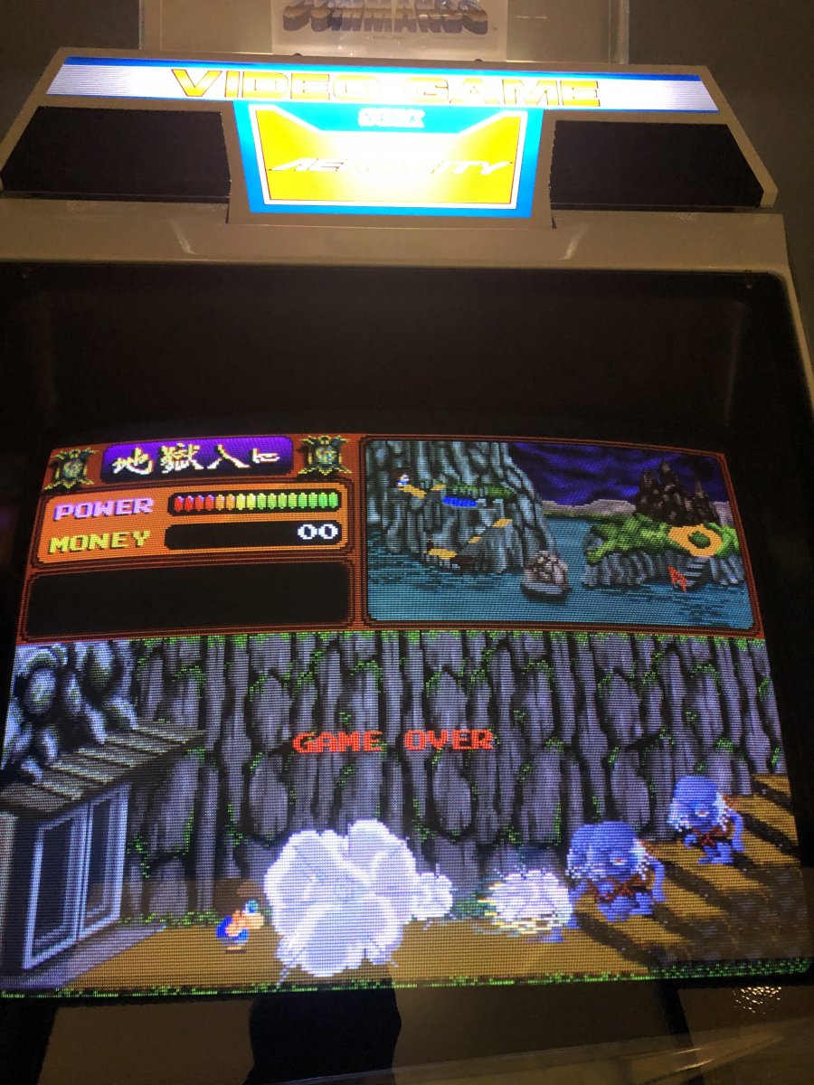

I confirmed Yokai (both of YD1 and YD2) is working perfectly with EXEL ROM at U1.
Thus, you don't need to replace it to SEEQ ROM.
Please remove your Voice ROM gently from your darksoft's multi board and turned on the power and wait few seconds then turned off.
Now You can install Voice ROM and play without any garbage.
