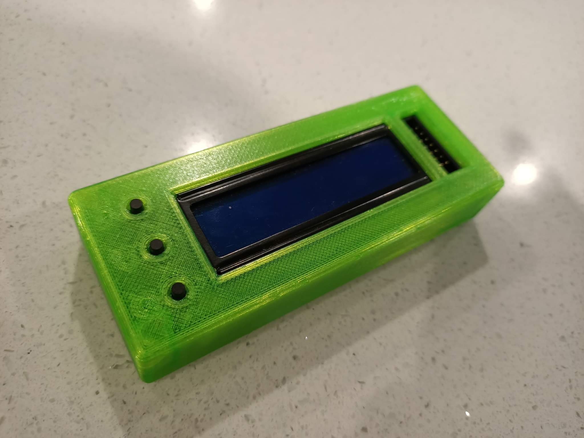

PETG green filament, CPS2 LCD holder. Not bad for a first attempt at printing PET.

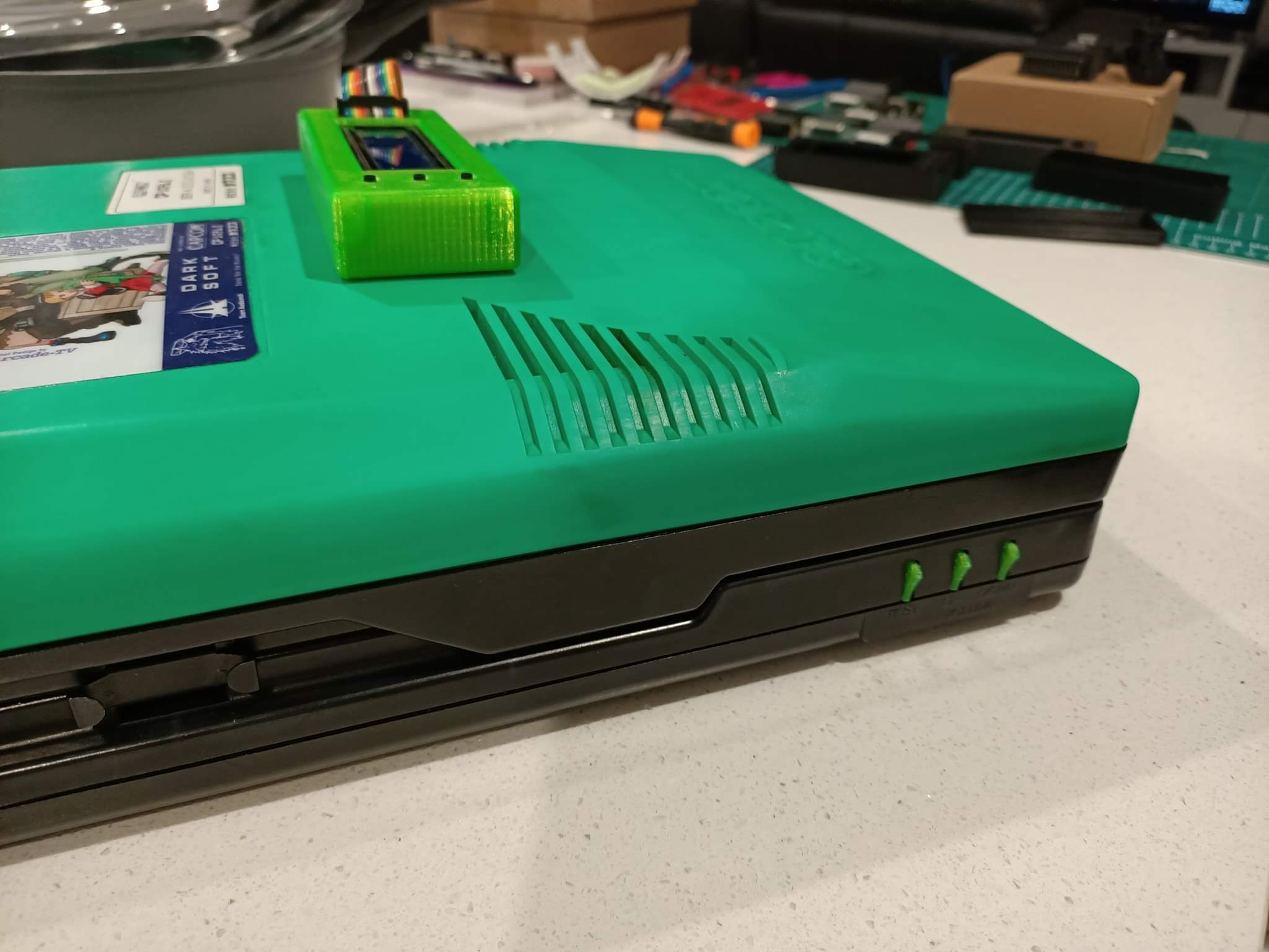

Printing a set of CPS2 A board buttons with the same PETG green filament. Thinking it should match my green Japanese B board shell nicely.

Matching buttons. Time to put it all together and see how it looks....
