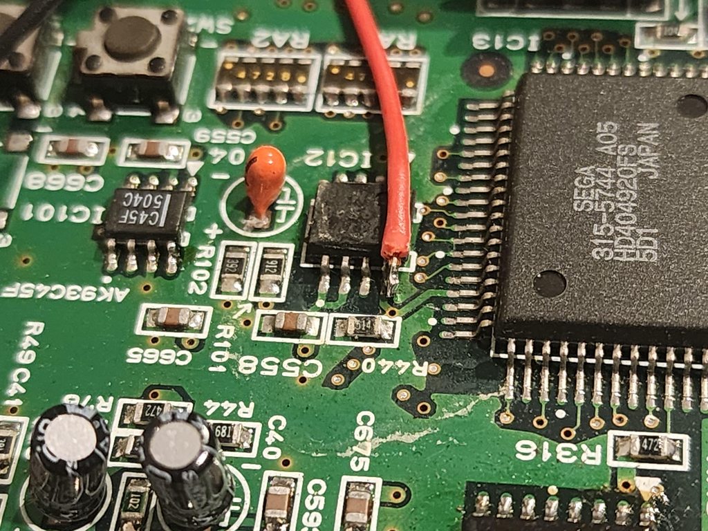

Got the STV dark knight multi today to install for @DRAGONKZ and I'm not having the best luck with it unfortunately.
The ST-V was confirmed operational with Virtua Fighter Remix
The install looks like this
The reset and audio points look like this (as I understand, they're both optional anyway)
I formatted 3x MircoSD cards to FAT32 and ensured they're primary partitions. I copied all the contents of the ST-V Dark Knight roll up pack so there's a /games and /sounds directory.

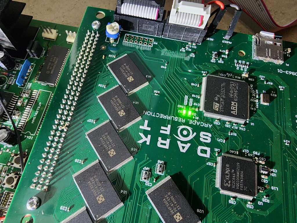

When I power on, I get the nice logos made by @opt2not and I can cycle through the different games, but when I press select, nothing happens. Another LED turns on the moment I select a game as can be seen in the video below
View: https://www.youtube.com/watch?v=iA5z5p1mjp0
Jumpers are configured as below
I've updated to the latest f/w. I had the flash.img in the root directory, then the led flashed really quickly and then the flash.img file disappeared off the sd card, so I believe it flashed as expected.
Is there anything else I should be looking for?
The second light indicates that the game is being written. Once it’s finished the light will go off indicating the game has finished flashing.
You should hear an audio file play when the game starts loading and then once again when it’s finished; if you’ve set the SD card up correctly with the audio files.
The only thing that springs to mind that could be an issue is if you lifted the pin from the pad on IC12. I had that happen with my install and it caused exactly what you’re describing. It can be pretty tricky to make contact of both the wire and pin on the pad.
What's the baseline for the time to be written? I've left it on for 10 mins and it just sits there with the second LED turned on. It doesn't flash, it doesn't turn off
No audio is heard unfortunately. There is a /sounds folder with an end.wav and start.wav file but nothing is heard through the mono speakers

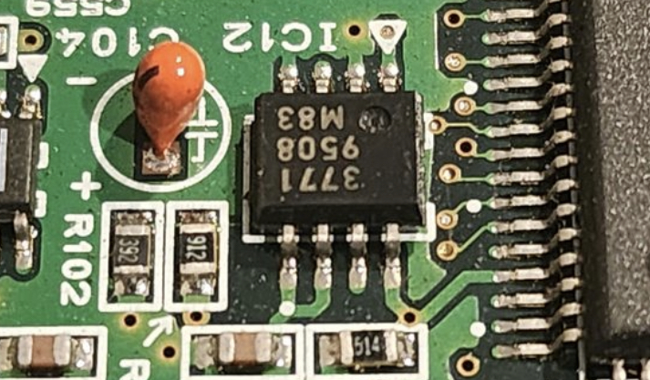

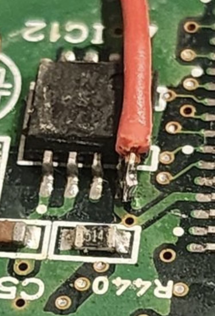

I've checked and confirm continuity on the pad and wire and it's definitely not lifted. A fair bit of flux was put on pin 8 of IC12 to help prevent lifting the pad.
There's continuity between the Reset pad pin 8 and reset pin on the multi. The same goes for the audio component.

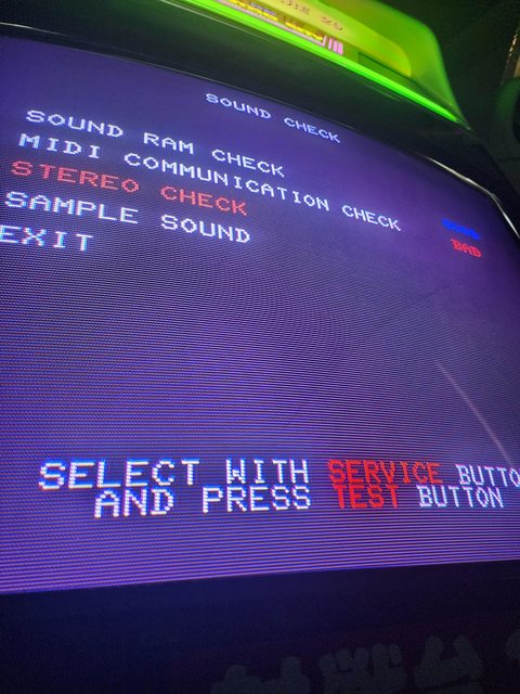

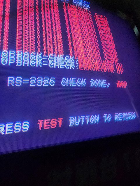

You can also keep pressed the service button before powering up so a special service menu will show up and you can test the motherboard. The fact that it worked with one game doesnt mean it's working well. I've seen it too many times.
I've gone through the whole test and these are the screens I got with errors, not really sure what they mean though atm
Loading shouldn’t take that long.
Try removing the audio files / folder off the SD to see if they’re causing any issues.

Re: IC12. It’s not the reset wire that’s important. It’s that the pad of IC12 is making solid contact with the pin. I thought mine had continuity also, but realised it wasn’t after trying carts when my multi was showing similar symptoms to the ones you’re experiencing.

How did the sound test go on the board? Also what are your voltages like. Can you try another cab / Supergun? If you’ve got a blank 27C400 around, try the Modbios in case it’s the stock BIOS causing issues.

IC12 100% had the pin connected. Continuity on the pad and pin was confirmed prior to the mod so I had a baseline

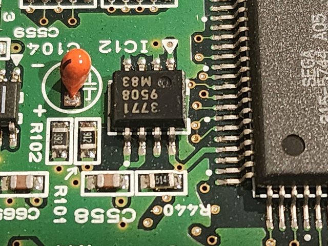

This:
Is very different to this:
Like I said above. Very hard to get solid continuity check on it. Mine seemed fine and I had to really get the pin tacked back down for it to work again.

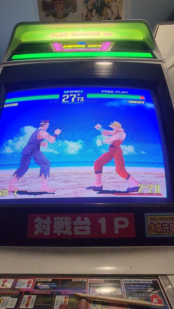

First step above any further testing / back-and-forth is to check functionality of a cart.
Of course it's going to look very different, there's a blob of solder on it. A DMM removes any form of guess work. If there's continuity, there's continuity. Continuity from the pad to the leg and reset point on the multi is all confirmed so I personally don't believe the leg has been lifted.
I've just tested the original cart again and it's working perfectly fine. Sound works, inputs work
I get it, but like I said in my first reply here, mine *was* showing continuity, but it wasn't the strongest connection. Reflowing and tacking it down made it come back to life. Screws me why that's the case though.
OK, so we've ruled that out.

the fact that no sound comes out, makes me think that the problem might be with the microSD or the reset. About the microSD can you show us what you are using? Did you try with a different one?
I've tried transcend, 2x sandisk, 2x samsung - the common denominator is they're 32gb and above (64gb for a few). If I have to, I'll try and look for lower size cards around the house
They're formatted in fat32 using the recommended formatter.
If it was the reset wire, shouldn't I still get "flash writing" on the normal LCD and essentially write the game to the flash so when I power the unit on/off it loads up? I don't get any "flash writing" message at all
