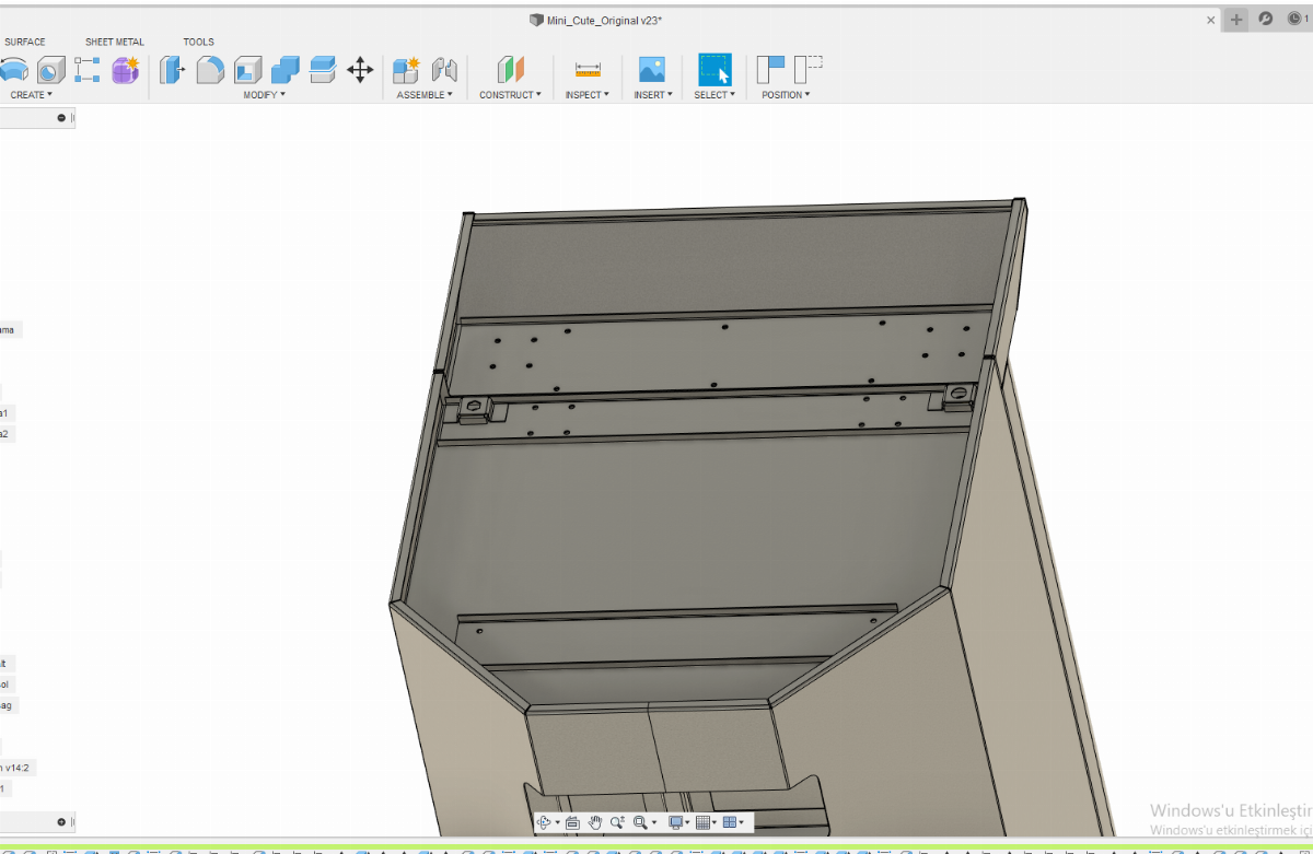

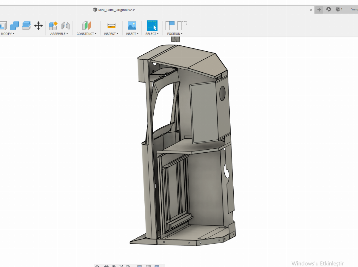

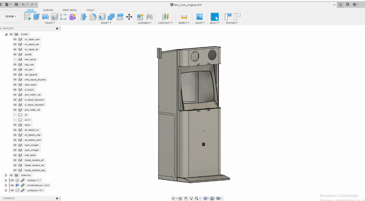

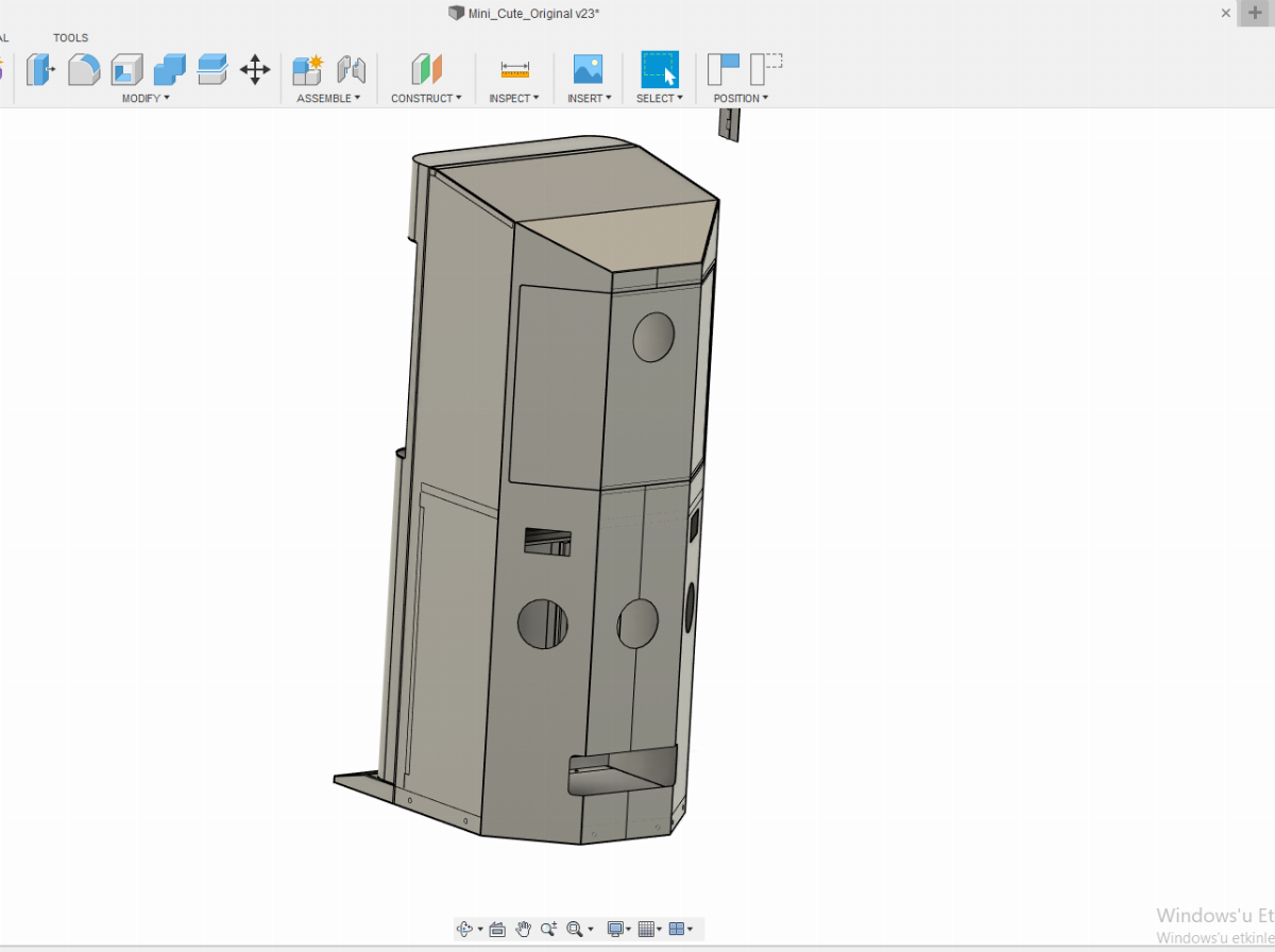

Lets do some updates. Im really hard working on the Drawing. Im trying to do it best i can. Thanks to @rewrite for his great efforts to give me measurements very detailed.
So i can tell you the drawing has been finished %80. Im waiting for the Coin Mechanism. Thanks to @rewrite again, he already ship to me :D .
We are really hard working with @rewrite , but if someone can help us about of the measurements, that will be great. By this way, we can share the pressure of @rewrite ' shoulders i think. If someone has Metric Measure and Calipper, please inform me about that.
I need someone has the WG TUBE with Chasis. Please ?
@SNK-NEO-GEO people always ask about LCD monitor, thats why i will make adapter and bezel for extra. If people want it, they can buy it. But we have to find optimal LCD Monitor
COMPLETED
* THE OUTLİNE OF THE CABINET METAL
* FRONT PANEL
* BACK PANEL
* BEZEL HOLDER
* BEZEL FOR 19"
ETC..
WIP AND LEFT
* CONTROL PANEL
* HIGHES
* PLEKSIGLASS ATTACH PARTS
* COIN BOX
AND SOME MINOR DETAILS

I will make a LCD adapter and Bezel for it too. Please tell me what LCD model and Size you recommended.
The drawing almost done, im waiting your suggestions

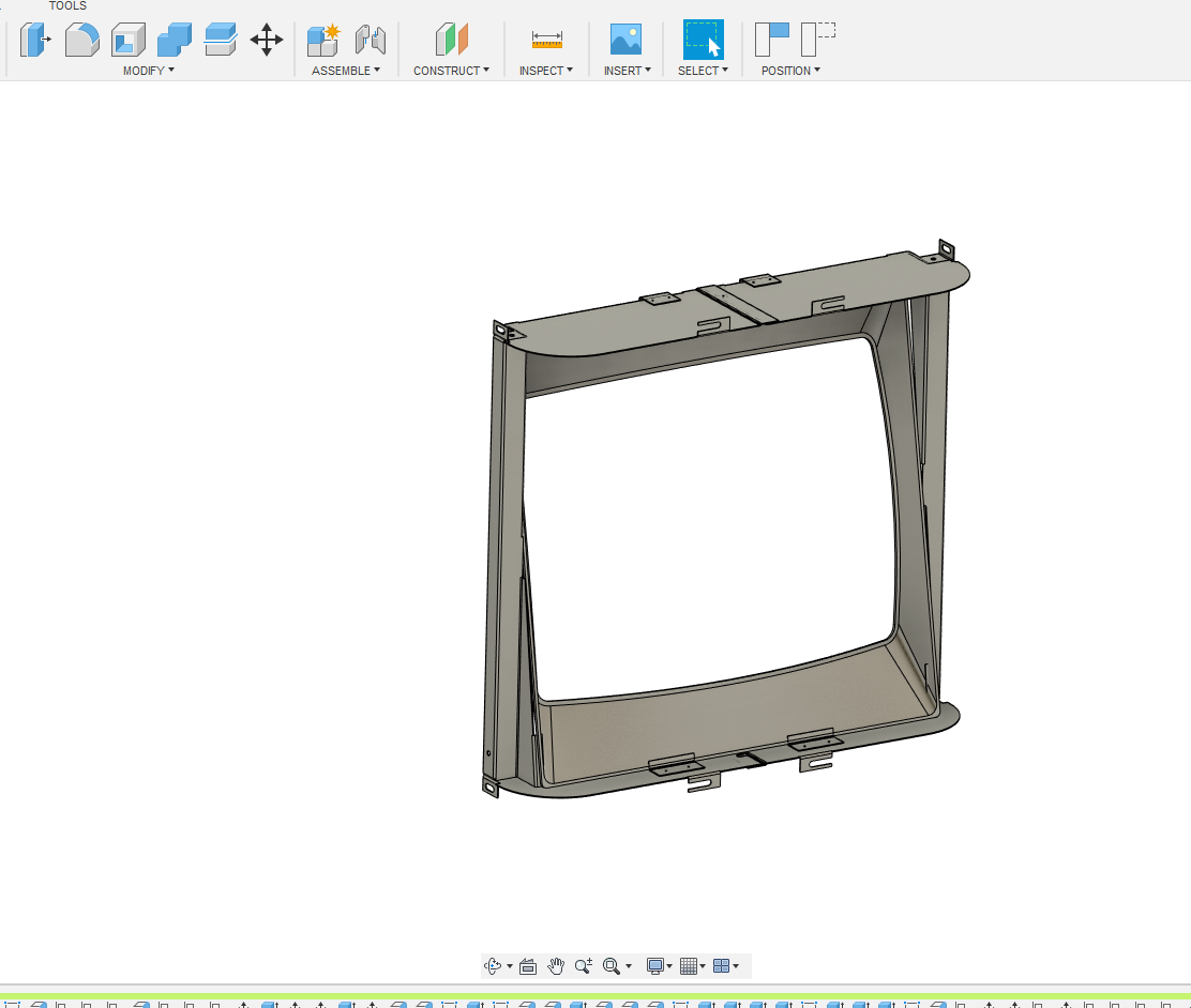

@hursit, as for 19" LCD's, I am thinking users could also use a decased 20" LCD since a 19" CRT is just the measurement of the viewable area. Should have enough room in there to fit a 20" in addition to a 19" LCD. As for mounts, don't most LCD monitors come VESA mountable, even if decased? If so a rotable VESA mount for the repro would be great for those that want to go the LCD route. If you can make the mount depth-adjustable to account for different manufacturers designs that would be great. The bezel would just be standard flat as it is LCD and no curve for a 4:3 19" display. Maybe add in perforations to allow the user to knock it out to fit 20" 4:3.

i have checked the 4:3 LCD screen measurements, im afraid it doesnt fit into the original bezel holder. Sorry we have to make it for 19"LCD too.
