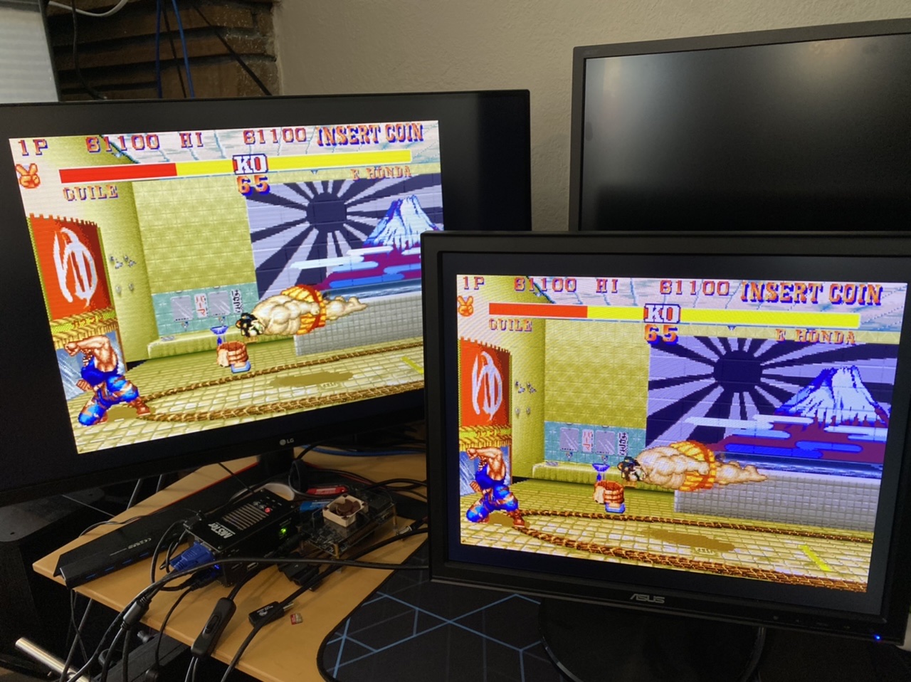

I have the VB199TP that I used for my Arcade1UP and MiSTer setup. Let me know if you want me to do any tests on it. The max res is 1280x1024 so it's not too bad. Great news, is it does have VESA mounts and is very light weight, so any cheap VESA mount will do. A rotatable VESA would be great.
How do you like it?
I like it, no complaints here for the price. I think these monitors would be perfect for the mini cute. I pulled the monitor and did a quick side by side of the LG 32GK650F-B 32” monitor vs the ASUS VB199T-P 19”. Latency is very low and plays perfectly fine for fighting and schmup games. Color is reasonable too, especially for a $118 monitor.
FYI, the MiSTer resolution is set to 1280x1024 with Integer scaling ON (hence the black bars) and CRT scanlines set to 50%. If you wanted you can scale it to full screen with vscale_mode=0. (Still looks good imo, but not integer scaled)

Sure, I can get some accurate measurements later tonight. Btw, that monitor in the picture you posted isn't the VB199T-P. I'll also take some pictures later.

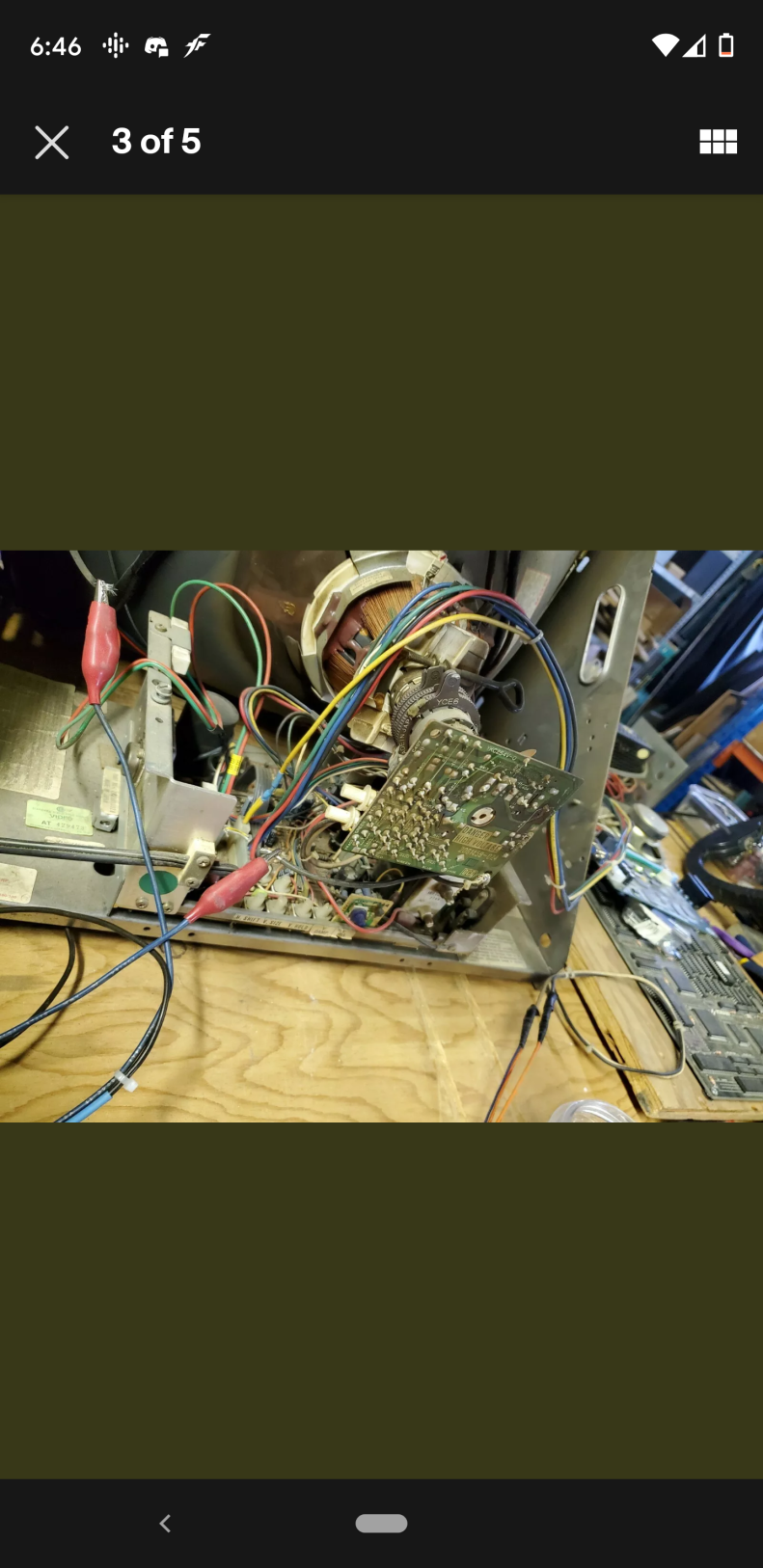

K4900, K7000 have different frames if I'm not mistaken. And one of the two you can't remove the frame without doing a bunch of modifications as it's the main ground for the chassis. So we should probably get measurements on both?
