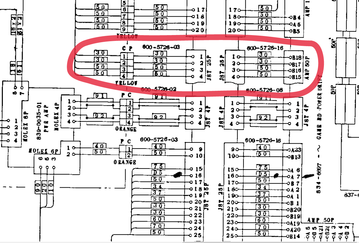

I think it’s either I got the wrong schematics or I got some input issues. The readings of voltage on the pins according to the pin out I got from the web is totally wrong.
Did you connect the "b" pins of the connector to 5v and gnd? That is needed to get the inputs working.
Hmm, no. That was something I was debating about.
I only connected the GND.
When nothing is connected (5v or GND) I get strange readings and floating logics on the pins. There was no continuity between B GND pins and the power input GND, so I decided to connect the B GND pins to the board's GND. I'll try with the 5v as well.
Can I cause damage when connecting the 5v to B17-B21?
you need the 5v and ground to drive the opto-isolators if it's anything like outrun or super-hang-on.
You guys are right !
I've attached Power Drift schematics (they share the same hardware) and it appears that I need to feed 5V and GND also to the B pins on the AMP 50P connector.
