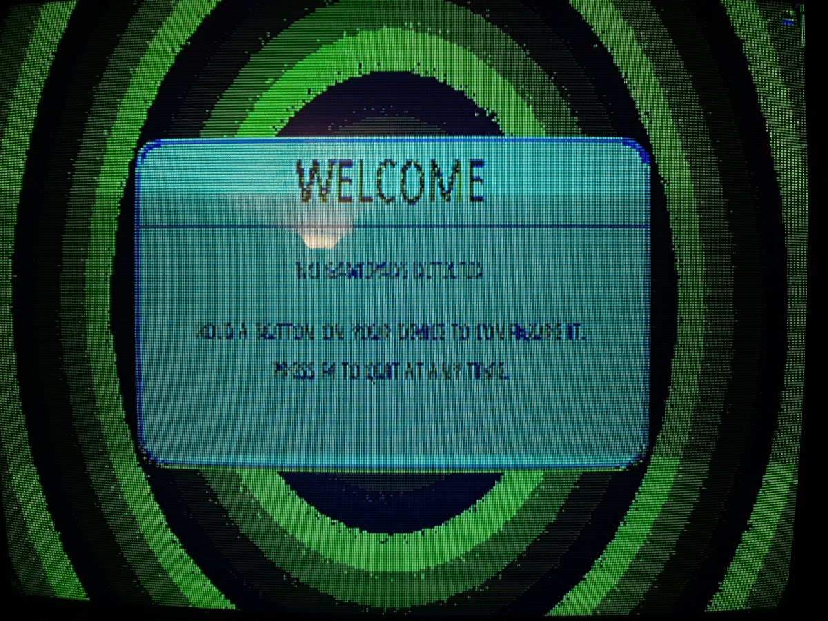

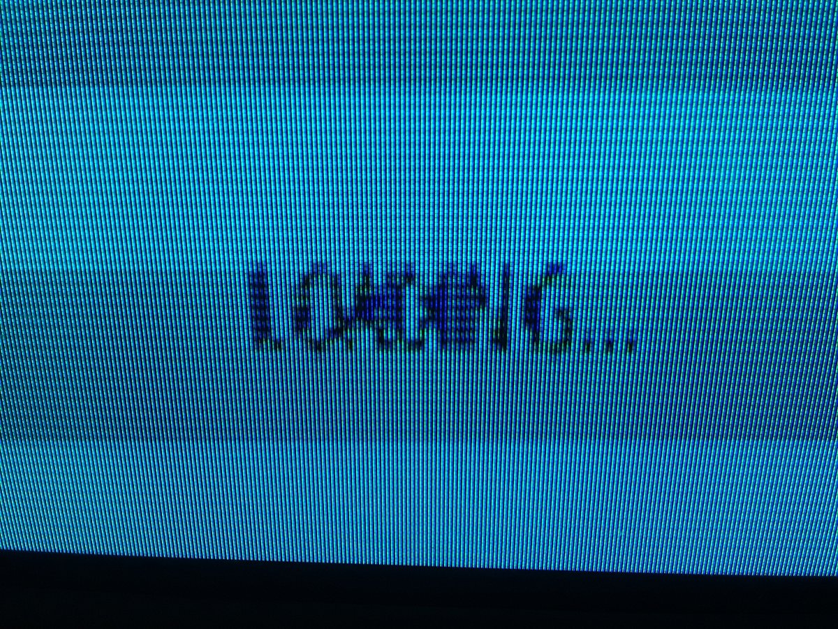

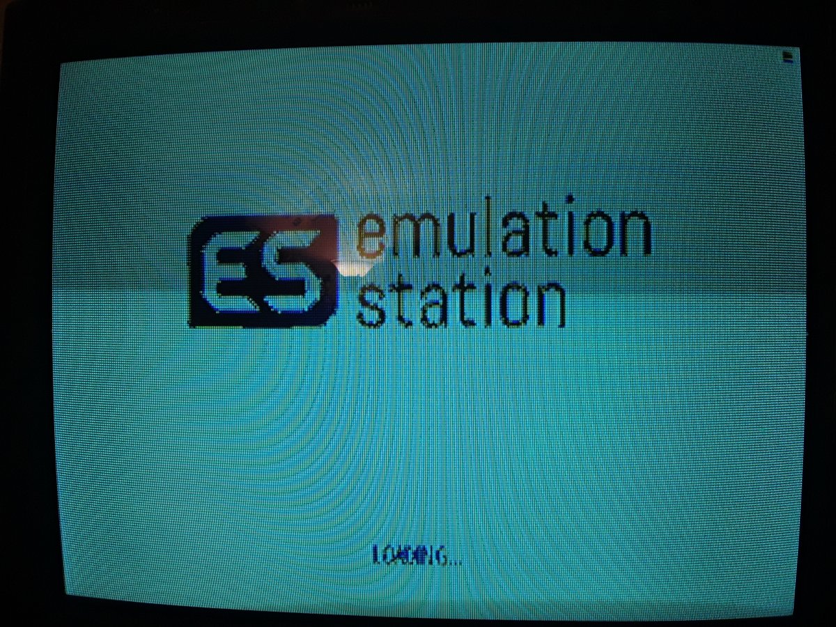

I have been having issues getting a clean video signal. I have a retropie image that I would like to edit the config.txt for but it look this crappy. Can anyone tell me whats wrong here? its on a rpi3b and how do I tell the Pi to use the Jamma buttons instead of usb? I think a driver update for my image most likely will fix this

Is that operating system necessary? I am probably not going to change mine since I dont think its upgradable. its on jessie and I think it just needs to use the right gpio pins
