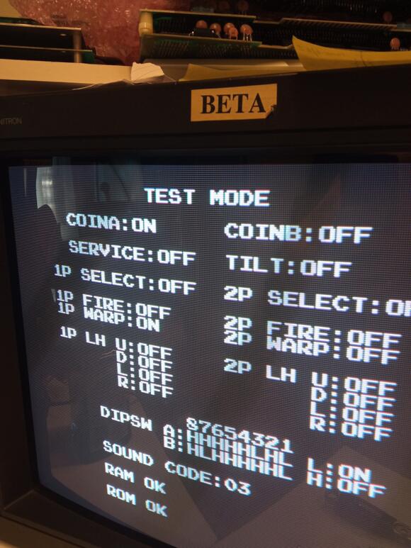

Their positions on the PCB are 14, 21, 22, 23, 24, 25.
You can see they are labeled with blue painter's tape below.
You should only use rev 1 ROMs as my testing has shown that rev 0 have a bug that causes a crash on level 5, in some instances.
I have verified this on legit and bootleg boards and have read other online accounts.
All Rastan romsets will have dumps that end with the same extension.
You are interested in: .7, .8, .9, .19, .20, .21
This is the mapping from the romset to the positions on the board.
b04-13.7 = 21
b04-15-1.8 = 22
b04-17-1.9 = 24
b04-14.19 = 14
b04-16-1.20 = 23
b04-18-1.21 = 25
