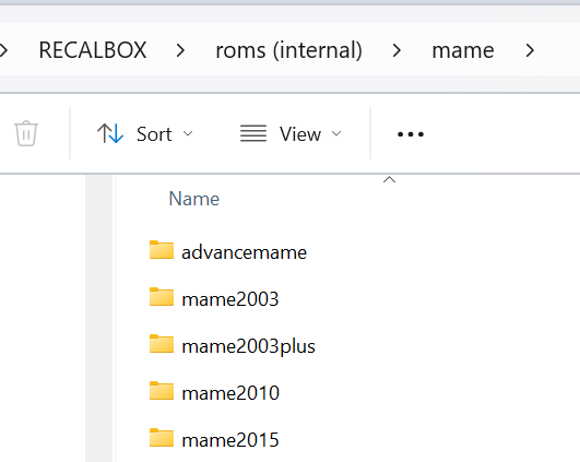

edit: ok I think I figured it out from this explanation:
By default, the roms\mame folder is for MAME 0.258 ( which hey is not bad!). but if you put the roms there it doesn't list them all.
the other subfolders are:
mame2003 Based on romset: MAME 0.78 (December 2003)
mame2003plus Based on romset: 0.78-0.188 (MAME 0.78 as baseline with others ROMs based on higher MAME romsets)
mame2010 Based on romset: MAME 0.139 (August 2010)
mame2015 Based on romset: MAME 0.160 (March 2015)
advancemame Based on romset: MAME 0.106 (May 2006)

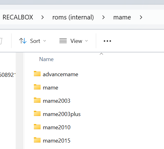

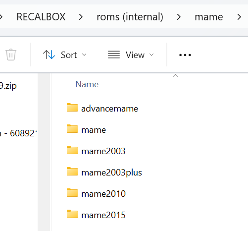

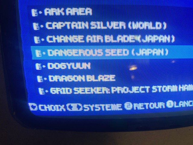

If I create a subfolder under roms(internal)/mame/mame258 and place some 258 roms in it, it's not displaying it ( i used Dogyuun (8/25/1992 location test) [Moffitt] which was added in 258).

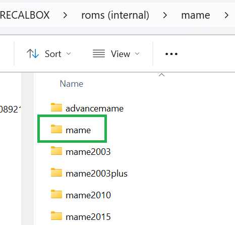

ONLY if I rename the subfolder roms(internal)/mame/mame will it properly display (and play) it.

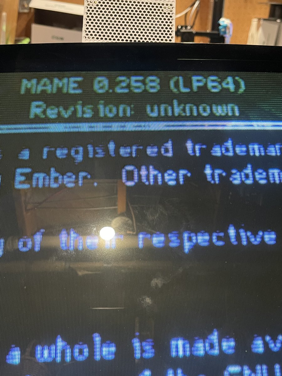

so off to the races I go with 0.258 roms in this :
