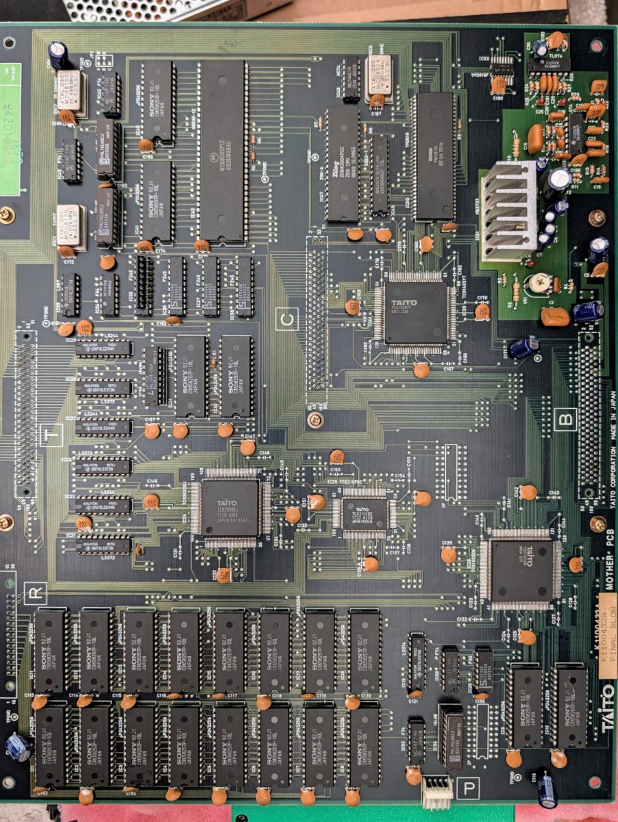

Taito F2 Final Blow motherboard
There are multiple Taito F2 variants, so please double-check compatibility of your motherboard.
I've only listed radial electrolytic capacitors. There are also lots of ceramic capacitors not listed below.
LocationµFV
C222016
C71016
C822016
C91016
C101016
C1110016
C12100016
C1310016
C301016
C10122016
C11022016
C17122016
C18422016
