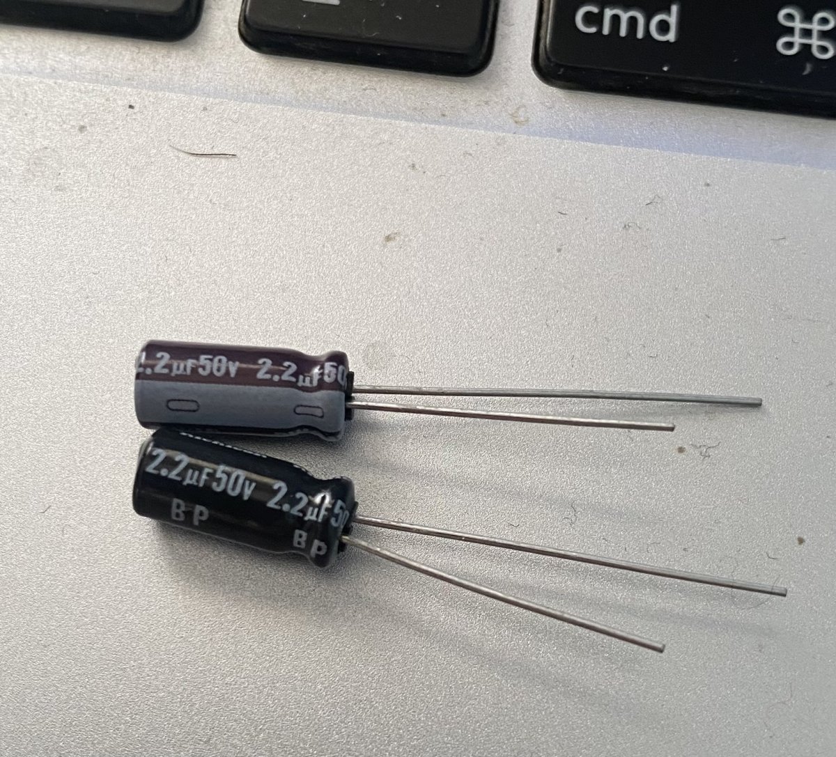

[EDIT] I found a stash of 10uf 50v caps to finish recapping my board. I think I've come to the conclusion that Sega just ran out of 10uf16v caps and just used 50v. Every 10uf cap, both big and small, were 50v and all made by Sanyo. So for now, I'm good. Maybe it'll be good reference for someone in the future.
Could someone confirm if all the 10uf caps on the S18 stock board (clutch hitter in this case) are indeed 10uf 16v as the Capacitor Database says? I'm recapping mine at the moment and the ones I'm pulling off are 10uf 50v. Just want to confirm before I potentially put undervolted caps on. I'd appreciate any help on this.
Using a higher voltage rated capacitor for the same capacitance value is for the most part fine in this scenario.
16v is generally the lowest you would use as there's theoretically a 12v supply rail on the PCB even though most of the board logic is going to be running on the 5v.

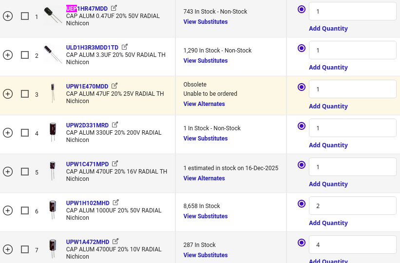

Hello
I was looking for the cap list of a Astro City PSU, model 400-5198 and found it in this thread, so thank you very much for this great collective work!
https://docs.google.com/spreadsheets/d/1nMBeF7MfyWqYaPxwaINMSrF_YJJEp2VyCneYm8G4gtU/edit?gid=0#gid=0
But now I'm about to place an order on digikey and I'm not sure what capacitors to choose because for some of them there are too many options.
Nichikon or Panasonic? Lifetime @ temperature? General purpose or audio? Ripple current? Impedance? too many variations xD
Basically I just want to buy the best ones suited for my PSU so any advice on how to pickup them would be very appreciated.
For now I'm filtering on manufacturer (Nichikon) and diameter (x mm) and mounting type (through hole). Then trying to pick up the ones with more tolerance, more reliability, higher operating temperature and lower impedance.
In that sense, Nichikon UPW series, promoted as "Miniature Sized, Low lmpedance, High Reliability For Switching Power Supplies" looks good (though mostly marked as obsolete) and also others within the High Reliability Type.
This should be ok?

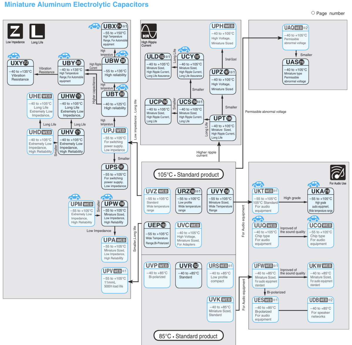

I use Nichicon first because they have a handy chart: https://www.nichicon.co.jp/english/_assets/images/products/catalog/corporate/digital/chart_E.pdf
Here's a slice of it, you can see what the series are and how they relate. It's been helpful for me to decide what to use, and when. Beyond that I use audio caps for audio sections, high temp / long life for general use, and try to find the same series for anything large (often obsolete caps will have a newer version just with a different series name, but the specs are similar enough).
Thank you for your answers and advice (and sorry for the late reply)
I also got below advice from a friend that knows much better than me.
For the primary bulk, that handles the main AC, it should have high ripple but NO low esr because that can destabilize thethe smps. Recommended series are Panasonic ts-ed or ts-up. Panasonic might be a little better than Nichicon but if you prefer Nichicon then LGY, LGU or LGS. For the others, if you prefer low esr then Panasonic FR or FM and Nichicon PW or HE
So at the end I
This is the final list I got. It has been working for a few weeks. Max time the machine was on was yesterday around 6 hours.
I NIchicon because I've used in the past without any problem.
https://www.digikey.com/en/mylists/list/AOKHRH28SU
Now revisiting it, I'm not sure why I ended using two ULD (high ripple current) instead of PW or HE....

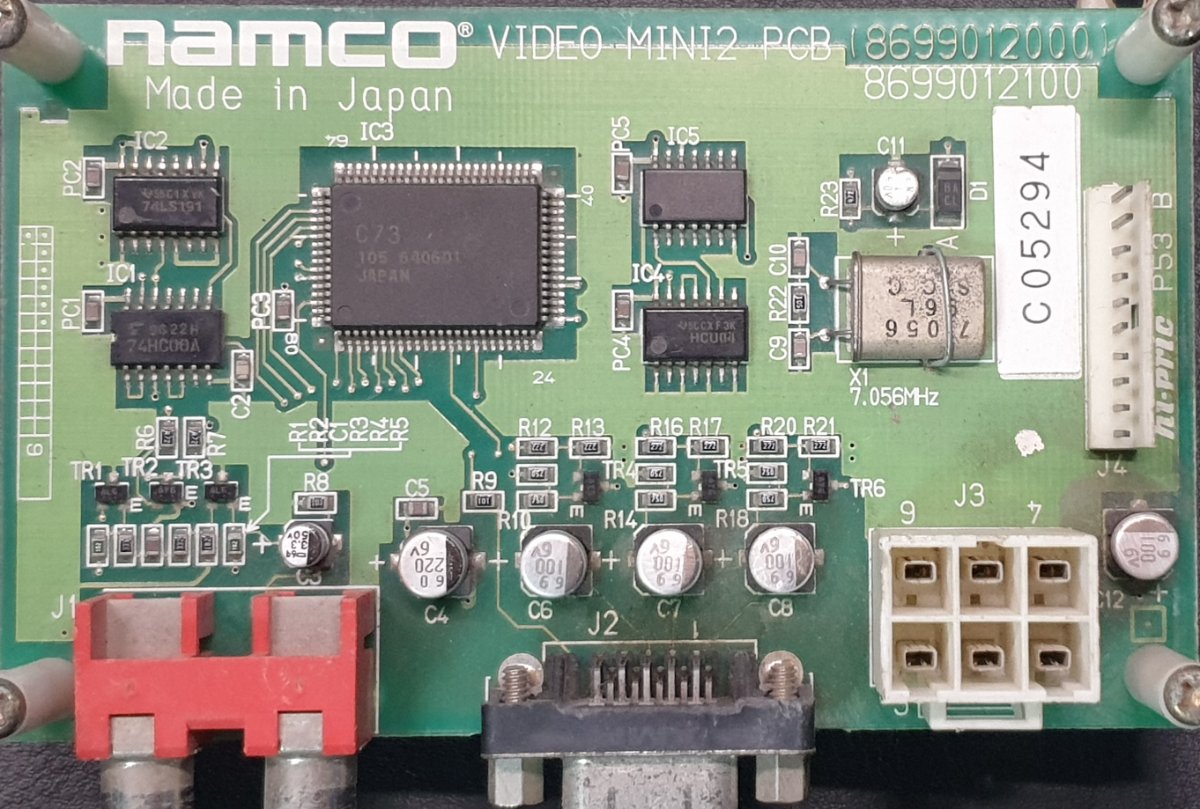

Here is a CPS2 A-board "capmap" if it is any help. I did two of these lately and 2nd one of those had most of the 10uf electrolytic caps replaced with ceramics, so be aware. This capmap only has electrolytic ones, so no ceramics. and don't mind the picture, it is out of scale and just to give some idea where they locate :D
5x 220uf 16v
31x 10uf 25v (the amount on later rev is much smaller)
3x 47uf 16v
2x 100uf 16v
2x 22uf 16v
4x 1uf 50v
1x 2.2uf 50v
1x 1000uf 25v
Do you still have the picture for the cap locations? The image URL is broken.
