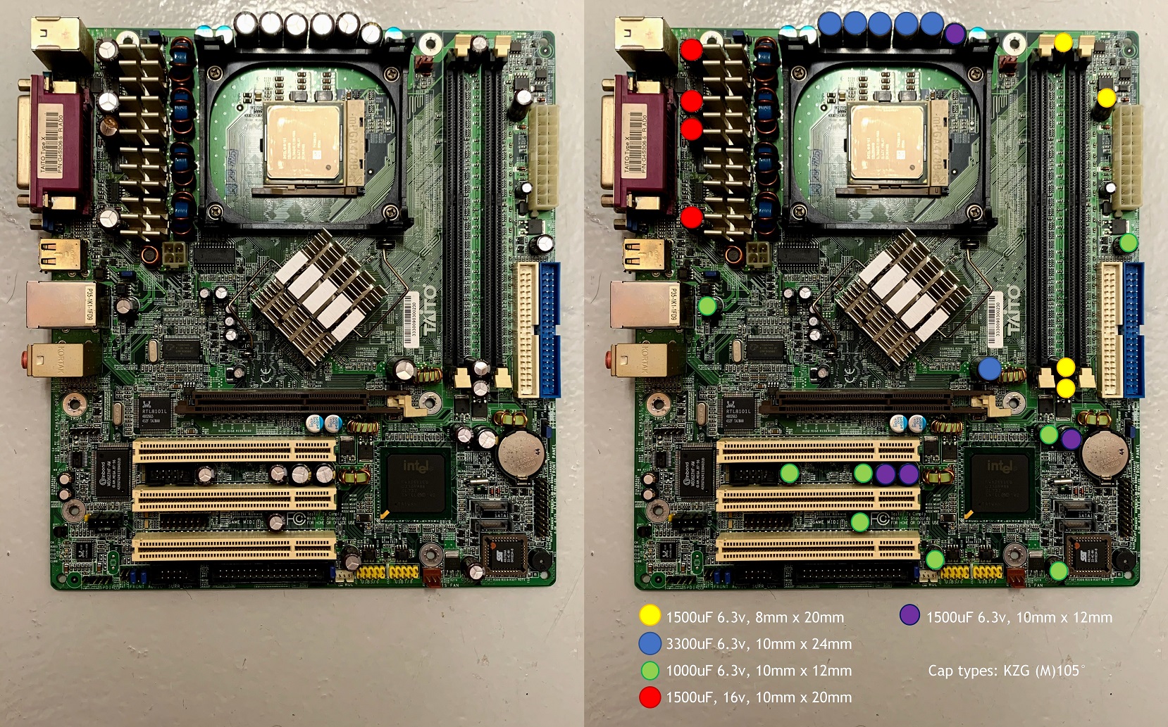

Taito Type X motherboard (G4S306-5)
Thanks to @penrhos for the repair thread.

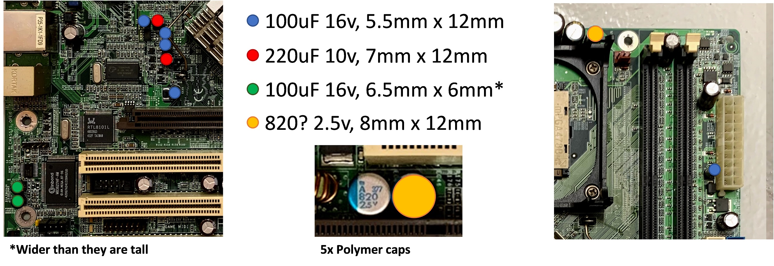

35x Electrolytics:
6x 3300uF 6.3v, 10x24mm KZG
4x 1500uF 16v, 10x20mm KZG
8x 1000uF 6.3v, 8x12mm KZG
4x 1500uF 6.3v, 10x12mm FJ/KZ
4x 1500uF 6.3v, 8x20mm KZG
5x 100uF 16v, 5.5x12mm KMG
2x 220uF 10v, 7x12mm ST?
2x 100uF 16v, 6.5x6mm KME
5x Polymer caps:
5x 820? 2.5v, 8x12mm

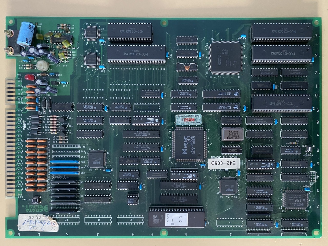

I've compiled the list for DATA EAST "Joe & Mac Returns" hardware (Data East SIMPLE 156 Hardware | DE-0409-1)
This radial cap list can be applied to next games :
Joe & Mac Returns
Magical Drop / Chain Reaction
Magical Drop Plus 1
ps : Since i'm not sure if Mitchell hardware uses same capacitors , i will not put in the list the rest of games (Charlie Ninja , Gonta 2 , Osman)
* C57 - 1000uf 35V (Dia 11mm , Lead Spacing 5mm , Lenght 19mm)
* C55 - 10uf 16V (Dia 4mm , Lead Spacing 3mm , Lenght 10mm)
* C54 - 10uf 16V (Dia 4mm , Lead Spacing 3mm , Lenght 10mm)
* C53 - 220uf 25V (Dia 4mm , Lead Spacing 3mm , Lenght 10mm)
* C52 - 4.7uf 25V (Dia 4mm , Lead Spacing 3mm , Lenght 10mm)
* C43 - 10uf 16V (Dia 4mm , Lead Spacing 3mm , Lenght 10mm)
* C40 - 100uf 25V (Dia 5mm , Lead Spacing 3mm , Lenght 10mm)
* C38 - 100uf 25V (Dia 5mm , Lead Spacing 3mm , Lenght 10mm)
* C37 - 0.47uf 50V (Dia 4mm , Lead Spacing 3mm , Lenght 10mm)

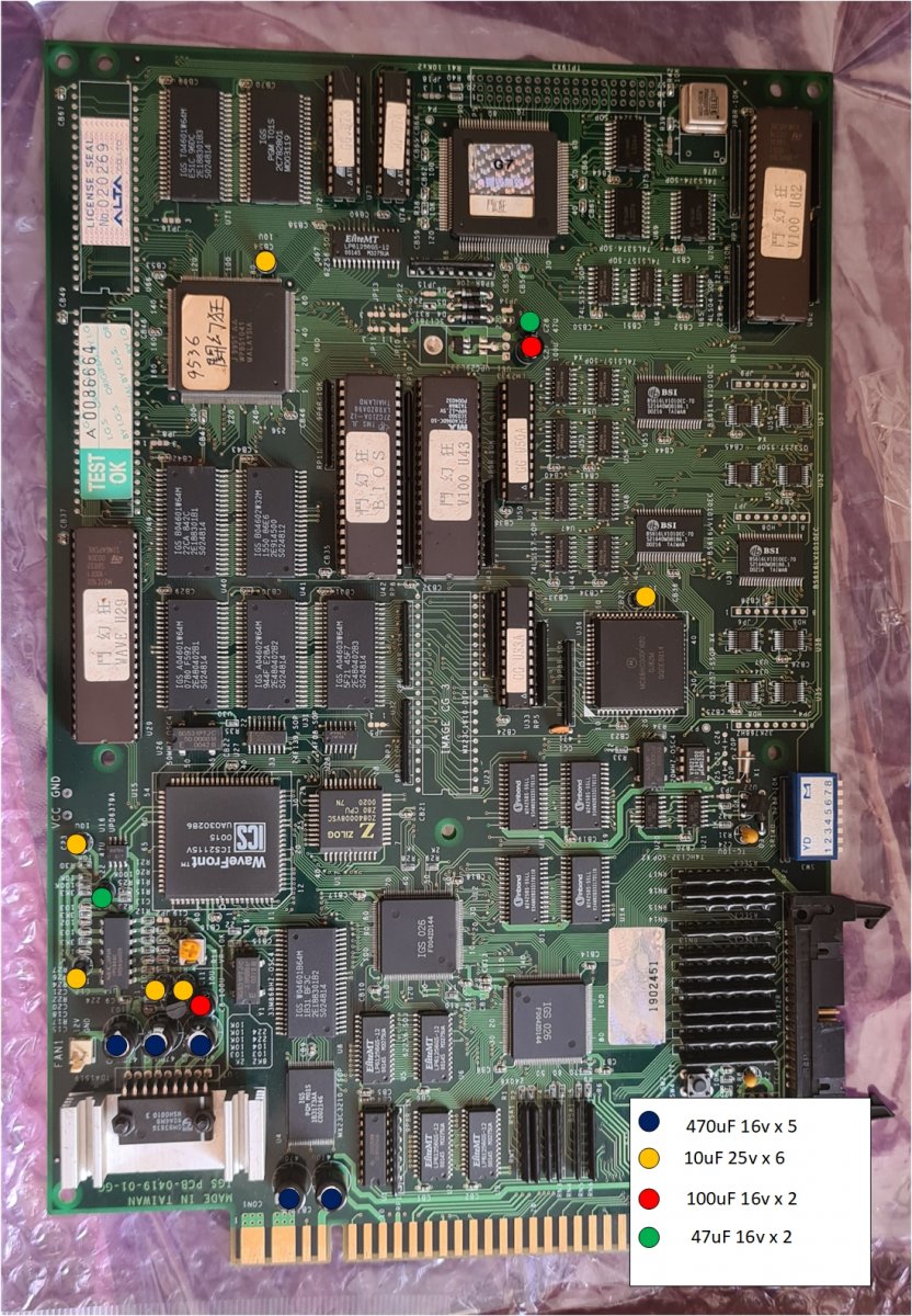

NARC
C39, C59 47uf 50v Radial Sound
C10, C13, C9 10uf 25v Axial Sound
C19 47 uf 25v Radial Sound
C20, C34, C55, C67 2.2uf 50v Axial Sound
C2, C6, C16, C48, C68 100uf 35v Radial Sound
C30, C57 1000uf 16v Radial Sound
C15, C21, C47 470uf 16v Radial Sound
C33, C46, C54, C43, C44 1uf 50v Axial Sound
C1, C2, C3, C4 100uf 16v Axial Cpu
C1, C4, C5, C6 100uf 16v Axial Rom
C1 100uf 16v Axial Control

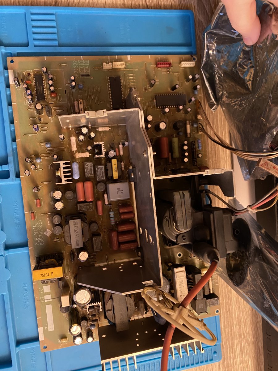

Nanao MS-2933 Chassis
C721, C203, C232 - 100uf 16V
C407, C401, C381 - 100uf 25V
C406 - 100uf 50V
C971 - 10uf 16V (BP)
C924 - 680uf 25V
C332 - 10uf 250V
C930, C957, C960, C711, C927, C505, C503, C712, C723, C234, C201, C613, C609, C626 - 10uf 50V
C454 - 1uf 100V
C624 - 1uf 50V
C621, C230 - 2.2uf 50V
C922 - 2200uf 25V
C929 - 220uf 16V
C233 - 22uf 50V
C531, C532 - 330uf 35V
C506 - 330uf 25V
C608 - 33uf 50V
C722, C625 - 4.7uf 50V (BP)
C614, C636 - 470uf 16V (I used 35v)
C910 - 470uf 35V
C954, C961, C535, C353, C356, C202, C231, C104, C361, C362, C607 - 47uf 16V (I used 25v)
C953 - 47uf 250V
C923 - 680uf 10V
C905 - 1200uf 200V
C921 - 470uf 250V
C702 - 6.8uf 250V (I used 400v)
I copied this list from Neo Geo forum. Only difference I had that C614 was completely missing on my board (had solderpads still on factory tin and filled, so it was never there). So that might be missing on other boards too. Since it is under that metal cage, it propably would not even fit. I marked the place of this with black X on the PCB picture.

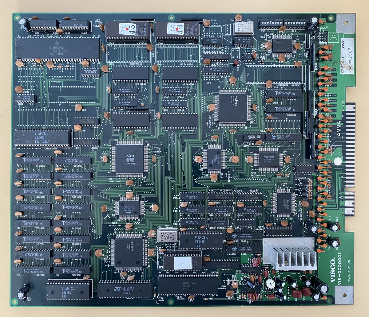

Drift Out (by Visco) on Taito F1 Hardware
Radial capacitors :
- C121 , C122 , C124, C88 , C78 , C1 , C26 : 220uf 16V (Dia 5mm , Lead Spacing 5mm , Lenght 10mm)
- C79 : 1000uf 16V (Dia 10mm , Lead Spacing 5mm , Lenght 20mm)
- C70, C71, C72, C62 : 10uf 25V (Dia 3mm , Lead Spacing 3mm , Lenght 10mm)
- C75, C77 : 100uf 16V (Dia 4mm , Lead Spacing 3mm , Lenght 10mm)
