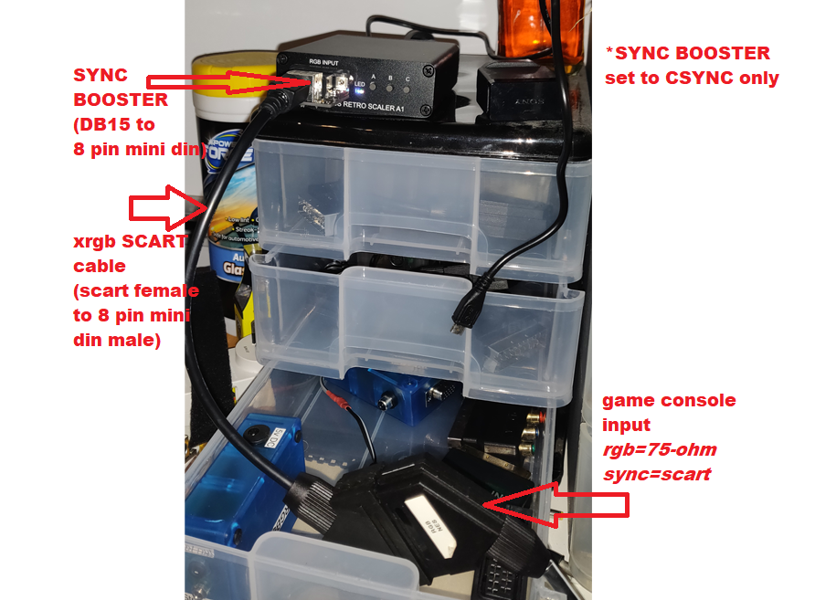

I made a picture to maybe help some people with connecting up to their retroscaler-a1 which is short and worked well for me.
Items used:
@Frank_fjs creation SYNCBOOSTER (set to CSYNC, actually stripping the sync, I find this is most compatible for the RS-A1)
XRGB mini Framemeister scart to 8 pin mini din cable
game console + scart cable
There should be no need for anything in front of the A1, as it already has a chip doing sync separation/amplification etc. I believe the syncbooster thingie outputs TTL level sync, in which case you should not use sync=scart.
