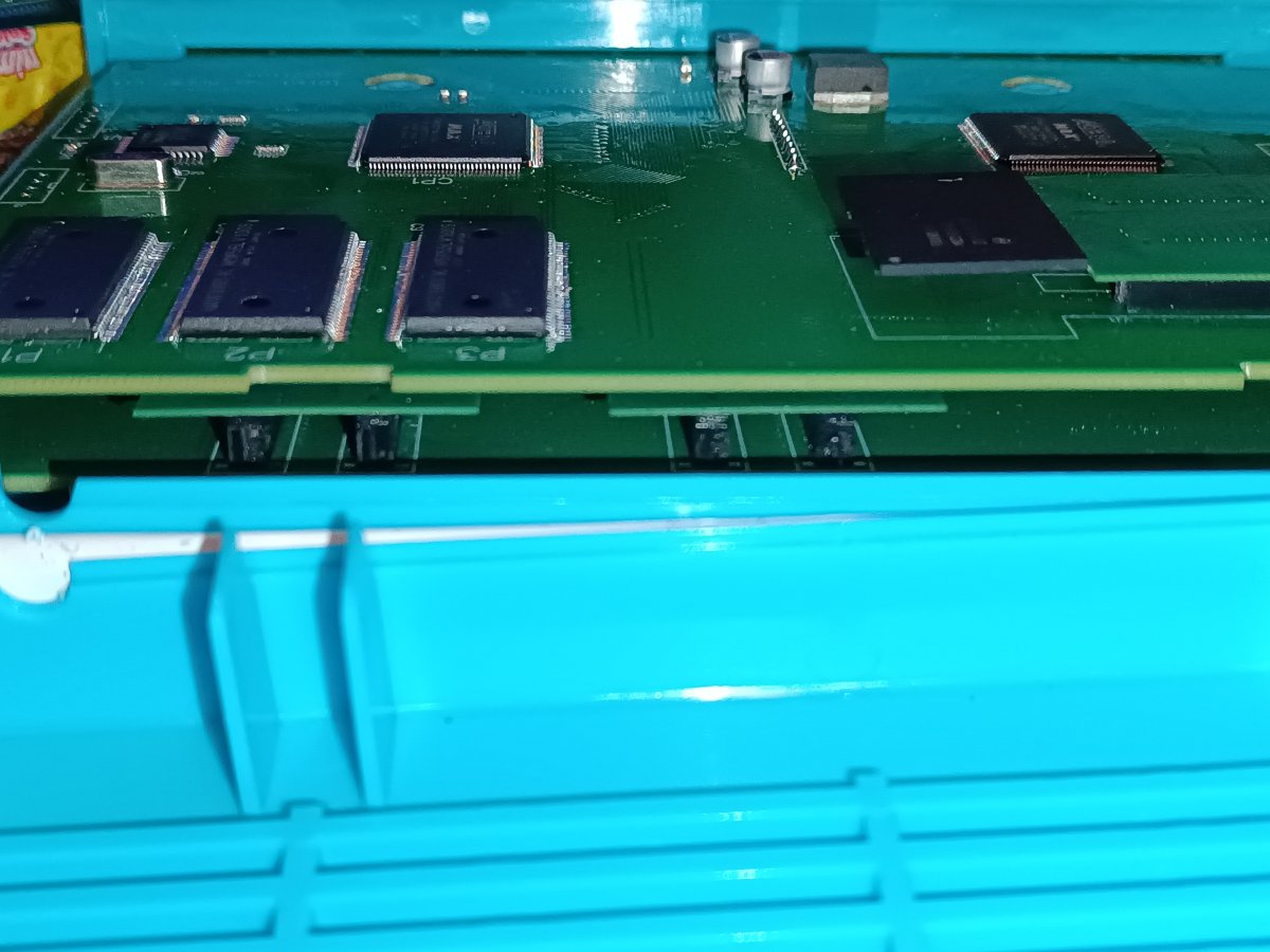

On my last Ali purchase I got a blue cart. Arrived today, and its quite clean. I messaged the store and sent them the link to this thread. Maybe that'll help it get going and meet a relatively good price.
I did the same with my v3 (blue cart) and it closes perfectly. Even has some space so not touching anything

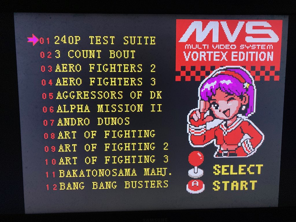

Hi Friends,
I just went through the process of of creating my VTXCart...
And it kinda works: some games will run... most games wont.
Hardware: Yellow Case, Board Version - 161in1-SB-1G-P_V10 - 20200216
Initially i had the issue with the scrambled image which was dealt by altering the CPLD pins.
But i still have games just throwing memory errors, claiming the cart is improperly connected or rebooting the MVS to a state, where it shows the Cross-Hatch-Test.
I also found one game booting but then the backgrund tiles are all messed up and the actual game will not load any enemies or terrain... (Zed Blade - Image attached)
All the Chips went with 0 Errors through Program and Verify.
My board has a JS28F256 though, therefore i rebuilt the cart.bin with 32MB support for SROM
ZUPAPA e.g. goes after the parental notice and then into EXCEPTION (image attached)
Any clues where i can start debugging?

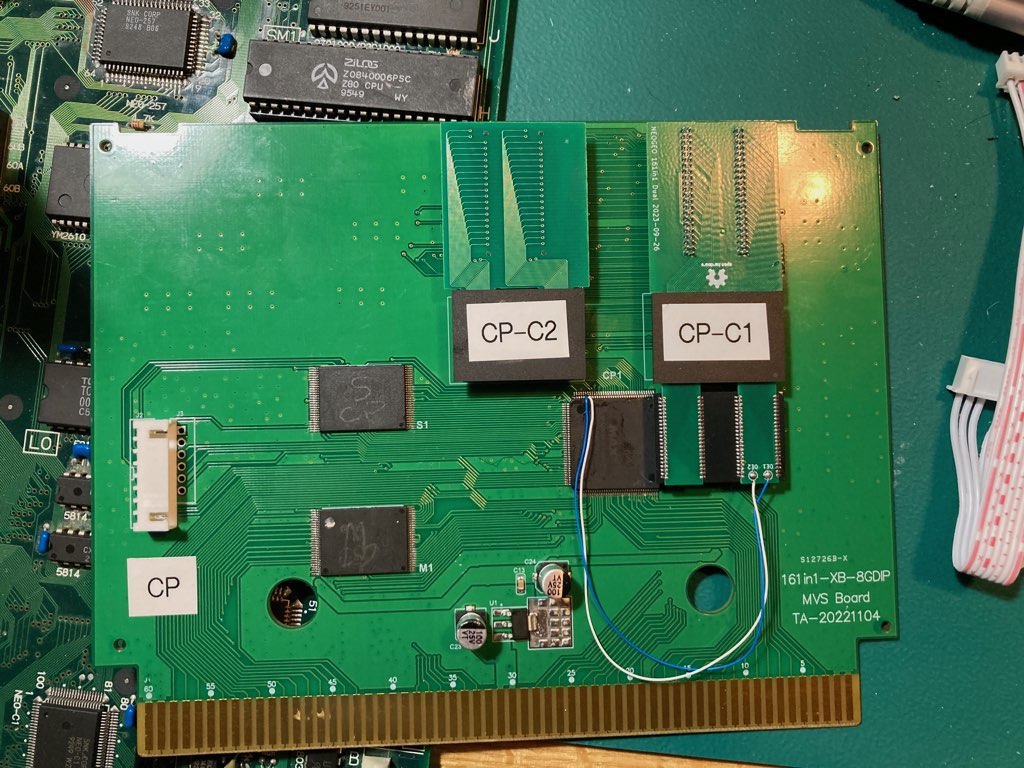

Progress update for the dual C flash chip daughter board, which arrived today. I did the non-castellated hole order as @ManCloud suggested since jlc rejected doing it with.
You can see the effects of not doing castellated holes on the jlc order if you zoom in
The left side copper from the through hole is still there, just kinda pushed in a bit. I ended up just using fine tip tweezers and pushing the dangling copper all the way against the right side of the hole. Seemed to work ok.
Here are pics of it assembled and installed
Last weekend when I was doing some debugging I found a way to optimize the prom data, which saved about 70MB of prom space. This made it possible to include the full rom set plus a number of homebrew titles on the cart. I made a cart that included all of the games (except xeno crisis) from @Vortex's archive.org romset. There is still a little bit of space to add more too. I also sorted the games based on their menu name.
Loading up zupapa! confirmed the 3rd C flash chip is working
I need to make a small adjustment to the daughter board, then will put it up on github, probably this weekend. Code changes for the prom optimization and support for the 3rd C flash chip have been PR'd.

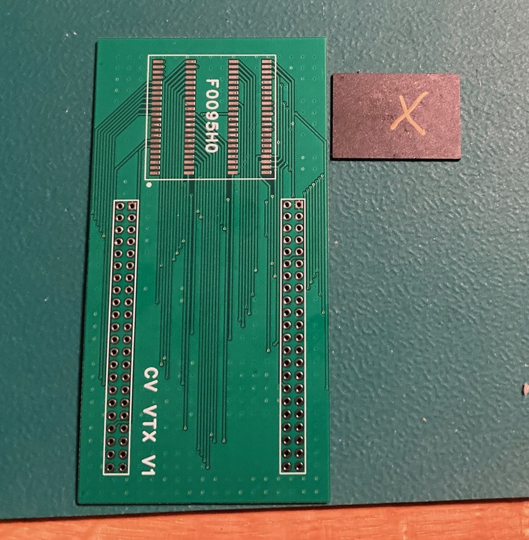

Thanks for doing all the leg work in figuring out how to add more games than stock. I'm going through the process of ordering the dumper boards from JLCPCB (1.6mm thick, tented) which doesn't really matter, as it's just for dumping. Can you provide sizes for the PCB that goes back in the cart? (e.g. 0.8mm thick?)
I also noticed there are 2 dumper boards for the F0095H0; one that uses the STILT PCB that these chips are installed on (Y13), and one where you solder these flash chips directly to the dumper board (Y12) Good luck to the person who manages to do that! We only need the the plug in version (Y12) and skip the solder one (Y13) correct?

The STILT dumper board expects you to solder the STILT daughterboard and not the flash chip. Check the size difference between the pads and flash chip
The dual daughterboard will only work on the V3 boards. The thickness will need to be 0.8mm.
