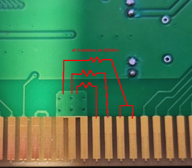

If you're modifying an AES cart, the modifications would look different. For AES cart, the correct fix is:
B28 -> 220ohm -> 5V (B25/B26/B27)
B29 -> 220ohm -> 5V
B30 -> B31 -> 220ohm -> 5V

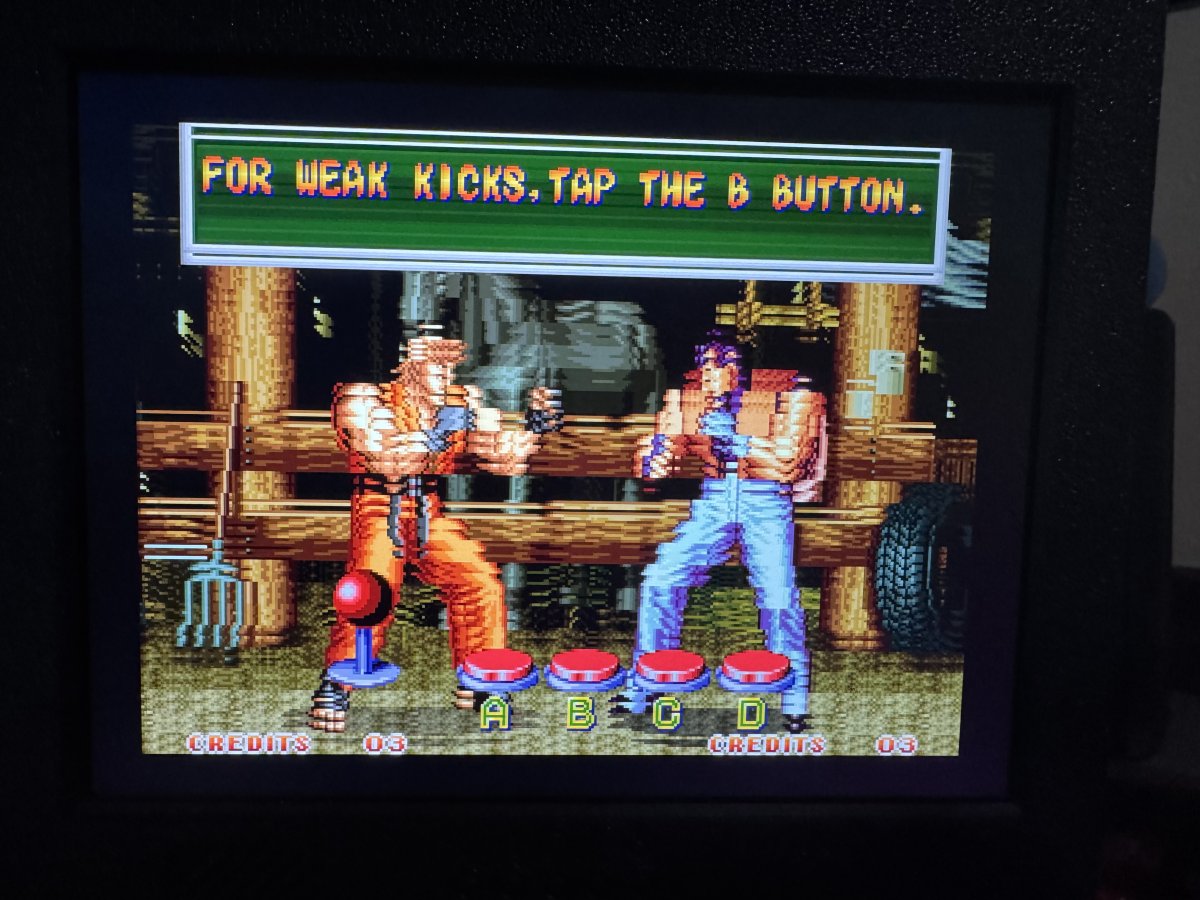

I want to stress that this fix is really needed only for AES with Hitachi CPU based on my experience. Toshiba and real Motorola CPUs are more forgiving with timing not set correctly. This "should" fix issues where ALL games have bad graphical issues (text is not readable) little line glitches here and there will not be fixed by this. Those are issues due to the way AES multiplexes graphics.

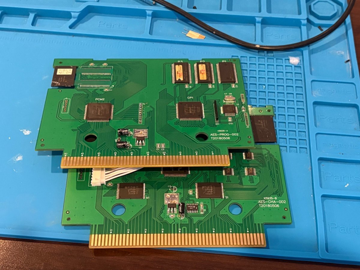

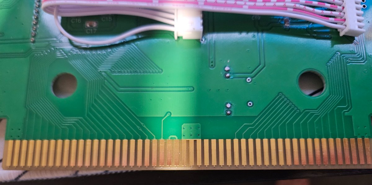

Thanks for the clarification. The revision I have can be seen in the attached images, doesn't look like pin 30 and 31 are connected, I guess I'll bridge them?

Here is the fix I want you to try on that AES cart. Let me know if this fixes the corrupt graphics for all the games. You'll need to scrape the solder mask to connect the wires or resistors to it. 220ohm is what real Neo Geo carts use.

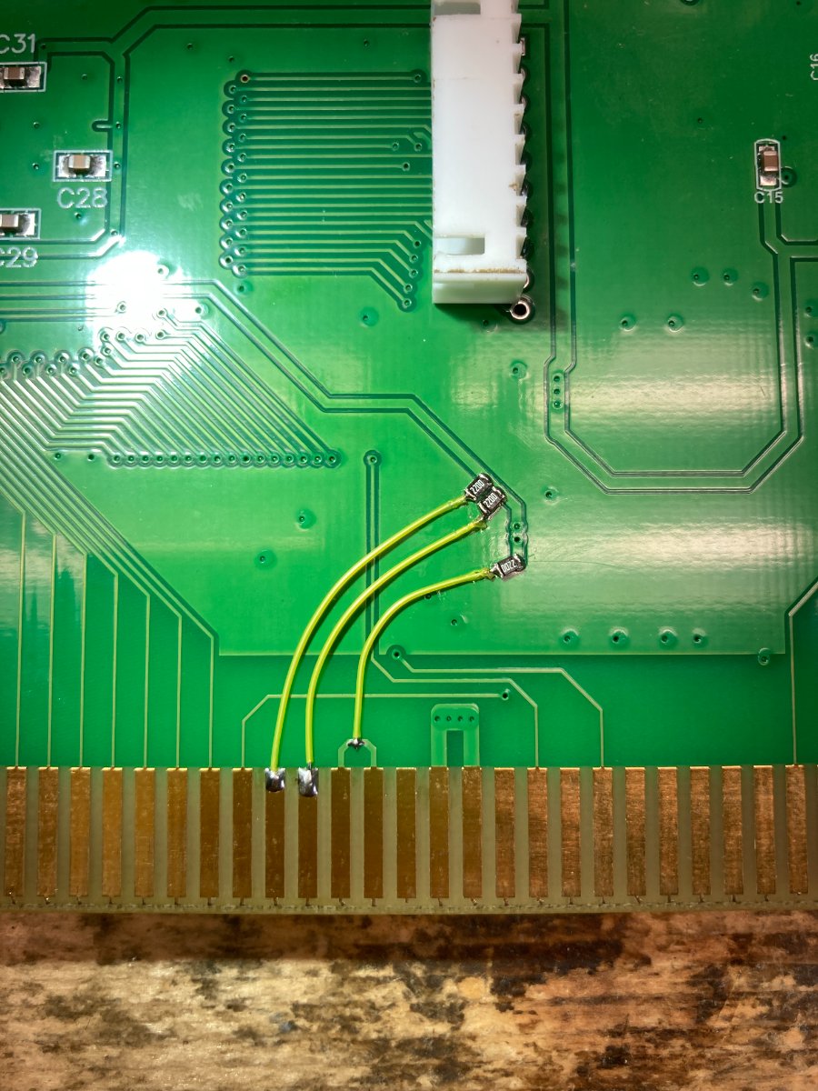

I installed the mod and the picture is cleared up a bit, but the issues still remain unfortunately. I'll give the CPU swap a try before calling it a day.

Just curious. With my vortex 161-in-1 cart, the first 78 games has that graphical glitches. It's basically unplayable. Is this similar to what you guys are seeing ? Or could it be an issue with my specific cart ? I do have a 3-5 aes console.
I sent you a message.
For me it's mostly the latter half of games, but the glitches are just messed up text and vertical lines in the sprites. Roughly 40% of games are affected.
