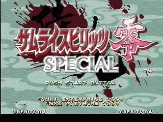

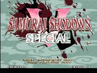

Okay, I just made this work on the MVS multi. I was assuming the P ROM from the release was scrambled, which is not the case. You only need it scrambled to make it work with MAME. Because of the C-ROMs not being CMC encrypted it might not even be a good idea run it on MAME with the Samsho5sp slot.
Now the question, am I missing a patch for the C-ROMs, no???
The logo is different than what it is supposed to.
Just making sure I am being clear, putting byteswapped samsho5_fe.cslot1_maincpu as "prom" straight without any changes, making crom0 from ss_unswizzle.exe and odd/even 16bit combined gave me this result. The fpga, srom, vroma0 and m1rom files are from the original Samsho 5 special.
MAYBE, I am having the wrong title screen logo because I don't have the correct srom file? Can anyone check that for me?
Your bios region should be what is determining the logo screen.
