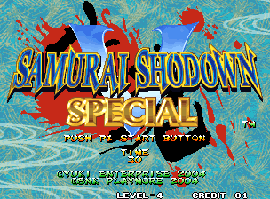

Samurai Shodown 5 Special title screen using Neo-Geo MVS Asia/Europe ver. 6 (1 slot) bios

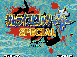

Samurai Shodown 5 Special title screen using Neo-geo AES Japan bios
I don't patch anything but just using different Neo-Geo bios.

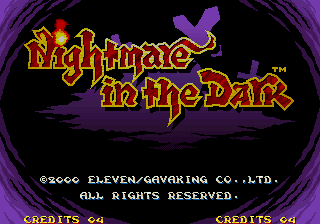

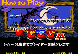

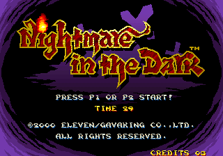

Of course some Neo-Geo Games are only MVS Release (so wee need to use an emulation trick to make them running in AES mode). But all AES datas seems to be present in the ROM.
nitd MVS Mode:
nitd AES mode using emulation:

Samurai Shodown 5 Special title screen using MVS Asia/Europe ver. 6 (1 slot) bios
Samurai Shodown 5 Special title screen using AES Japan) bios

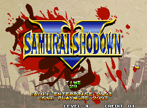

Yes but the removal of the Yuki Enterprise and writting perfect on the title screen is done by a patch.
Here's a picture of the tittle screen when playing the game on PC using the collection:

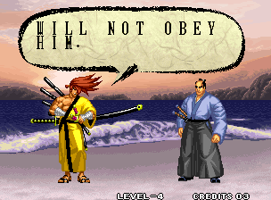

Just played now in AES English mode and the text was there during fight scenes.
Including options and training menu.

None because for it to work on FBA or MAME we need to encrypt the C roms back which is not possible at the moment.
Or, we can try to talk to mame devs to remove the decryption for this rom, still it will take a while for emulators.
MISTER and the Multi require decrypted roms that's why it works.
EDIT: By the way, it seems the game never was called Samurai Shodown 5 Perfect but still named 5 Special.
It seems the new name was given during the making of this collection.
That title screen you see is the correct one, the one in the collection is just a makeover.
Not agree with you. We could easily make a driver to run samsho5pfe even if it is using decrypted Cx ROMs, M1 decrypted ROM, Vx decrypted ROM and S1 ROM. (of course if we have the rom for testing purpose).
See Samurai Shodown V ◦ サムライスピリッツ零 (hack of XBOX version) [samsho5x]
This set is using decrypted ROMs :
Also we have great devs who are probaly able to make some code to encrypt the CX ROMs like they have to be (if not already done...)
I think this is the best thing to do. Its a waste of time to try and encrypt these decrypted roms just so you can use the existing samsh5sp driver.
