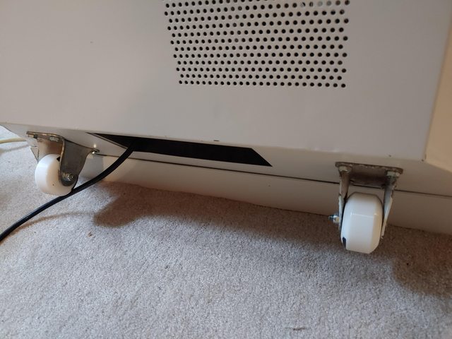

Also took a page out of a book I saw elsewhere on this forum and replaced the poorly spray painted/chewed wheels with some Skateboard wheels
smallest they had were 52s, but with a little sanding on the side they role pretty smoothly.
conveniently enough, the stock axle perfectly fits the bearings I bought (spitfire cheapshot)

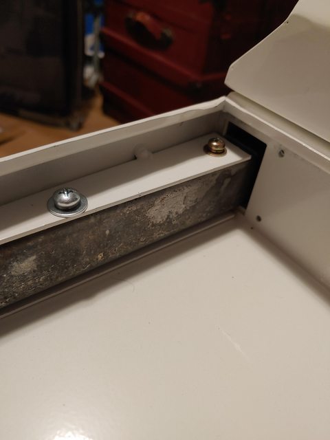

As for the hardware, I am still missing the screws/bolts that hold the top plexi marquee in place. Then the brass colored arm that holds the control panel box in place, there are two screws that hold it down. I am missing one of those. Think they were mentioned to me somewhere on this forum at some point but can't find them.
I can provide pics of anything you want for comparison and ideas.

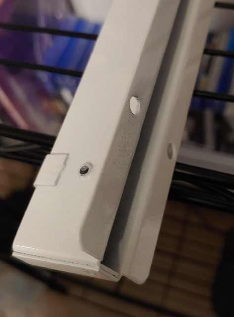

You mean this piece, right?
both the top screws that hold the thing to the topper as well as the two internal screws that secure the marquee holder are M4 size.
the ones go through look to be about 15mm long (manual says 20mm?), while the external ones are 6mm long

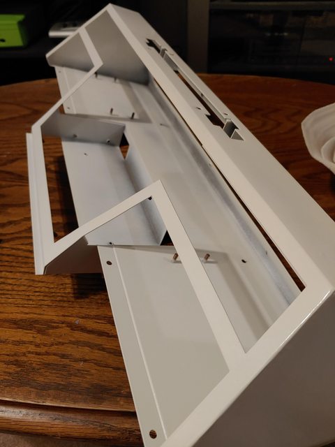

is this the arm piece you're missing?
I can't much say what to do about the actual piece, except maybe Yaton? he had several parts I was missing.
the screws though, M5 size (according to the manual, I can't remember what I bought but I'd happily check for you), I think I went with 10mm length, but that was more than enough.
Original screws use a split lock and a fender washer as well, so I did the same.

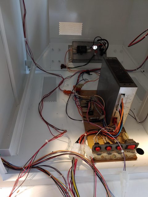

and some basic pics of my wiring-
Also took a page out of another restore thread, took my thoroughly chunked wheels off and replaced them with some Skateboard wheels.
Conveniently, the standard bearings are the same size for the stock axle. I grabbed the smallest size they had (52mm) but I still had to sand down the sides to get them fitting well.

spent some time today tidying up the wiring, starting to look pretty nice
sadly some of the cable cinches I had weren't wanting to stick to the wall, so I went out and bought some Gorilla tape, that did the trick.
as part of the sandblasting process, the twist ties lost their little rubberized coating.
So as a test, I threw some heat shrink over them and that came out pretty darned nice.

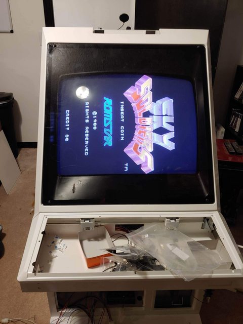

Finally, I worked on dialing in the monitor, she's looking good-

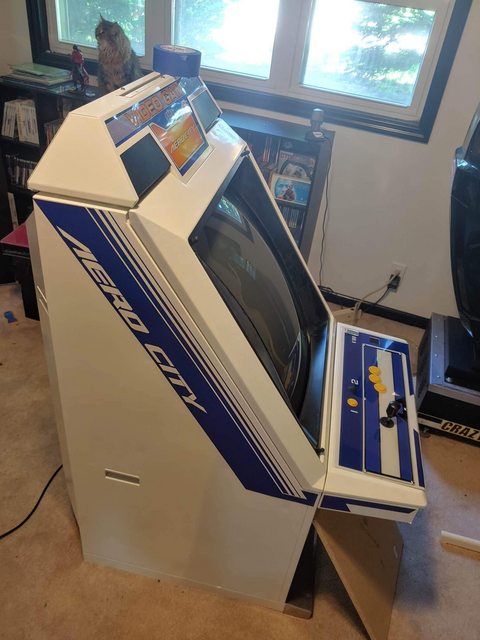

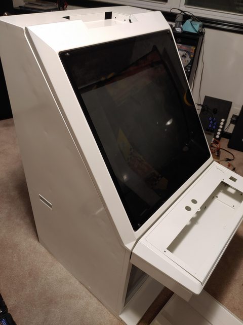

Okay, got everything back from the powder coater today, came out real nice-
Now begins the task of reassembly and rewiring.

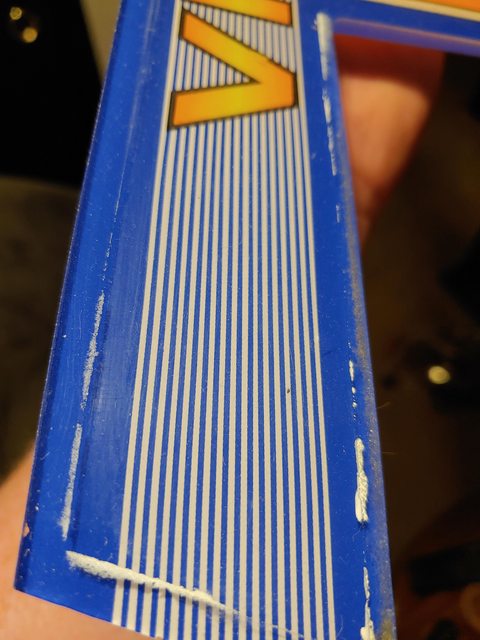

Next up, I need to get the overspray off of the marquee, any tips?
Would citristrip be a good try, or is there something better?
Mine looked like that as well. I used soap and water to clean the front and gently wiped the transfilm on the back to remove the browning. Instead of polish, I applied a thin coat of White lithium grease and rubbed lightly with a dry cotton cloth.
I think they turned out near perfect:
That shit is looking hot! Props on the 3 buttons control panel. Looks nice. I wanted an og panel replicated but it wasn't feasible for such a small run.

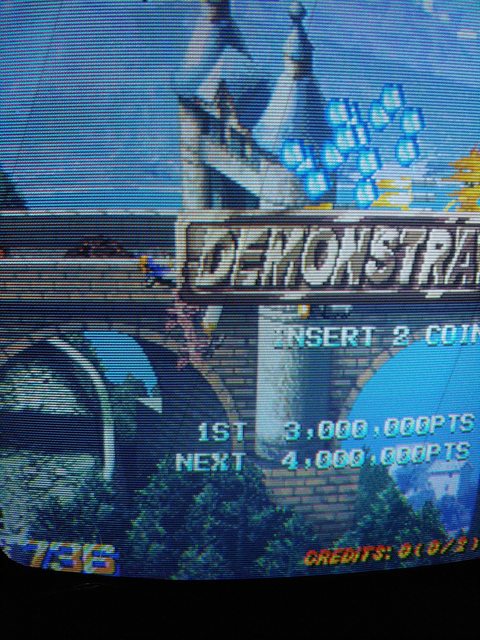

Continuing my work, I'm trying to get the h and v sizes dialed in. The vertical was no problem, but I can't get any actual adjustments to stick with the h size.
The h hold and I phase adjustments seem to do the same thing, and I can't get any changes to come from the width coil either.
Granted, I've never adjusted that before.
I bought one of those plastic adjustment tool sets, but I don't feel anything inside the coil turn. Best I can get it this outer piece with the hex socket
Any clues?

Have you tried switching positions on that jumper between N and W (narrow and wide)
Yeah, and its almost right in the wide position.
But still, the actual adjustment does nothing, which is concerning
