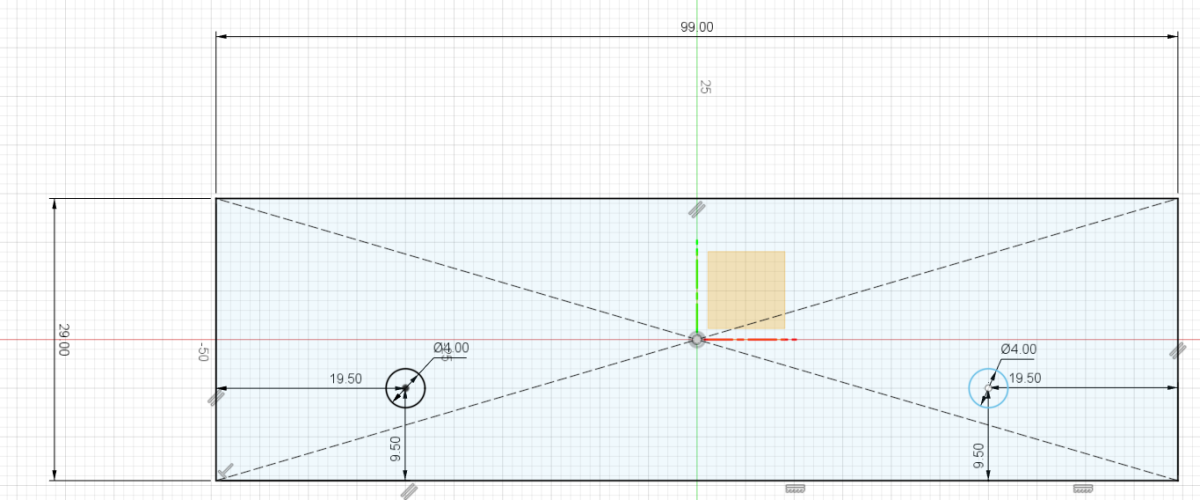

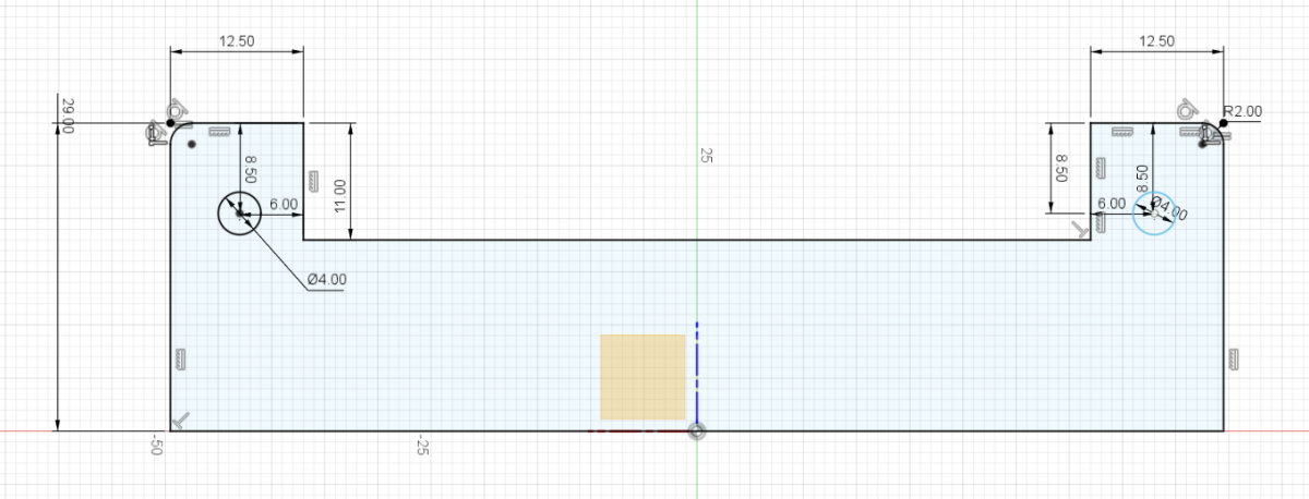

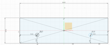

Sure, the base is 99mm X 29mm
The top is 99mm X 34mm high at the "ears" and the dip is 18mm high
Each ear is 12.5mm wide, and the dip is 74mm wide
The top mounting holes are 6mm away from the inner gap and 8.5mm away from the top
The mounting holes in the base are 19.5mm away from the sides and 9.5mm away from the front
thanks!!, I think everything looks right. I measured the screw hole, I got 3.25mm so I made the hole 4mm. Also i dont know the thickness.
I worked on this quick at lunch, ill post the finalized file once you think it looks right.

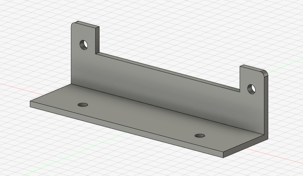

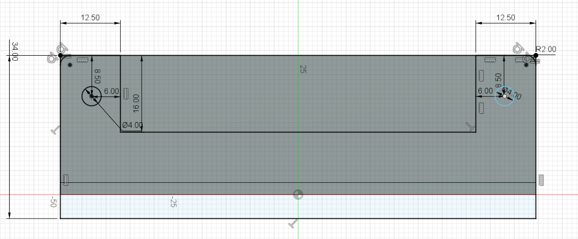

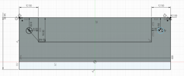

Close, but a couple errors with the ears-
The total height is 34mm, not 29mm
This means the dip down on the ears (where your image reads 11mm) should be a difference of 16mm
As to the thickness, its not quite as thick as the 16GA steel I used for the homemade one, and measures just under 2mm thick
That looks right to me.
Now, I do have some concerns about the amount of force that gets applied to the bracket during insertion.
What maybe for the sake of 3d printing the bend should be reinforced?
It could be made a little bit thicker since the plastic part of the harness will not be in the way.
I can always put a metal file up too, for someone that wants to get it cut and bent.

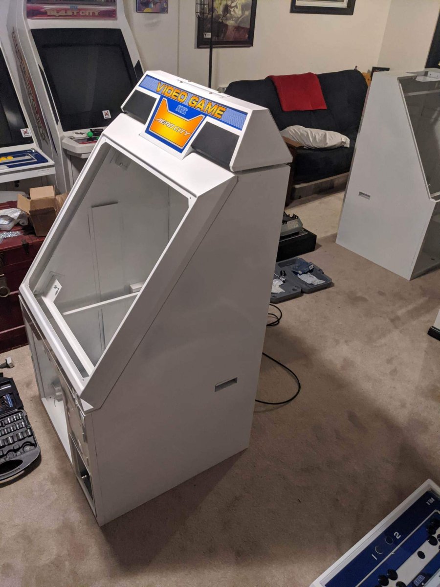

Alright, I've got the bodies back and the reconstruction has begun!

Started by attaching the basics, topper, bezel, etc.-
And screwed in the handmade bracket I made, fits pretty dang well!
In that picture you can see that I also went ahead and resleeved the built in tie downs. My strategy was just heat shrink cut to length and warmed up with a lighter.

Much work has been done, here's their current status-
All in all I was able to find the stock wiring routing via opt2not's thread on Aeros so shout outs to him
Mounted up the monitors and they work just like they did on my bench-
So all that's left now is to source a coin door, apply the art and stickers, and drop in the bezel and glass.
