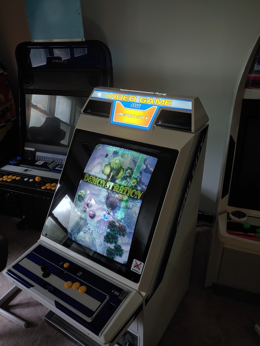

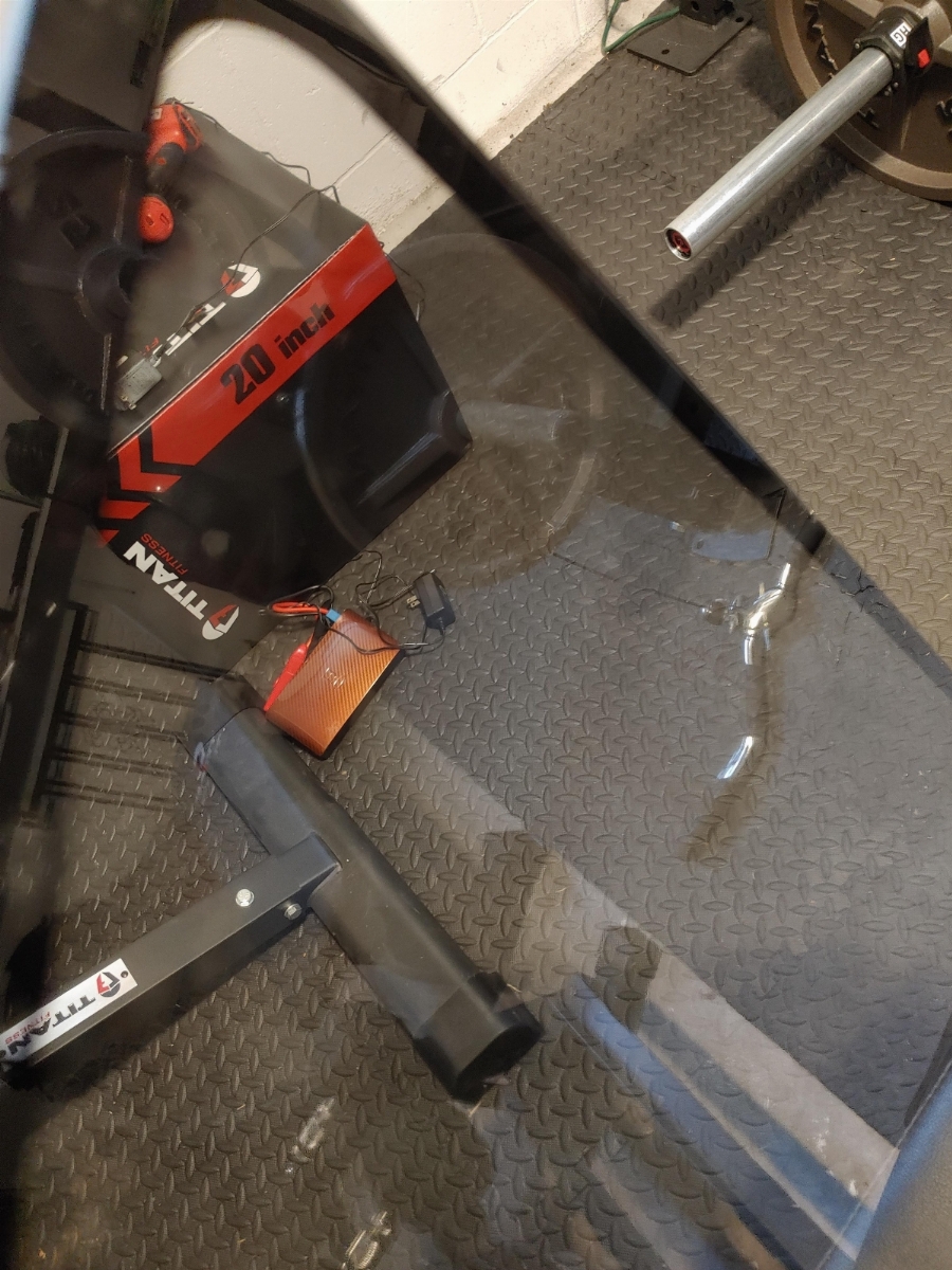

Well as of today I've got the glass scratches sanded out and polished.
Its not perfect, But the sanding made it quite a bit better than the big "SP" that was scratched in-
Getting the glass mounted in right was a monumental pain in the ass, I'm never rotating this monitor ever again lol.
I'd rather rotate a blast than deal with the glass again.
But hey, it's on and looks good!
Now all that's left is to get the locks/keys/tangs sorted and the light I ordered 2 months ago from Yaton to show up

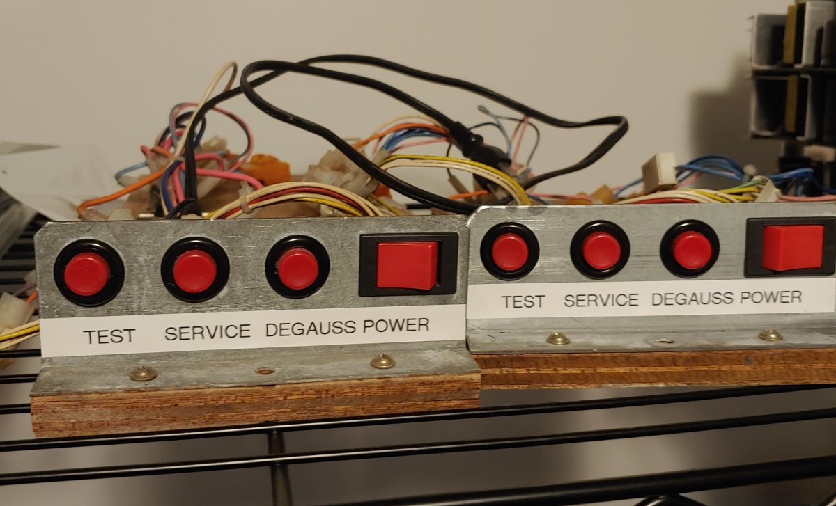

I'm waiting on my buddy to test weld to see if I need to hire a shop or not to fix the lock bar holes but while I do ive cleaned all the wiring and polished up the marquees and sanded/cleaned the non painted metals
Then comes the electrical work.

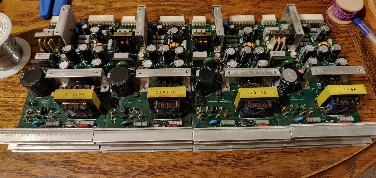

Recapped and redid the thermal paste on all 4 power supplies I was given.
I'm also recapping/rebuilding the monitor chassis, but they ended up having slightly different caps so I'm stuck atm
Last note- the labels on 2 of my PSU assemblies were trashed so I printed up some English ones with my label maker
