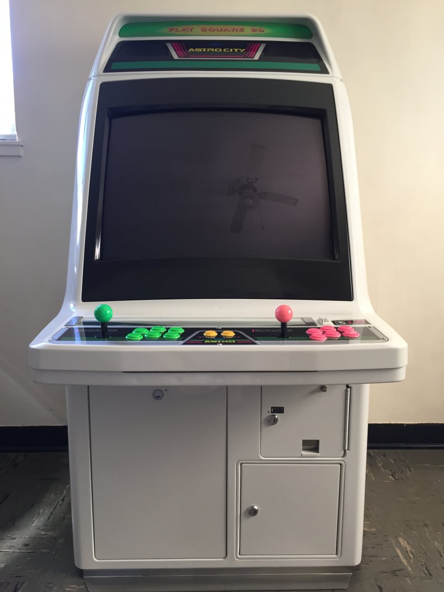

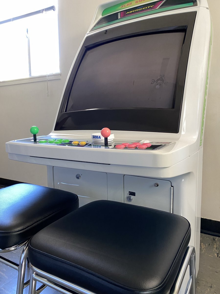

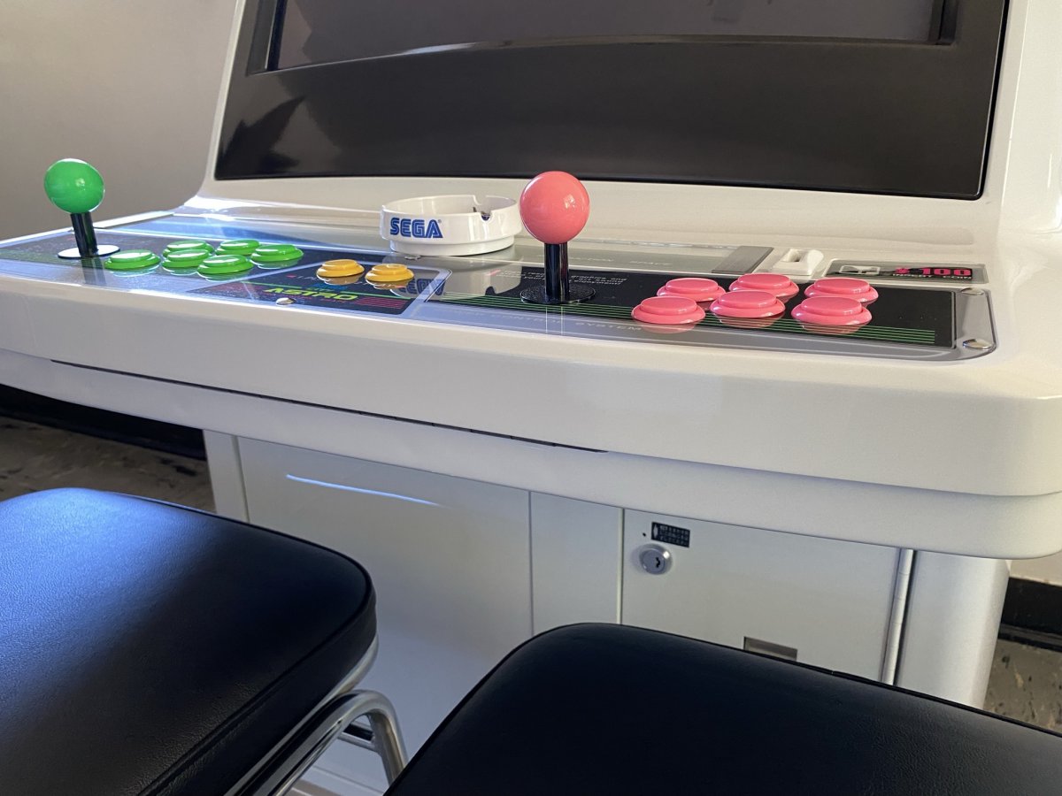

Sega Astro City - Restored

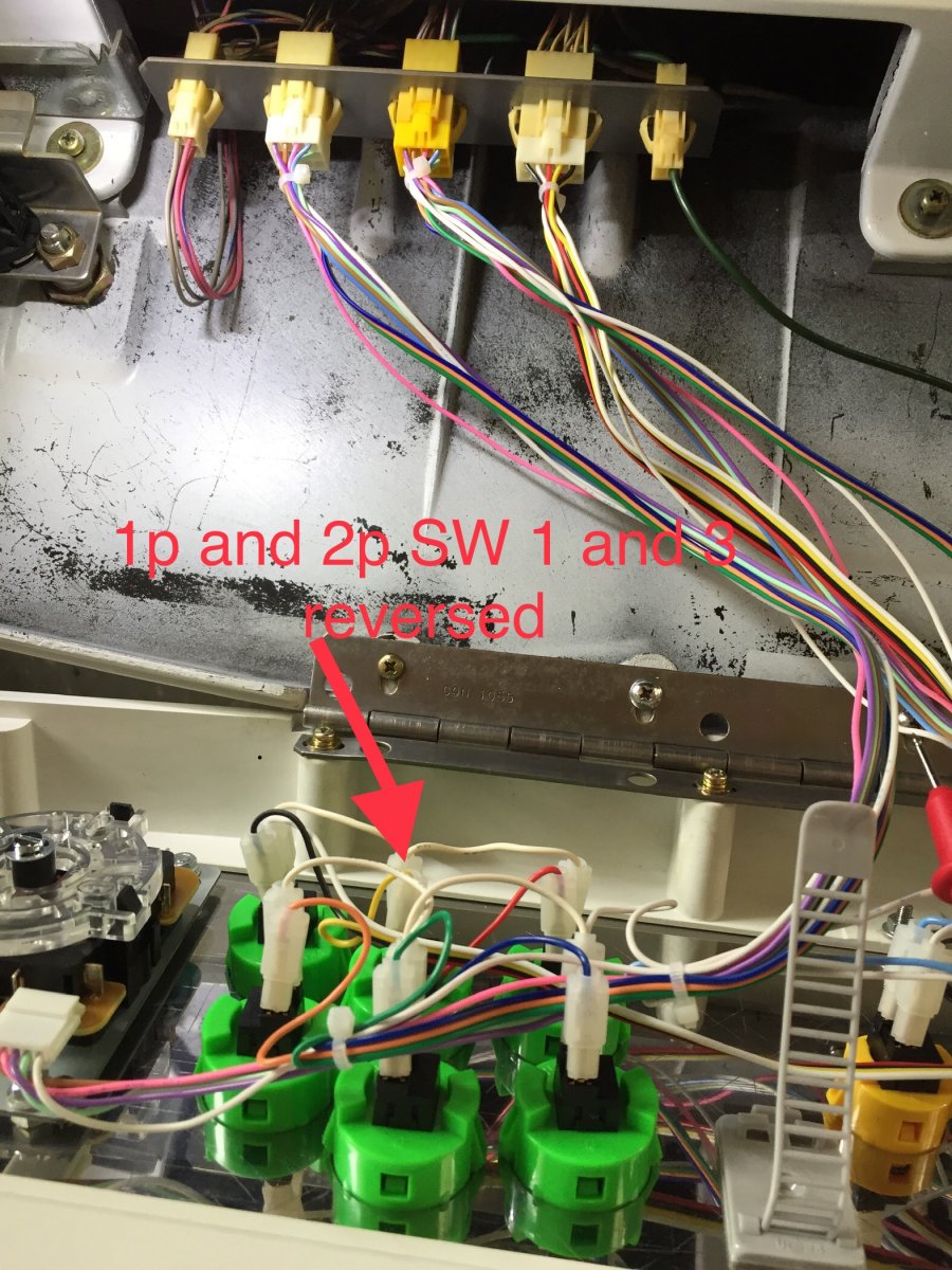

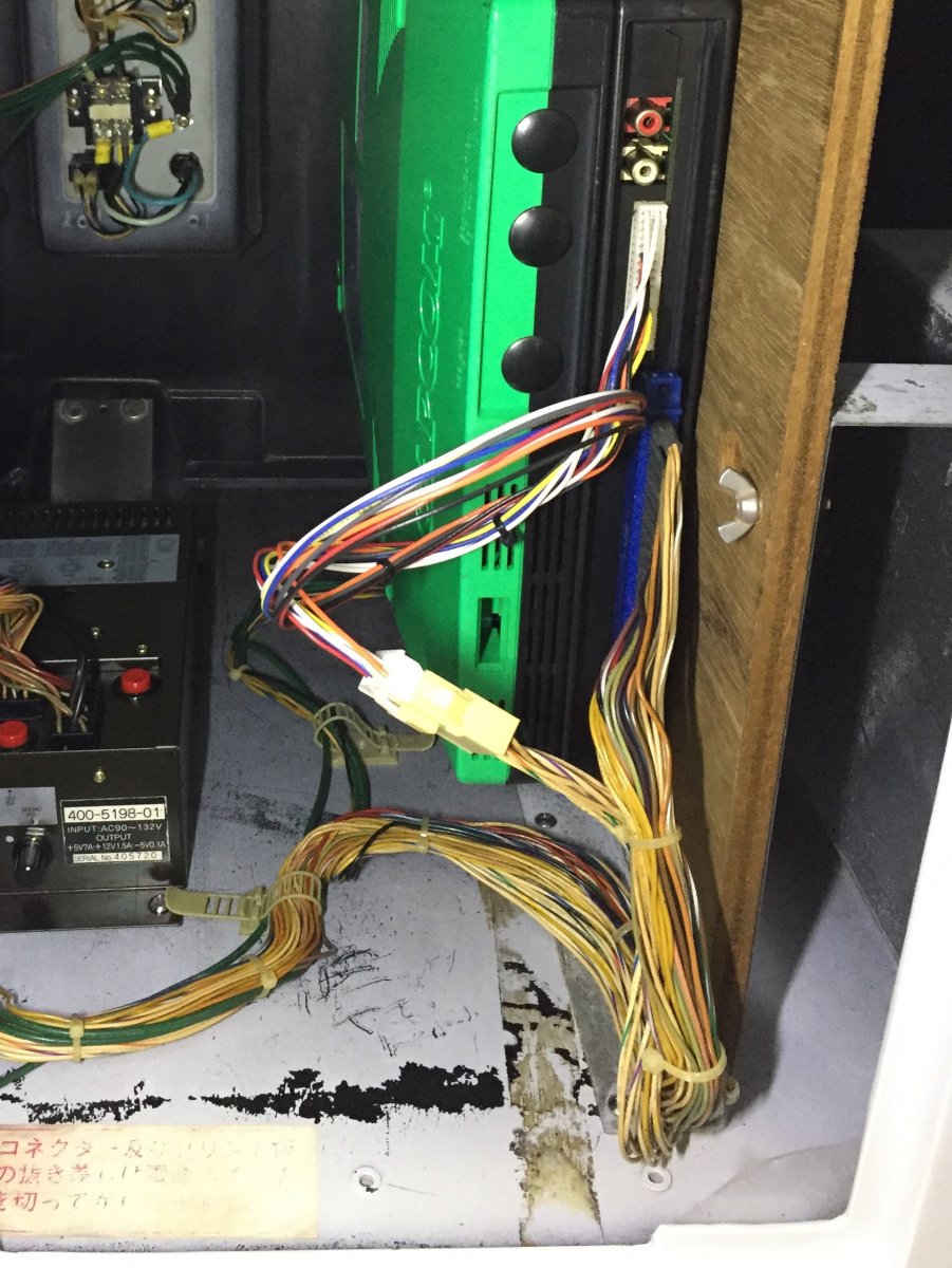

Wiring
The JAMMA harness was in good order already so I only needed to figure how to route everything properly. It was all very filthy and here I did apply the ubiquitous Simple Green and water for cleaning.
Two wires are crimped together. Not sure what that is. Doesn't look like fuses are in there.
I also don't know what the black bendy thing is screwed to the top of the power supply unit. I'm using it to tie down the female AC cable. The manual shows a 300W outlet on the side of the PSU to be used while doing maintenance and with the PSU turned off. My unit doesn't have this so I'll assume that's what the cable is.
When changing to a 3-prong grounded power cable, be sure to use 16 gauge. I used a 14 gauge cable and had to shave down the rubber grommet then barely was able to force it through the hole with pliers.
CPS2 extra button "kick" harness from Lemony Vengeance.

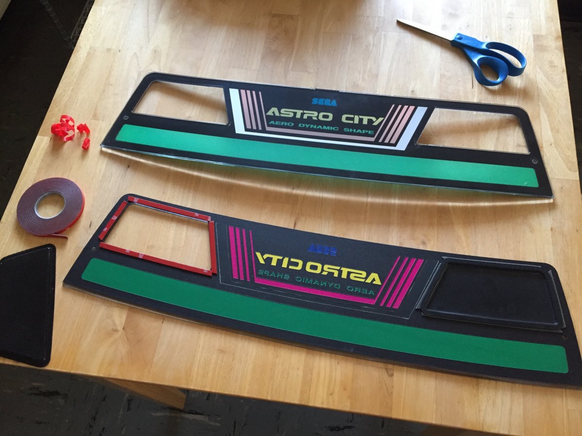

Billboard Lower (A.K.A. marquee)
This is a reproduction made by Rbtamanini from this forum. The construction is solid and the shape and size are perfect. The colors look great too although I can't find a photograph from the 1990s of an Astro City so I still don't know what the original colors looked like exactly. The colors on the advertisements look like they were altered and aren't the true colors. Regardless, I like how this reproduction looks and the colors look nice when lit.
One problem. Three actually. Compared to the original, the "Astro City" spacing is off. Plus the "Aero Dynamic Shape" font is wrong. And if we want to be EXTRA picky... the original letters are embossed while the reproduction letters are not.
All of that would be a deal-breaker for many. I think It would be for me if I did a comparison first. I still have the original and can switch back to it later if I'm bothered by the lettering. I didn't notice any differences until I compared side by side. And even while comparing side by side I somehow still didn't see the spacing problem until it was pointed out to me by Aurich.
It's possible that the spacing and font issues will be corrected (thanks to Aurich) if you order one of these billboards now. More on that here: https://www.arcade-projects.com/threads/repro-sega-snk-and-taito-panels.12276/post-287597
If you do order one and if you're lucky, you might receive some adhesive tape to affix your new billboard. Otherwise you need some strong double-sided adhesive tape that is about 1/4 inch (6mm) wide. I used 3M Exterior Attachment Tape from an automotive parts store.
Tip: be sure to remove all of the old adhesive (soaking with Goof Off then scraping with a plastic spudger works well) and apply touch-up paint (if needed) BEFORE putting on the new billboard. If you don't there may be some visible black spots at the bottom.
The two bolts on the front of the billboard were rusted and my vinegar soak made them shiny silver. I assume they were originally painted black so I sprayed them with Rust-Oleum enamel.

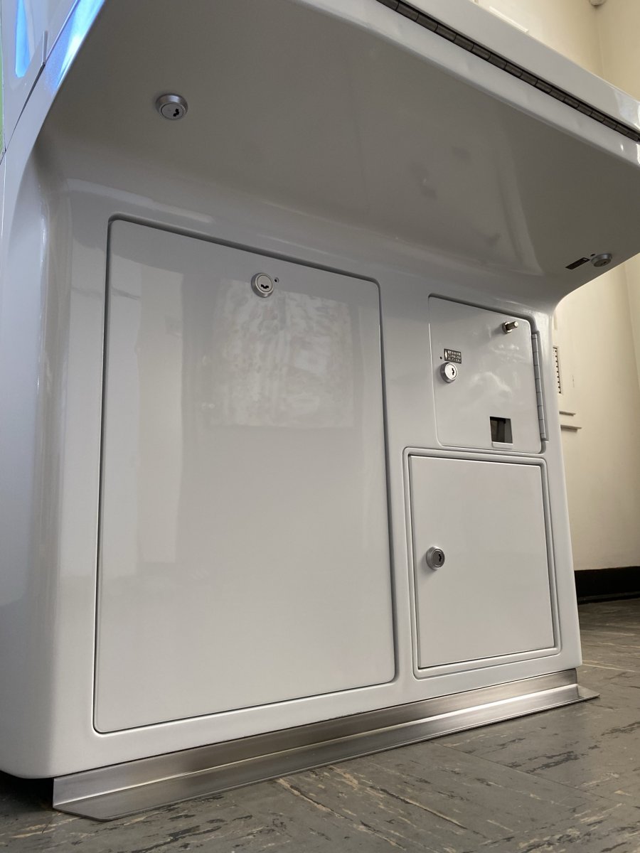

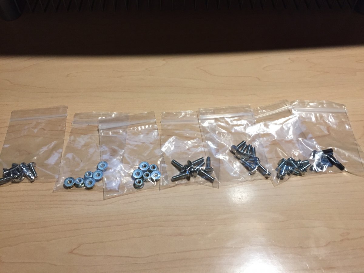

The cabinet was missing screws in the back, some control panel overlay bolts, plus one of the nuts that secures the monitor. All I could find locally was the nut. Everything else I needed to order from arcadeartshop.com. $45 shipped is a lot to pay for a few bags of hardware but I couldn't find these sizes anywhere. However, the screws that attach to the light cover in the back insert into fiberglass so I could have used any length screw with slightly larger sized imperial diameter. Two holes were stripped back there so I had to use some different screws I found in a drawer anyway along with some wood glue and matchsticks to get a tight fit.
Added Scotch 1" heavy duty felt pads to the feet to prevent scratching my asbestos flooring.
Added grease to the wheel axles before putting them back together.

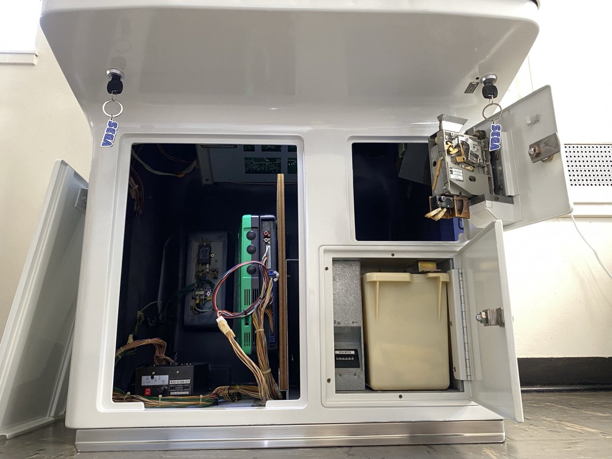

Locks are from yatonarcade.com. I read some negative comments about yatonarcade so I'll mention that my locks arrived in about three weeks in good, clean, and working condition.
I'm unable to determine what the 6th tongue is for. And it's odd that this type of tongue is for the cash box door but there's nothing for it to latch onto (it looks like it should latch something). The keys I ordered from Zax Amusements.
I'm curious to know why locks and keys are removed from these cabinets and where they go. I'll assume KC Arcade doesn't know. I think yatonarcade is in China but the return address for my locks is a PO Box with the same zip code as KC Arcade. I'll assume that's a coincidence.
Putting the two halves of the cabinet back together is as difficult as taking them apart. The screws are difficult to turn and I had trouble getting everything to line up. Laying the cabinet on its back, then loosening and tightening screws a few times around the back and sides plus the bolts in the back while trying to squeeze it all together worked eventually.
I still have some gaps that I couldn't get rid of. One is between the control panel base and the upper front half. They don't line up perfectly. But the Astro City shown in the old advertisement flyers appears to have this as well so I can ignore it. The other is where the front panel connects with the rear half of the cabinet, both sides.
If I tighten the cash box door hinge fully, the door won't open enough to pull the coin bin out. I couldn't figure out why so my fix was to stick newspaper alongside the screws, then drive the screws in to get a snug fit and be able to open the door enough.
I don't have any tips for putting the monitor back in place other than wear gloves and ask for help. I did it alone and it's a bit of a challenge. Having long arms helps.
I noticed that the monitor frame has a spot to mount the adjustment knobs, but then they would be blocked by the monitor mask/bezel. Maybe this is for different cabinets that use this monitor.

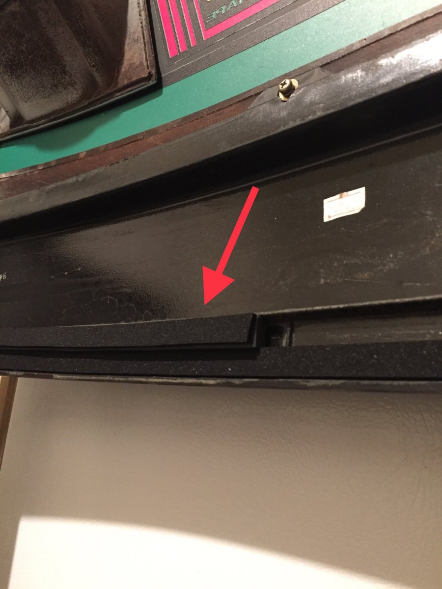

The foam that goes around the inside of the monitor mask needs to barely rise above the edge of the plastic. The correct size to use is 1/8" thick, 1/2" wide. Anything more than an 1/8" thick and the top half of the cabinet won't fit together (I tried).
Once I had everything assembled I then noticed light from the fluorescent lamp leaking from the top and bottom of the monitor mask, the sides of the cabinet, and even at the top of the screen through the CRT glass. This is all very annoying so I employed layers of 3/8" thick and 1/8" thick (both 1/2" wide) weather stripping to block out all light while making sure the front panel and monitor mask still fit together properly. This took longer than expected and I still have a very small leak on the sides of the cabinet near the fluorescent lamp but I can ignore it.
I threw some unused money in the bottom of the coin bin directly under the coin chute exit to guarantee that subtle but wonderful sound of coins colliding with every coin drop.
Left over hardware. Hate when that happens. The ring looks like it's part of the coin mechanism but I can't see where it would go. The two screws look like part of the monitor chassis maybe.
The manual shows a "spacer" under the right side control panel base lock tongue. I don't have this and it doesn't seem to affect anything but I'm still curious what it's for. I'm also curious about the metal cable tie thing on the inside of the coin mechanism door.

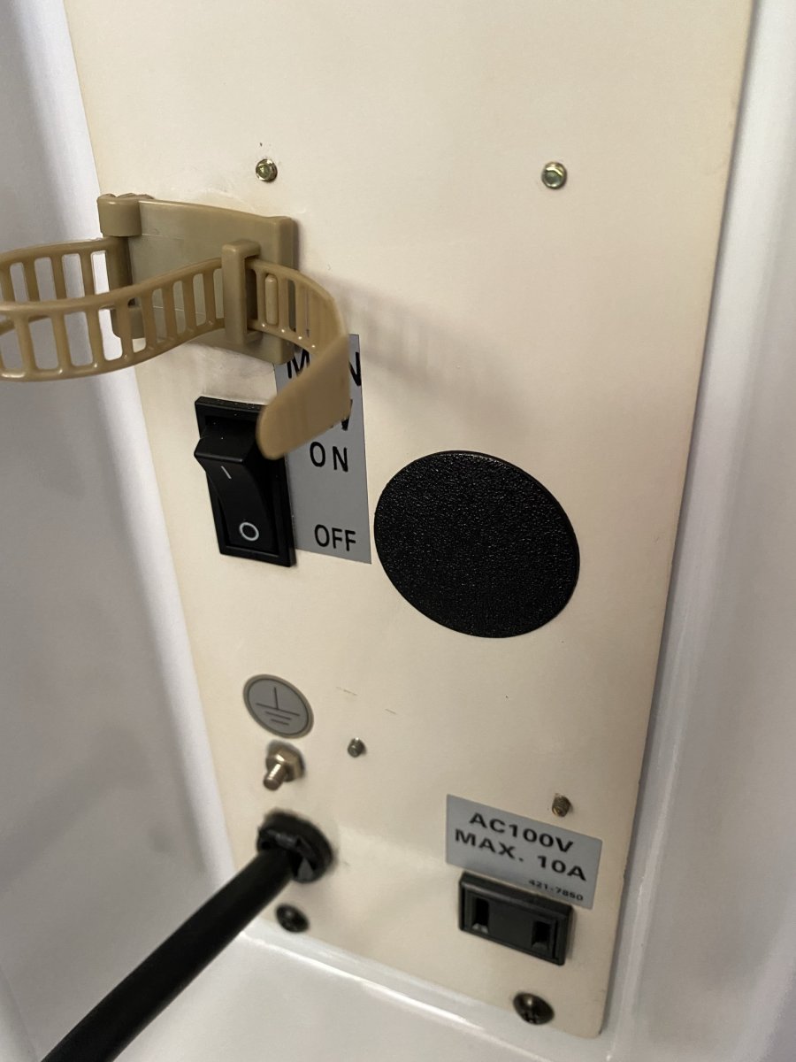

The mysterious hole on the AC panel is identified as "CAP SW 30". I covered it with a... 30mm switch (button) cap.
So much goodness in this thread, hundreds of hours of work and experience. Thank you very much for writing this up and sharing it here.

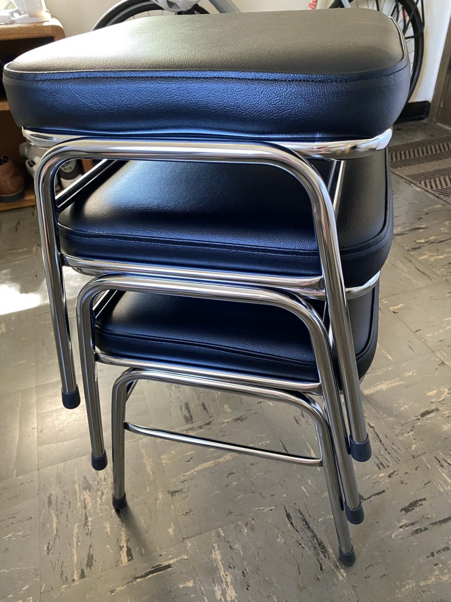

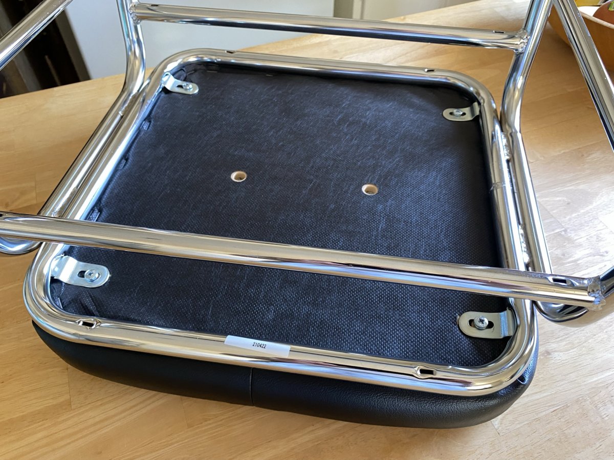

Stools:
My Taito 43cm stools arrived with water and rust spots, plus a little damage. Bummer. I was looking forward to something new and in perfect condition but again needed to pull out the Barkeeper's Friend. Anyway, these are great stools. Look super sharp and are comfy.
I'm a little disappointed that a Taito logo is nowhere to be found on these. No identification at all. For the price I paid I want a Taito stamp somewhere to show people how hype my arcade gear is.

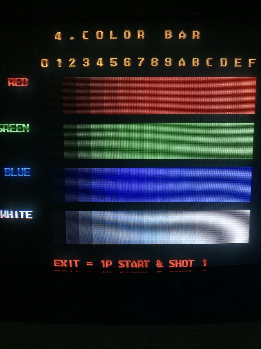

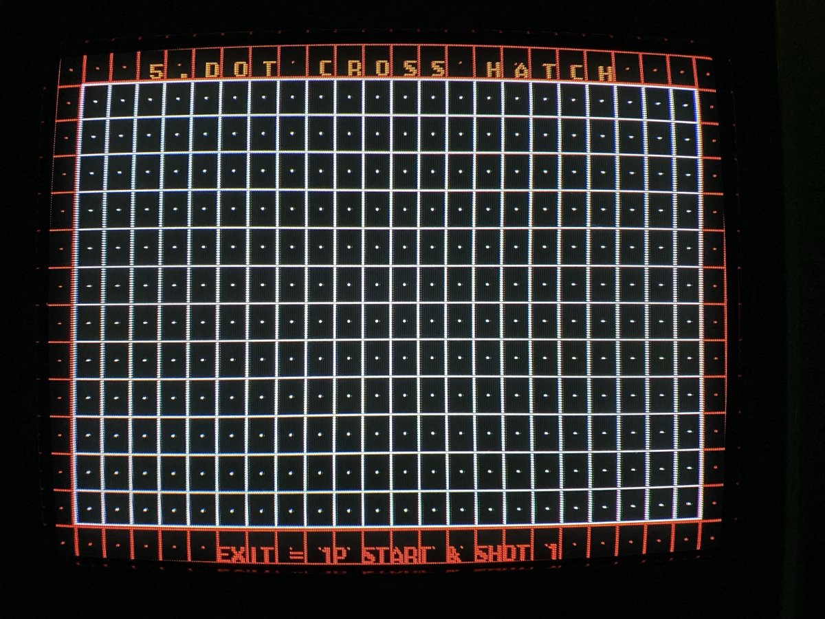

Monitor calibration can be as complicated or as simple as you want. I like to spend some time tuning to make the image quality as best I can without getting too extreme about it. Here's what I did:
I first turned down the Screen knob on the flyback just a tiny bit for the reason I stated in an earlier post. I still get some noise when powering on the cabinet that fades after a minute or less. I don't know if it's the flyback squealing or some other component but I do know that increasing the Screen value increases the noise. So I want to keep it low. I think it's best to make other adjustments first before boosting the Screen knob. And I think higher brightness or contrast on a CRT monitor can lessen the life of the tube. Maybe.
I then adjusted the geometry as best as I could. V.LIN is in a very inconvenient place and almost inaccessible with the cabinet fully assembled. But it is possible to squeeze your arm back there. There is some danger involved. A plastic screwdriver is a good idea. My test grid was looking better after the V.LIN adjustment but still needs more tweaks. Unfortunately this monitor doesn't have enough fine tuning options to improve the geometry any further. Which is okay because I could spend all day making little adjustments and not really improve anything if there were more tuning options.
Final setting:
Next, the colors. I first set Bright so that the background was deep black and the boxes under the 1 column were barely visible. Then I adjusted Gain for each color so that the gradation on the white row was dark grey to bright white with no tint of any color. Also while doing this I made sure that the boxes under the 1 column remained barely visible, just slightly above black, and the boxes under columns E and F remained distinguishable as separate shades. I adjusted the Bright knob as needed. I wasn't able to achieve the desired setting for red so I had to return to the back panel again. R-Bias is in an even more difficult spot than V.LIN. I wonder if these potentiometers are supposed to be accessible with the chassis installed in the cabinet. With a lot of difficulty and risk of electric shock I increased R-Bias, plus G-Bias and B-Bias a little, then returned to the front to set the Gains and Bright again. The SS.SW switch stayed in the A position.
These CPS2 calibration screens look familiar. That's because they are used in the 240p test suite software: http://junkerhq.net/xrgb/index.php?title=240p_test_suite
If you aren't familiar with screen calibration this webpage is a great resource (the software is great too).
