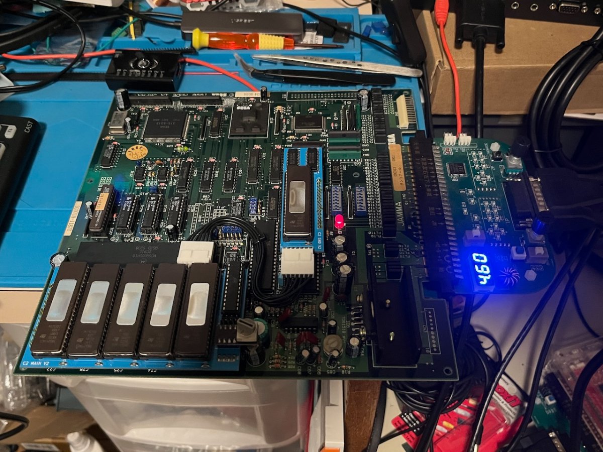

I was just trying to take a better look how C2 PCB in "multi supported" format looks like. Anyway, already found pics elsewhere.

I received the programmed chips from buyicnow.com, and installed into the C2 board today. Everything works fine :)
Had a great game of Thunderforce AC, but set the board to freeplay first, heh, as that game is a drainer (DipSw 1 all set to 'on' in case anyone wondering!).
